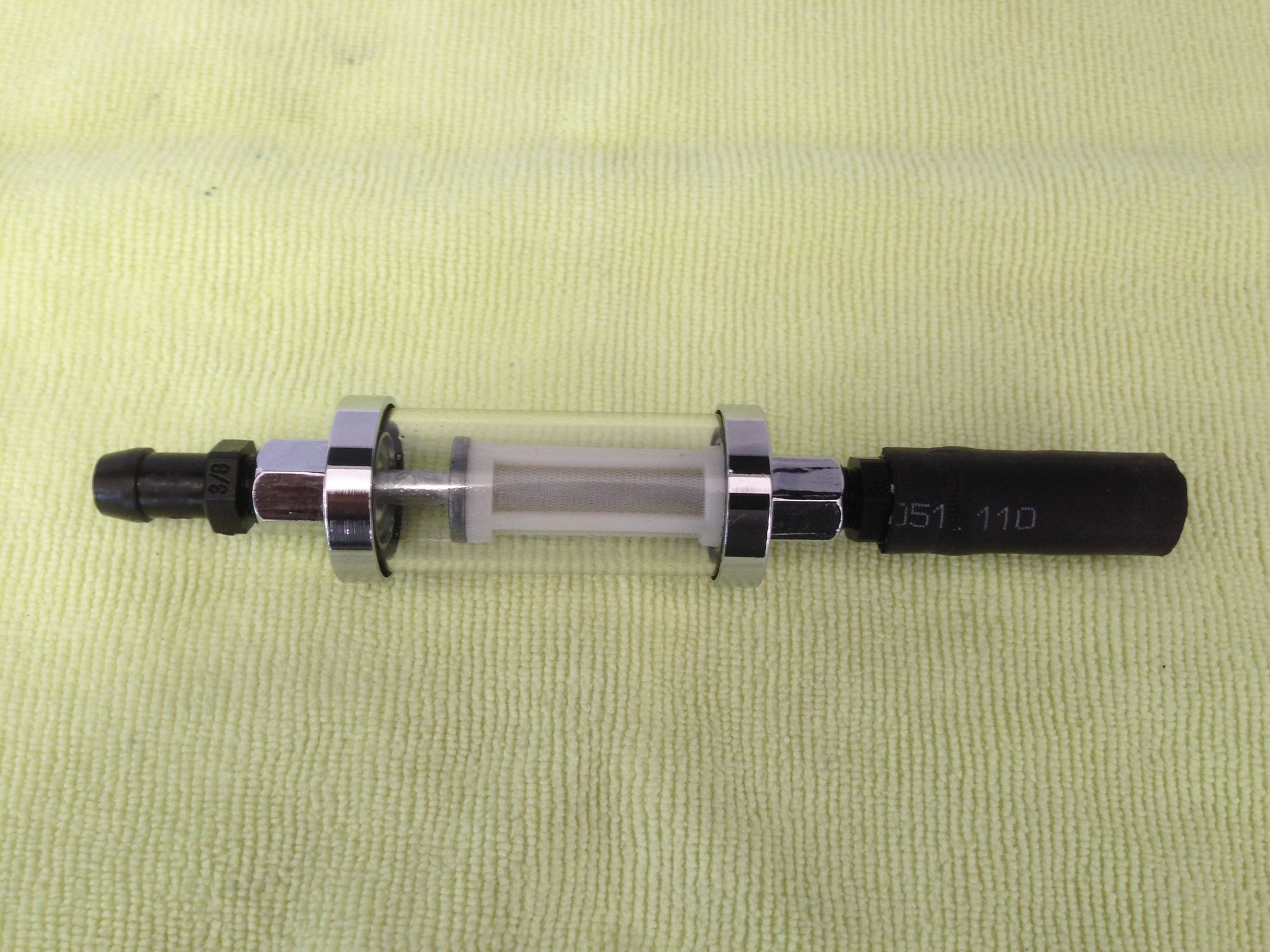

Originally Posted by 7T1vette
Do you have a working PCV system on the car? Does the valve cover with the PCV valve installed have an oil baffle below the valve so that splash oil does not get sucked into the intake??? This is a common problem for many aftermarket valve covers (cheaper to make without the baffles).
I used aftermarket valve covers and even though they had baffles, they didn't work properly. I went from a quart every 600 miles to 6000 miles after replacing them. Below is an easy and inexpensive check that I use. Get one of those cheap glass fuel filters and install it in the pcv line at the carb base. Just pull the line off the carb and install the filter between the line and carburator. There are 60 tablespoons to a quart so if you have a tablespoon in there after 10 miles that would equal a quart every 600 miles just through the PCV. You can unscrew the filter to clean it for future use and it's only about 5 bucks. Kind of a dangerous fuel filter but works great for this. Then you know for sure if, and how much oil you are sucking in through the PCV before looking at valve seals or whatever.
