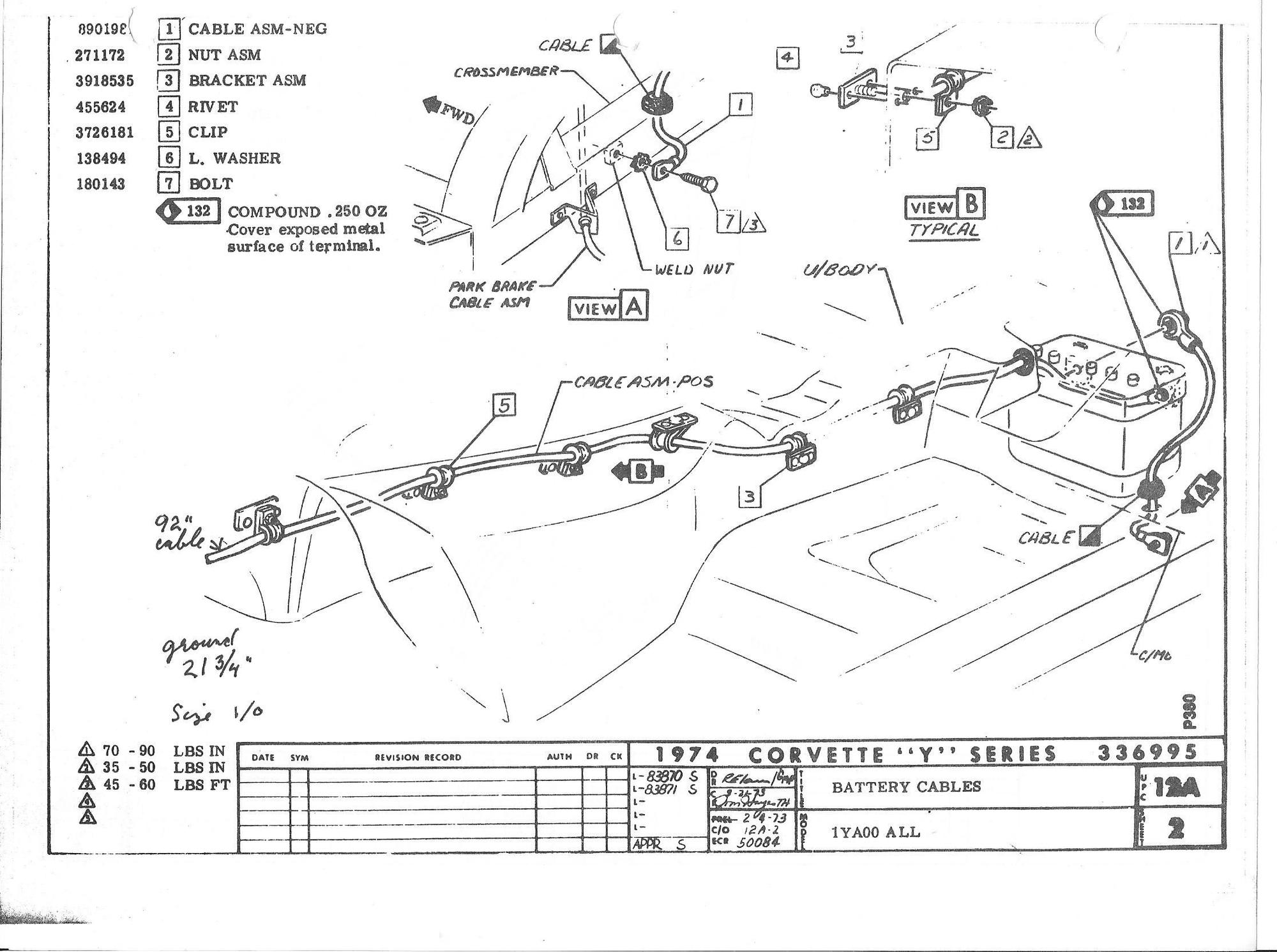

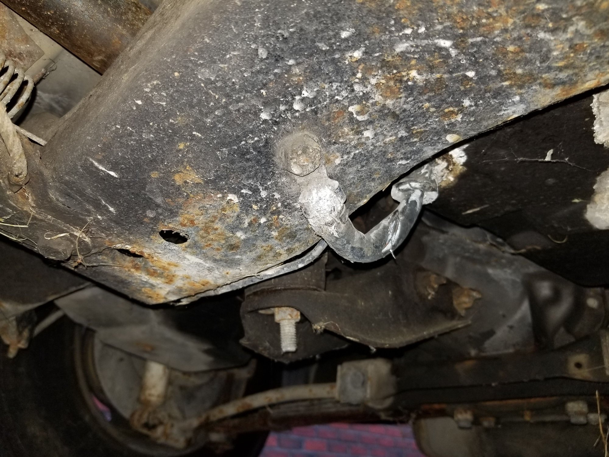

click goes dead. new battery, so i assume good cable connections. the big frame ground straight below battery.
aluminum wire. Cheap copper terminal. Steel frame. Diff metal electrolysis. Don need no salt water to corrode this.

Turned out to be corrosion inside the positive cable. I had to splice that section because I could not find a replacement cable long enough. That will be my next quest. A 7-foot cable.

Check LetricLimited - they carry a high quality cable set. May be available from some of the vendors, too.

All the vendors carry a replacement cable or you can make your own.
