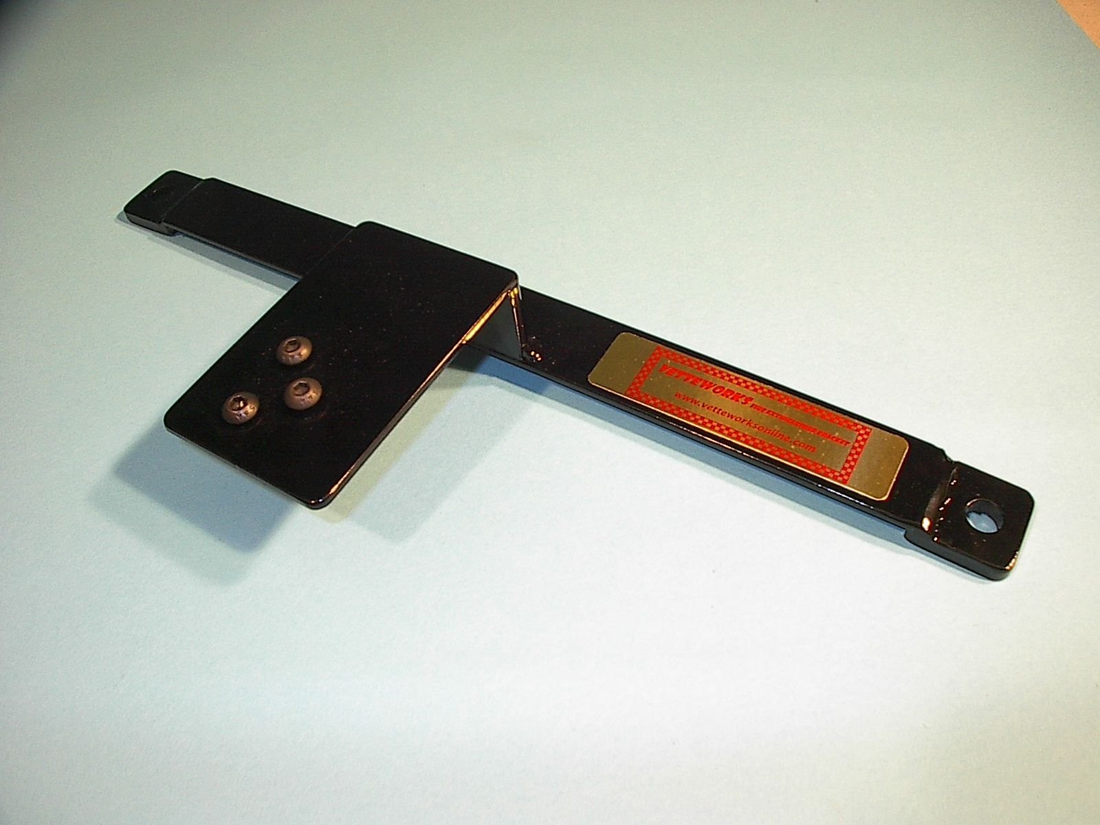

Originally Posted by Dbrummy1@yahoo.com
That’s the standard mounting bracket from Amerex
No, it's a specific bracket for pass. or driver side mounts that they make for C3's. It uses the front seat bolts to attach it to the car. They make other brackets for all the different Corvette generations.
Amerex extinguisher bracket for C3. Vetteworks.
Old Nov 12, 2019 | 07:48 PM
  #42
Dbrummy1@yahoo.com's Avatar
Dbrummy1@yahoo.com
Joined: Aug 2016
Posts: 19
From: Colorado
Nice, the standard amerex bracket bolts to that. That was some nice engineering!

Old post resurredted but Vette Works still makes a really great heavy duty fire extinquisher plate that mounts to the front of the seat rails and sits under the passengers legs out of the way.
