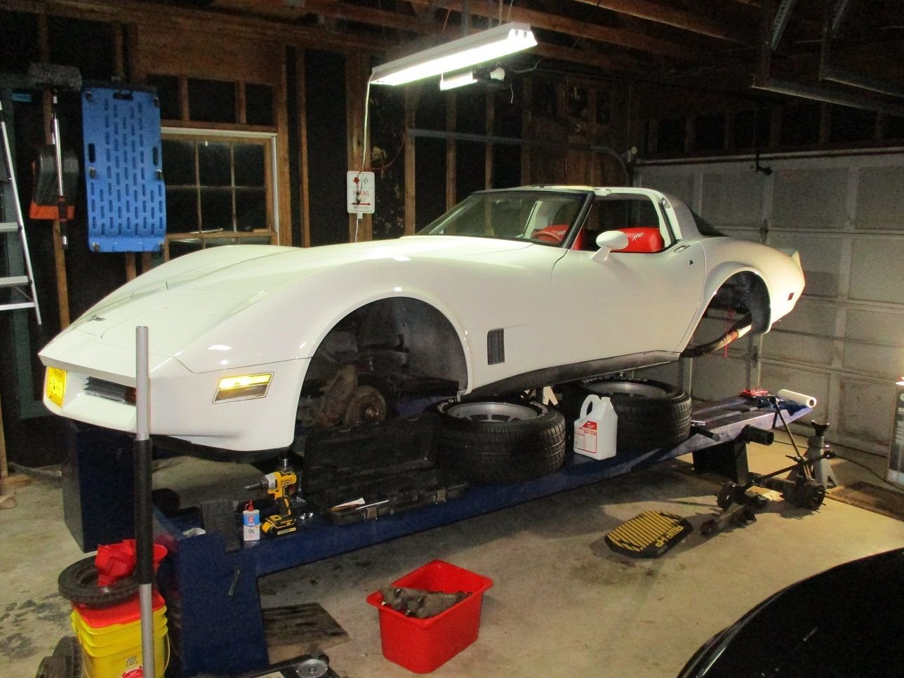

@Bikespace - is that a crossmember on a 4 post lift? I am going to get a 4 poster sometime, looking for ideas for something right along the lines of your pic... wheels off but lifted.
That is a Kwik-Lift, with two additional centerlift bridges. Very useful for a low garage that doesn't have the concrete pour to support a two post lift. Not to derail this thread, though.
