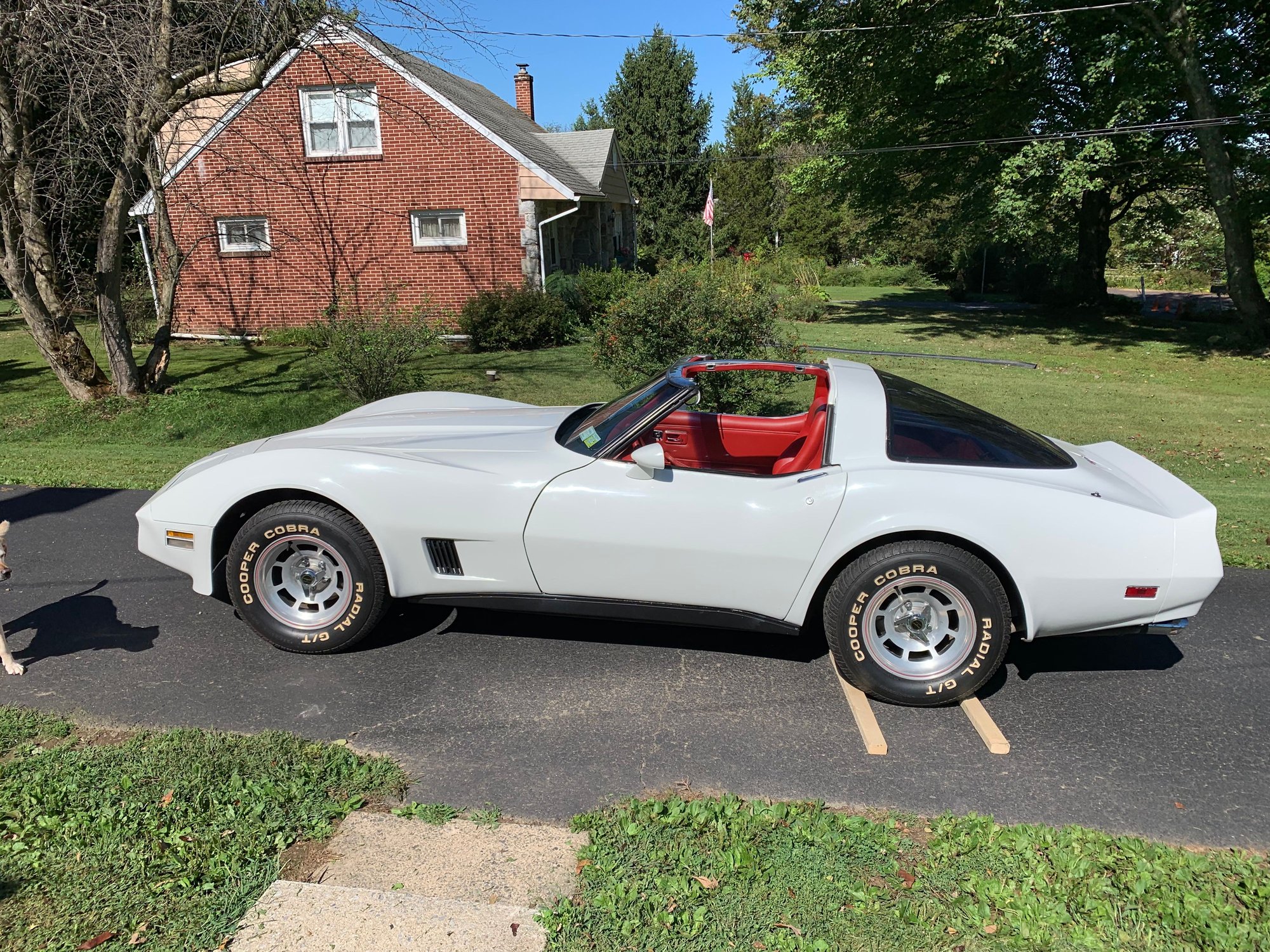

BTW, nice looking 'vette!

Nice car the Pace-car wheels look great.
Post up a picture of the radiator seals!

White on red 80 is just about the perfect Vette, and the best color combination.

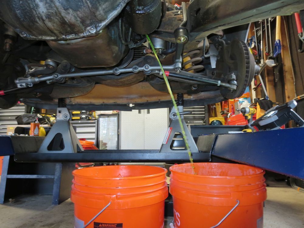

Lot's of good suggestions above, and you should be fine already. If you are going to get the car up on ramps and/or jackstands, you may want to consider pulling the block plugs and flushing the block as well. Otherwise, checking for the spring in the lower radiator hose will probably do it. Do you have any run-on (dieseling) when you shut the car down? That might indicate a timing issue as well.
Here's a picture of draining the block on my car. There was a bunch of rusty crud that came out before the clean-ish antifreeze.

@Bikespace - is that a crossmember on a 4 post lift? I am going to get a 4 poster sometime, looking for ideas for something right along the lines of your pic... wheels off but lifted.
