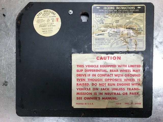

Default wrong side rear compartment loop handle
I discovered the rear jack compartment lid loop handle on my 69 is located on the wrong (right) side of the lock mechanism . I noticed this when I went to place the underside lid decals on and could not fit the jacking instruction decal above the positraction decal without overlapping the hold down nut for the loop handle which would leave the upper left part of decal unattached. Every photo I see of the jack lid underside has the loop handle nut to the left of the lock . What gives? Did previous owner incorrectly install jack lid cover? Any way to correct this? It gets kind of frustrating when you can not even put decals where there supposed to be without running into a problem!!!

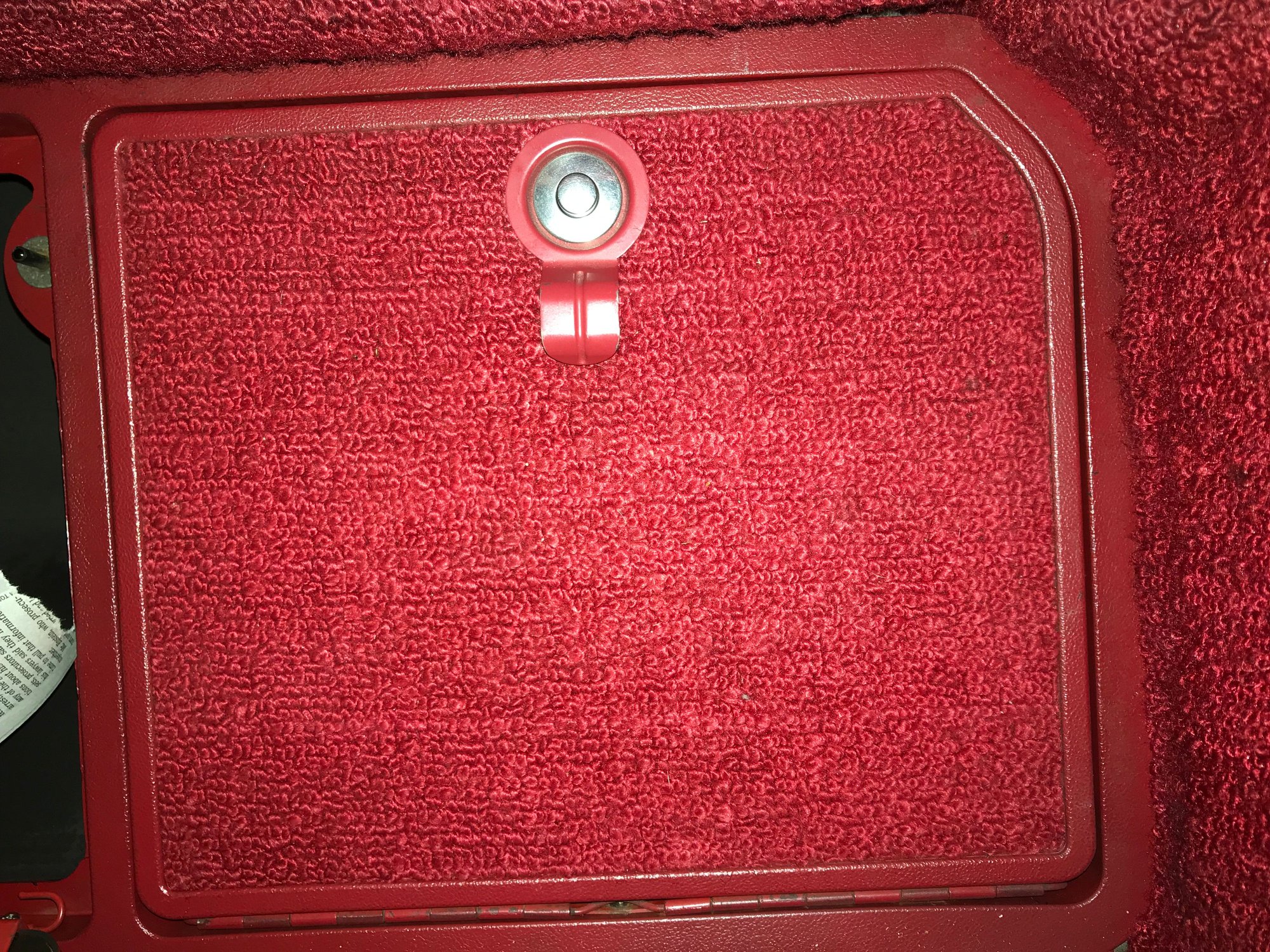

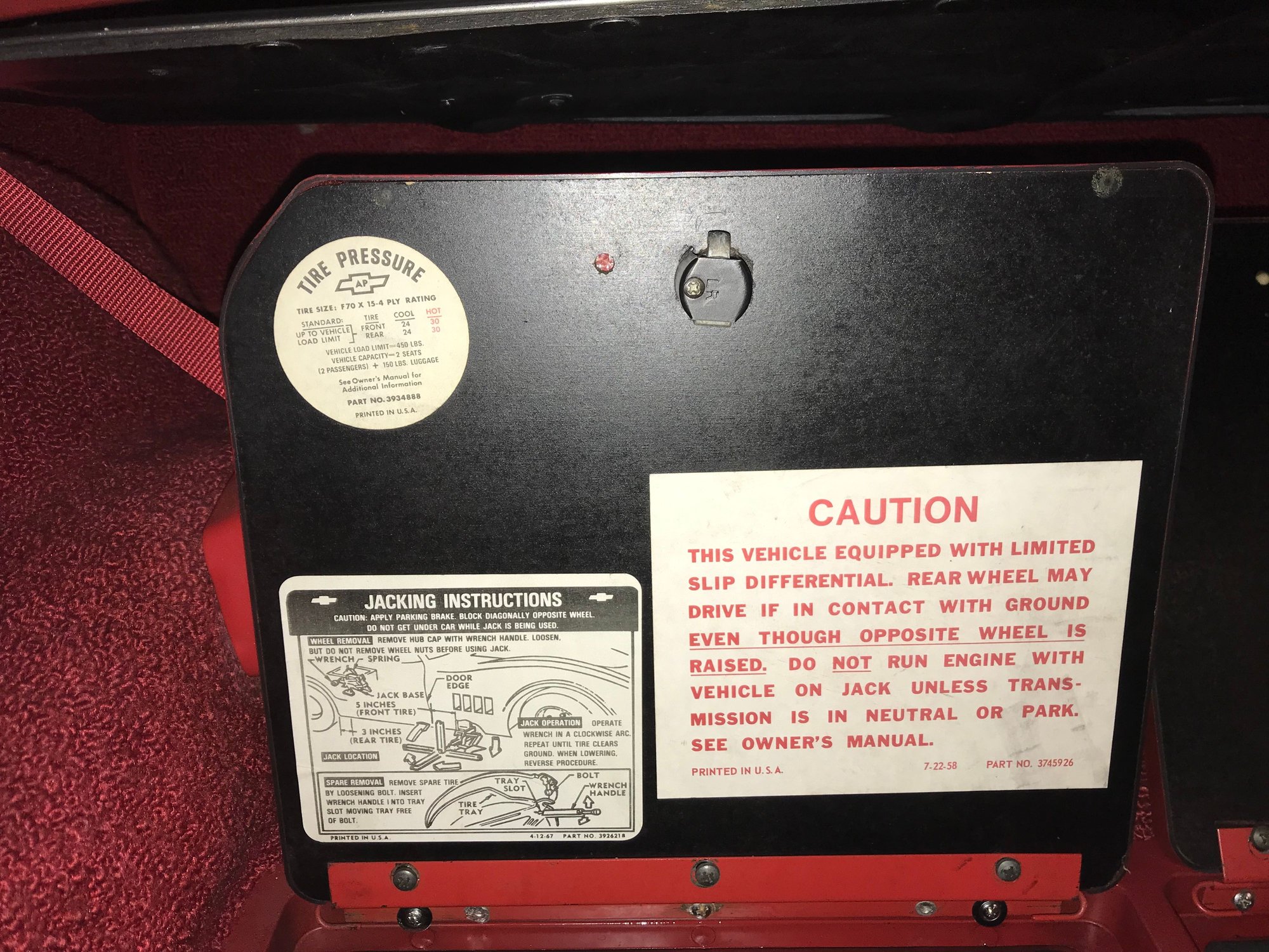

Hello Scott,
I am in the process of doing some work on 1969 storage compartments, glad to help if I can.

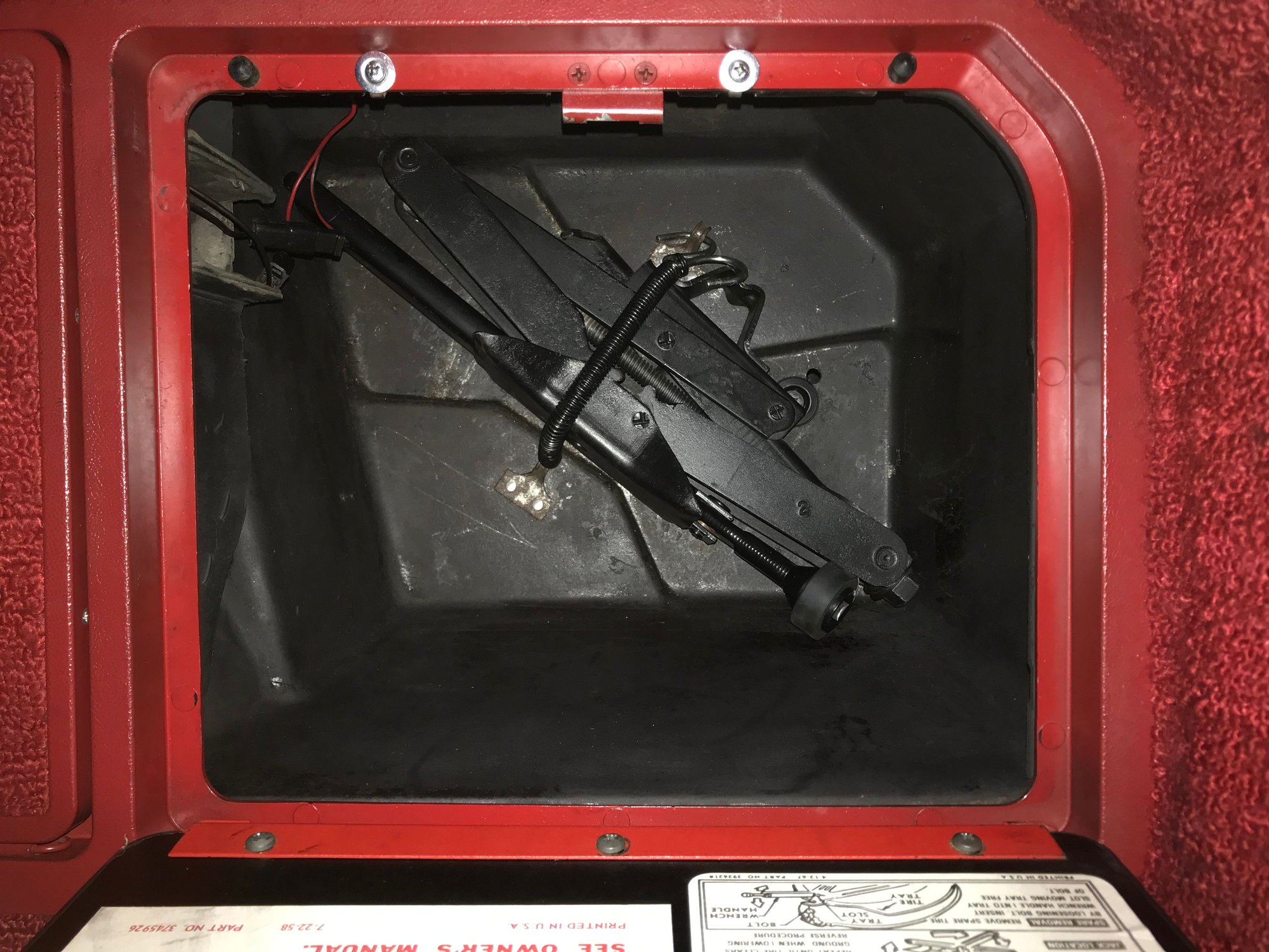

This is a photo of our jack storage compartment lid with a push button latch. I believe this is correct locations for the stickers.
Kevin
passenger side compartment door, bottom
jack storage area with upper compartment removed

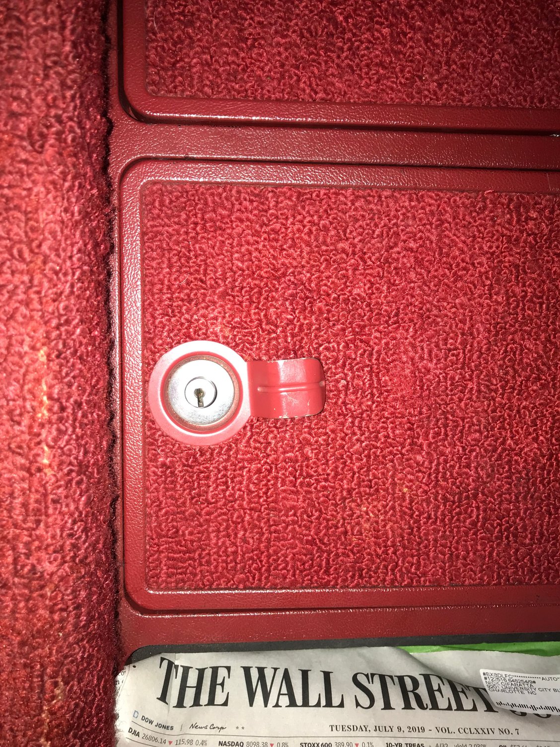

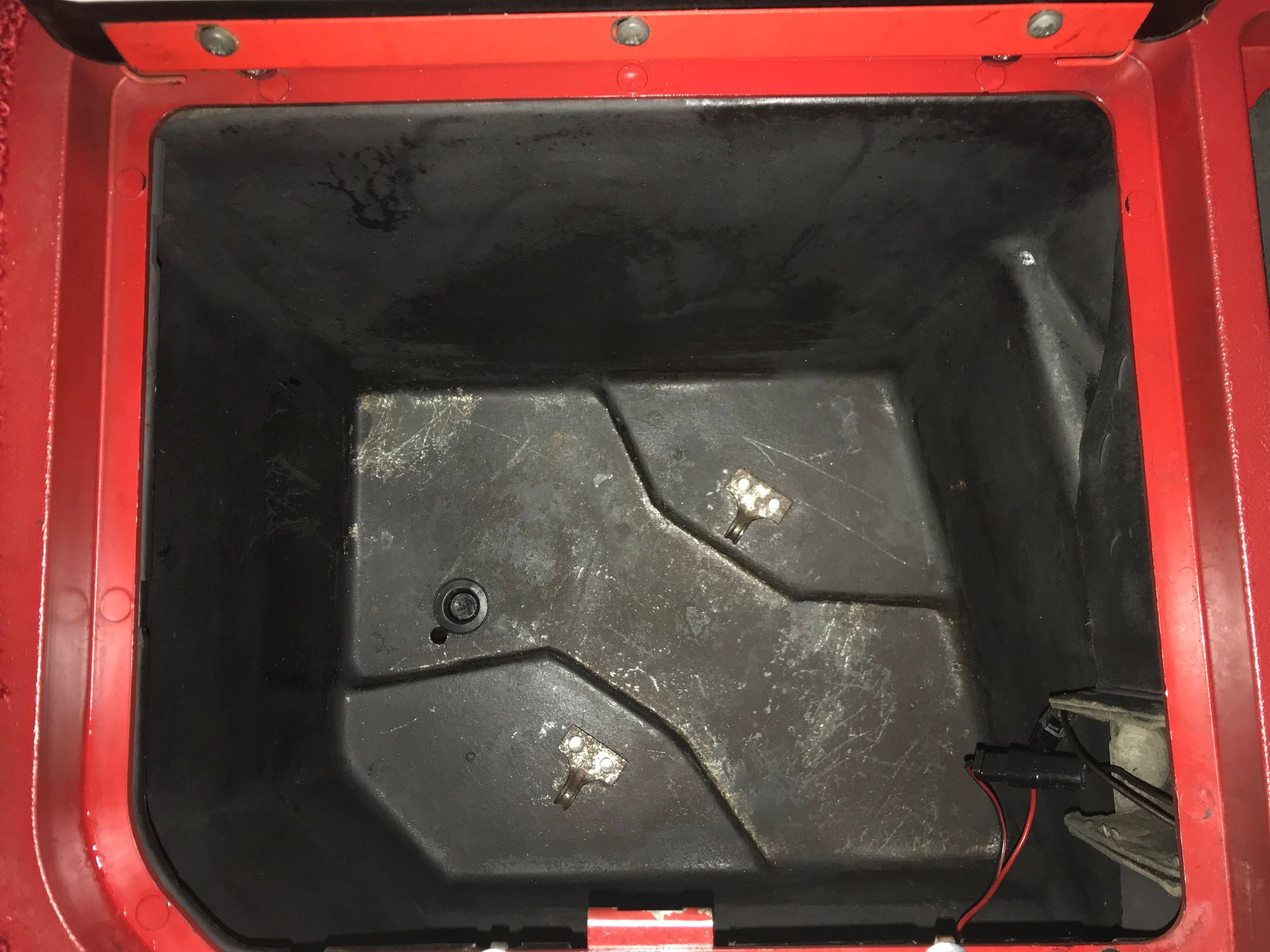

Scott,

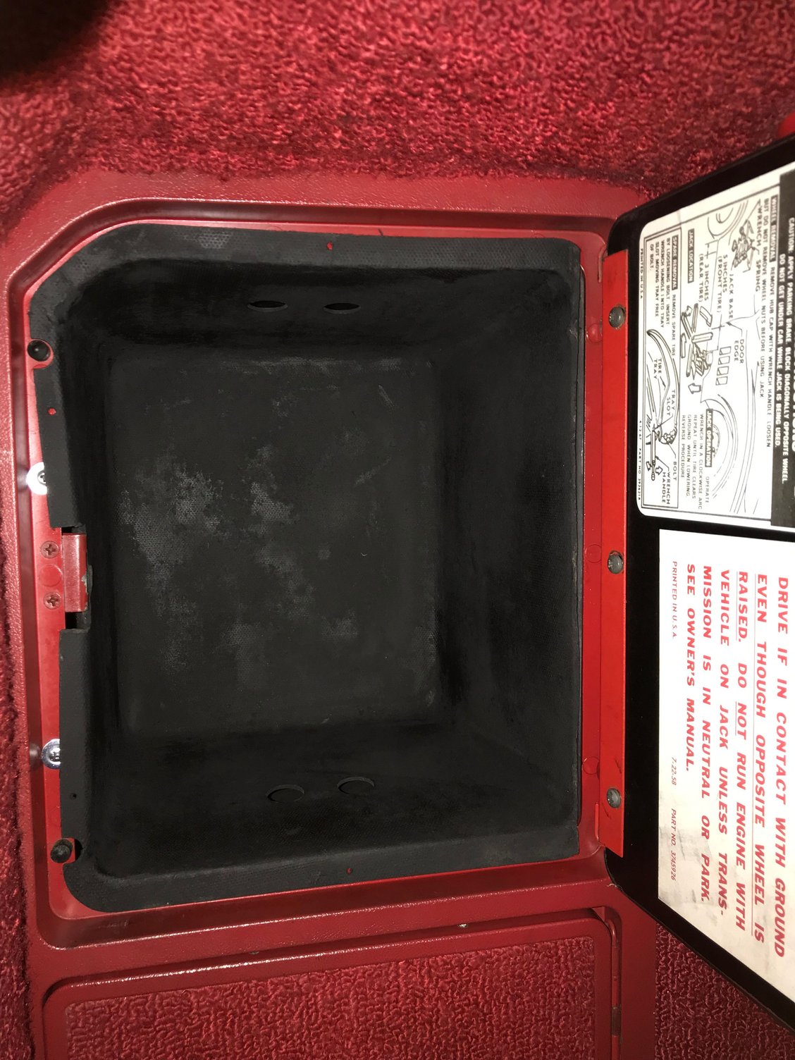

Here is a couple of photos of the locks and push button locations for 1969. MelWff is correct - only the center storage compartment has a lock. Driver side and passenger side storage compartments are push buttons - no lock. Also sending along photo of the removable storage compartment that sits above the jack. This one is original to the car and was recently decoded as 272668 being 2nd shift - 7th month (July) - 26th day of July - 1968 which matches up with our car's build date.
Kevin
passenger side storage compartment door with push button
removable compartment above the jack storage area on the passenger side of 1969
bottom side of the removable compartment
Center storage compartment with lock

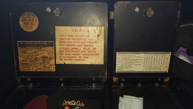

MelWff, not intending to hyjack scott1959's starter thread but discovered something new to me in the link that you sent which I believe was 1972 label locations on the storage compartments (photo below). Until just now, I did not know that there was a label on the bottom of the center storage compartment for a 1969. Our car does not have a label on the bottom of the center compartment. Not sure if it fell off, was never there in the first place, or if the center compartment has been replaced by one of the previous owners and the label was never replaced??
Would you happen to know if the label on the center storage compartment was used for late 1968 and early 1969 Corvettes. Or have a photo of one?
Sorry Scott - I'm currently working on my storage compartments too and just realized that I might be missing a label on the center storage compartment.

I cannt even make out what is on that label in the center compartment. I know on my 69, which I have had since 73, I do not remember a label.
Found it, not on 1969
https://www.corvettecentral.com/c3-6...l%26count%3d43

Hi Scott,
I believe the label sticker locations on the passenger side are in the correct location for 1969. See also Post #9 which shows labels in the very same location as those on my 1969. Should be correct.
MelWff provided a link to replacement storage compartments for the jack storage compartment. Here is another link:
https://www.corvettecentral.com/c3-6...plastic-483515

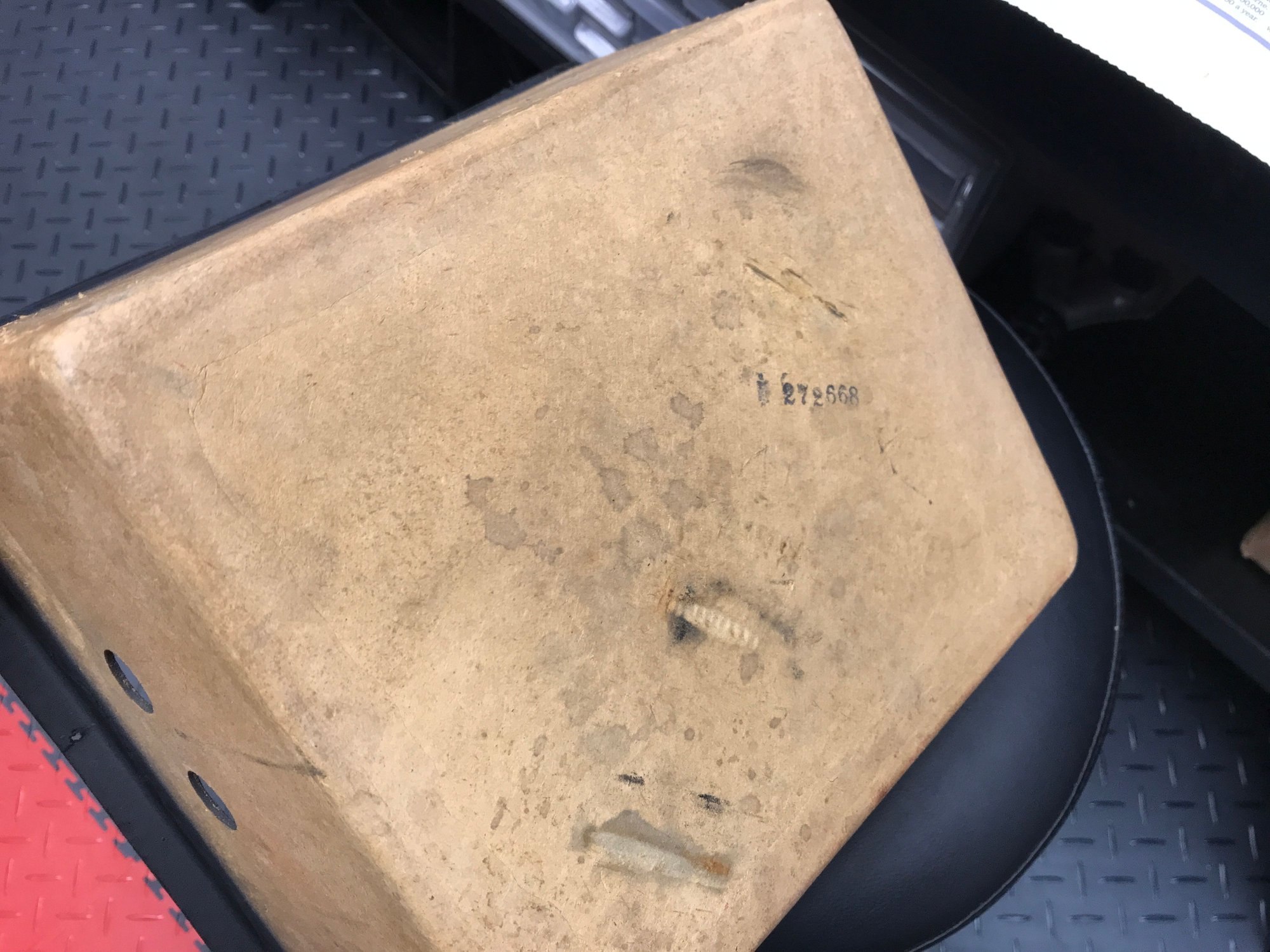

These reproduction trays would not score points in NCRS Judging events but then again that does not matter if you are not intending for the car to be Bloomington Gold original. The original trays are a pressed fiber board material, with a black matt flock material sprayed in them.
removable fiber board passenger compartment above the jack
passenger compartment in place above the battery
pull the removable compartment out and the jack is secured at the bottom of the passenger compartment

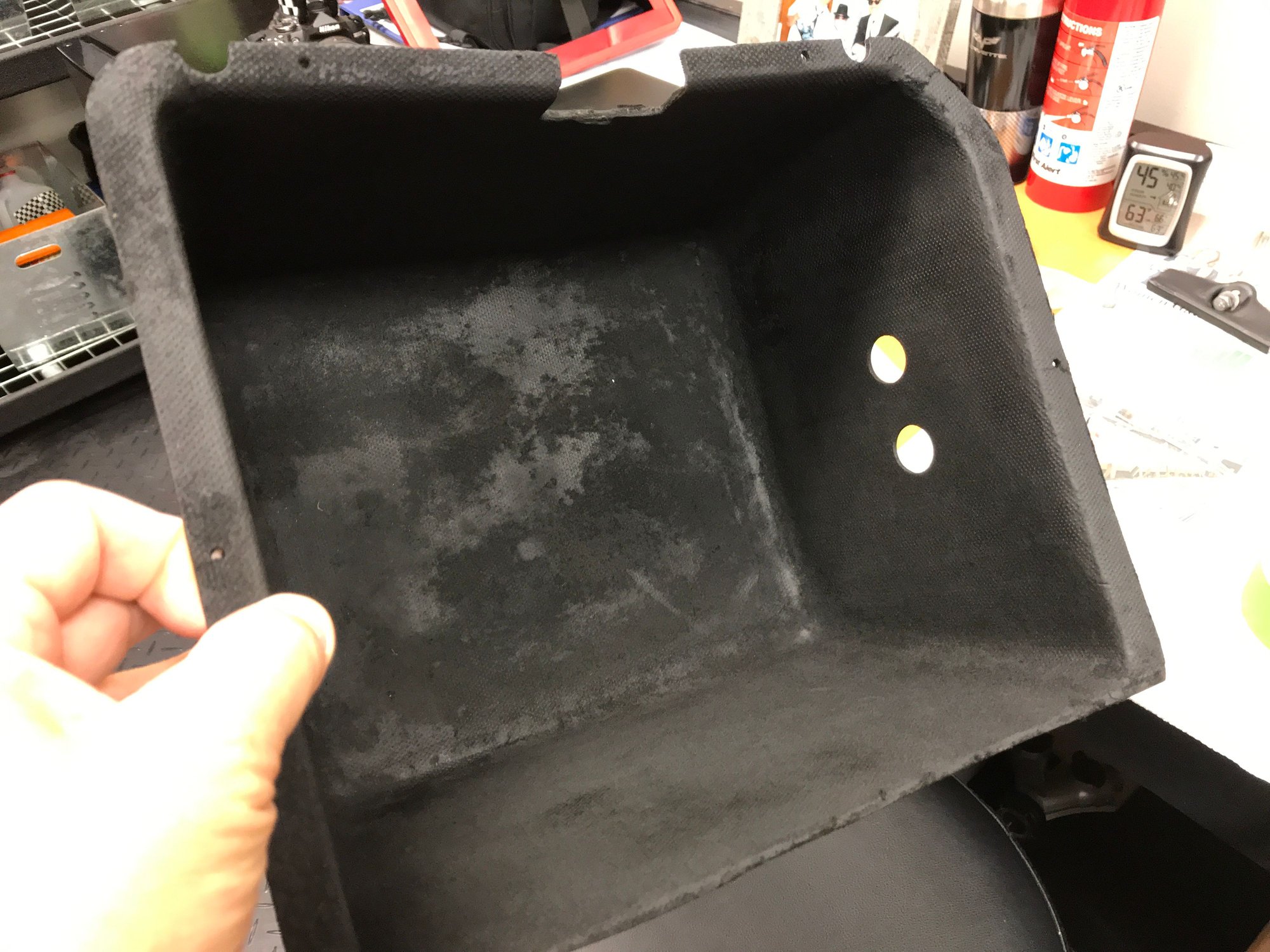

CF Members,
If anyone knows where to source the flat black flocking spray for the inside of the center and passenger storage compartments, could you please post a link to it or share where it can be purchased. I looked on Corvette Central and only found low gloss black spray paint - no flocking!
