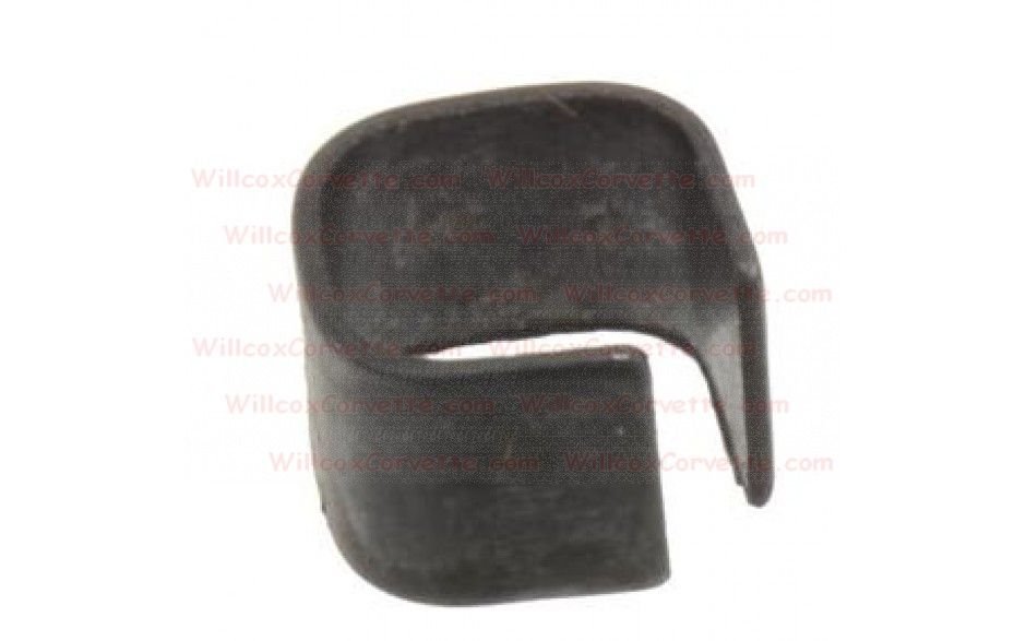

Hi Scott-
When the mirror screw is installed, inside the stem is a square spring tensioner. Did you put this in there before you installed the mirror? If you left this part out the mirror will flop after a few adjustments. It slid in the end of the stem and the screw actually pinched it in the mounting bracket. Take one a part and see if it's inside...
Ernie

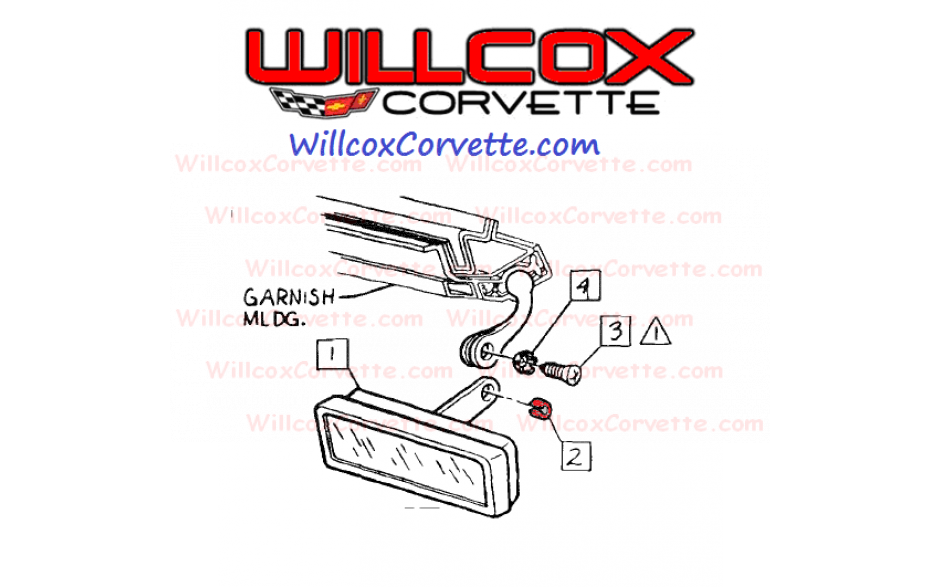

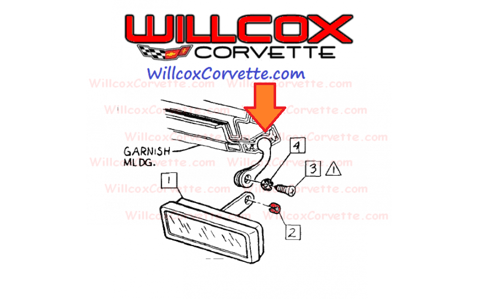

Scott,
Check the bracket that is made from pot metal. The retainer slips into two square slots in this bracket and when they break it will not hold tension on the pivot ball.
In this picture you can see the rectangular holes the metal retainer slips into... see if one is cracked. The one below is for a convertible but coupe is the same in how it mounted. If one of the ears is broken you can do all you want to tighten the pivot ball it won't stay put.
