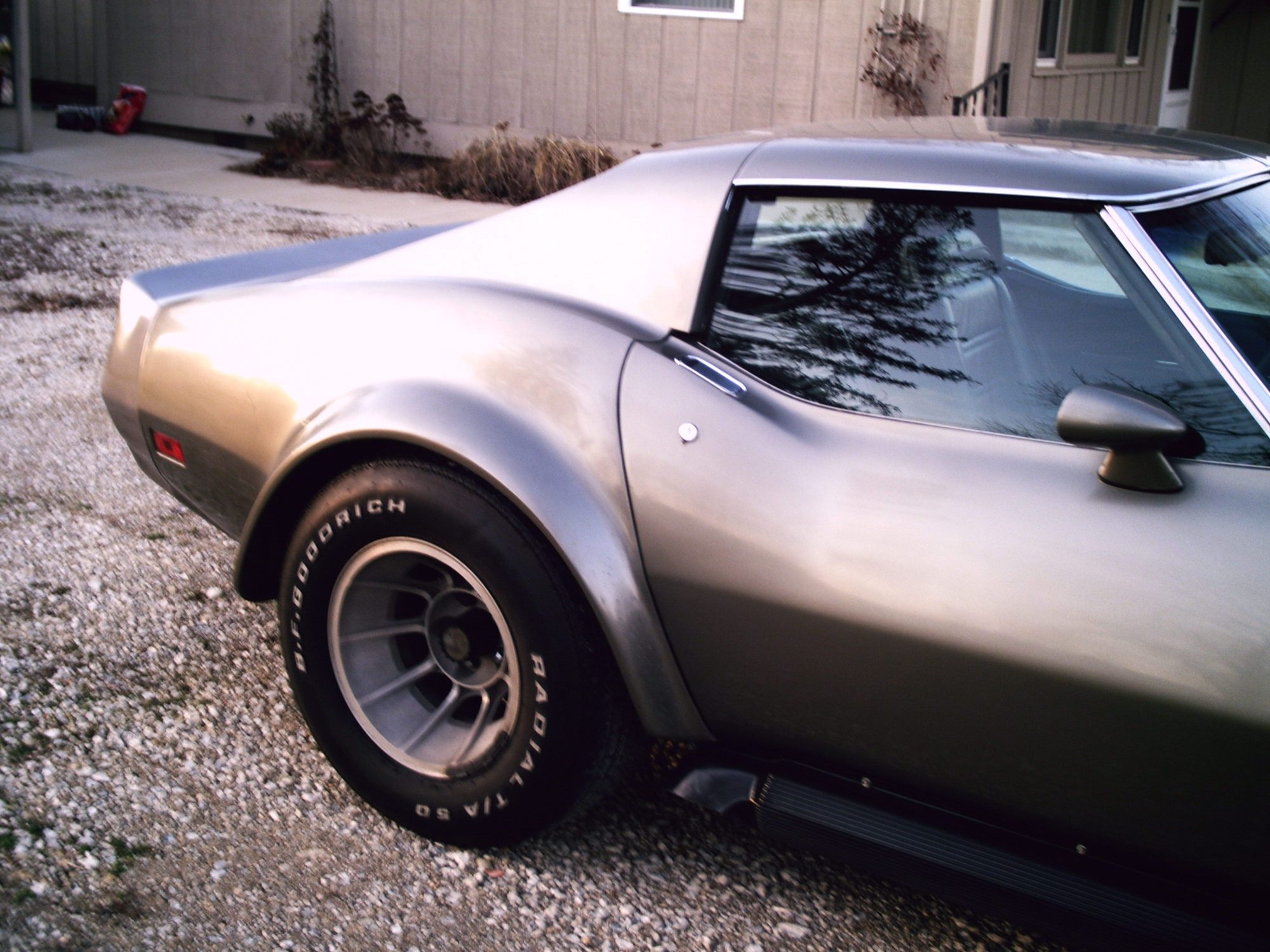

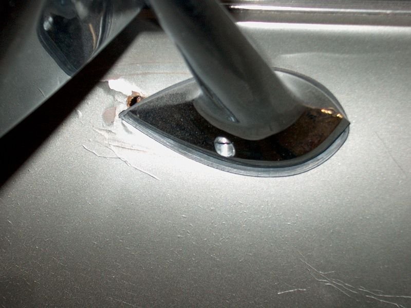

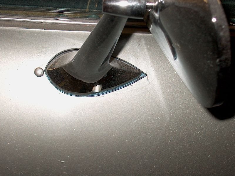

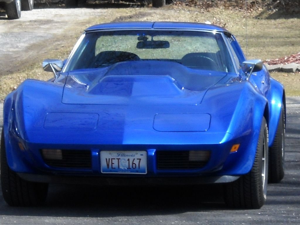

2024 C3 of the Year Winner - Modified
Some pics of the conversion, going to the stock tall chrome mirrors from the rally sport mirrors you will end up with an extra hole, yes i have done this two times. The rally mirrors look cool but have bad visibility, the stock mirrors give a better view over the hump in the back but i think they stick up to far so i have them turned upside down in the blue paint job.
Hope this helps.

Since i was going to repaint the car, i tried the rubber well nuts on the passenger side but they just worked loose, i believe the drivers side has a metal plate embedded in the door, the pass side has no provisions for mounting the mirror.
Since i had a machine shop at my disposal at work i just made a plate, still had to cut the inside of the pass door to clear the window.

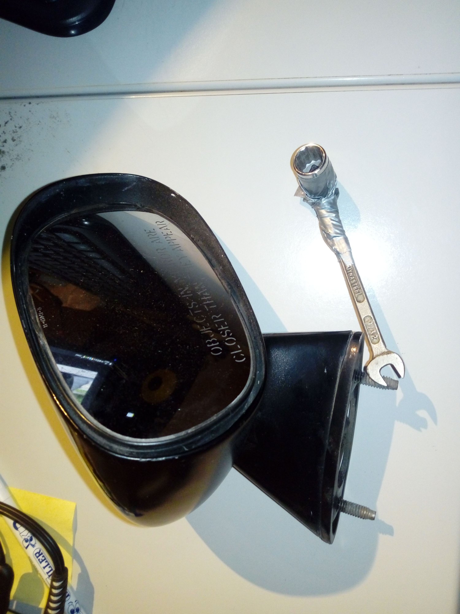

By surprise I got the nuts of the RH mirror loose with the following improvised tool...
I just used some 'gaffa-tape' to hold the 7/16" socket on the small thin wrench.
I had just enough room between the glass and the two nuts...
I only removed the two anti-rattle cushions the rest stayed in place.
