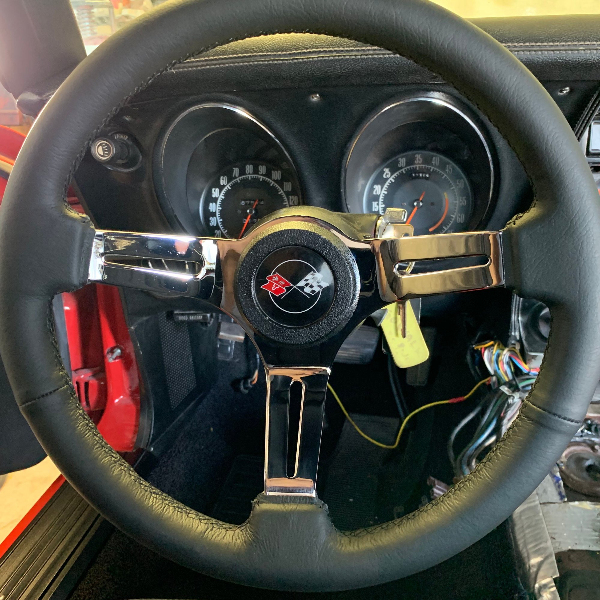

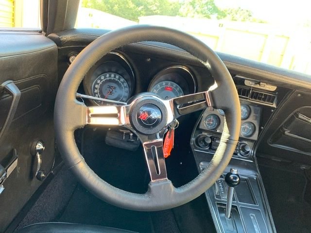

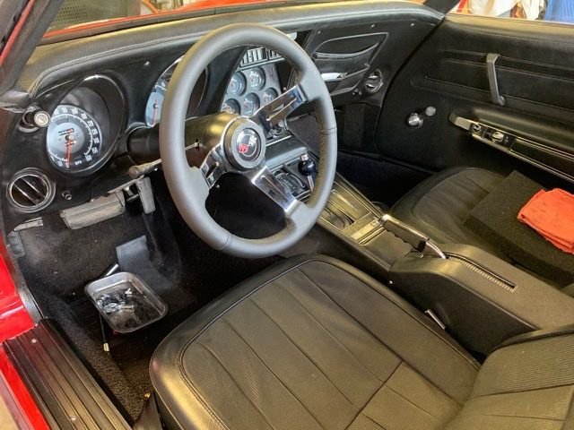

We put in an aftermarket wheel for ease of entry/exit and a better “feel” from the wheel itself. No adapters were needed. The wheel is mounted centered, it just happens to be turned slightly left in both photos.

It really is mounted straight. Lol!
The funny thing is, the previous owner mounted the original upside down. I don’t even know why the wheel had been removed. No new parts were located from steering wheel to rag joint.

Thanks! I think we were both posting at the same time. I posted above, but it’s from Ecklers. It makes a really big difference. It’s thicker, smaller in diameter, and more flush (not as concave as the original). All combined, except for the thickness, contributes to more space between the bottom of the wheel and the drivers seat. I love it. They also have one that has a brushed finished in case the bright chrome is not your style.

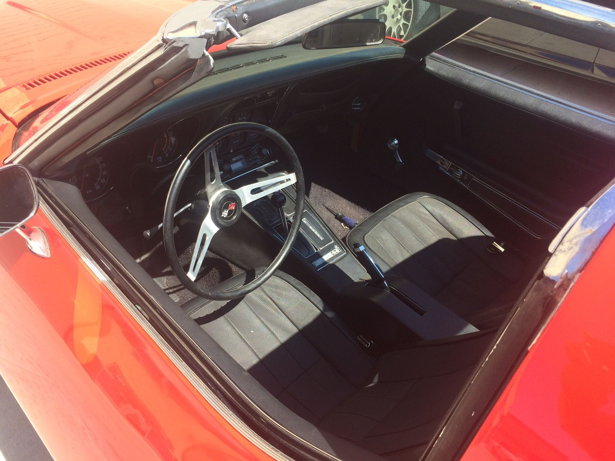

Check all the usual Corvette parts vendors. Many have that type of wheel. One thing to note about them is the diameter of the center hub which mounts to the column. Some of this design wheel have a hub that is the SAME diameter at the column (like the one in my photo). Others have a slightly larger center hub (as in Jstan2014's photo). Both are great looking wheels, but the center hub sticks out a bit on some. If that is important to you, ask the vendor about the size of their center hub.
