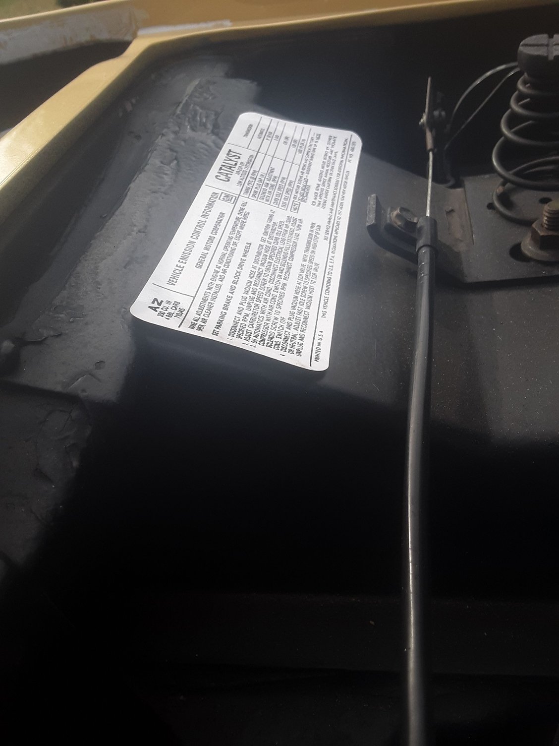

Is there a trick to make reproduction decals stick? or last more than a few months.
I use wax and grease remover let it completly dry.
after 1 year. I think this started lifitng after a few days.
1 week ago.
after 1 year. I think this started lifitng after a few days as well.
