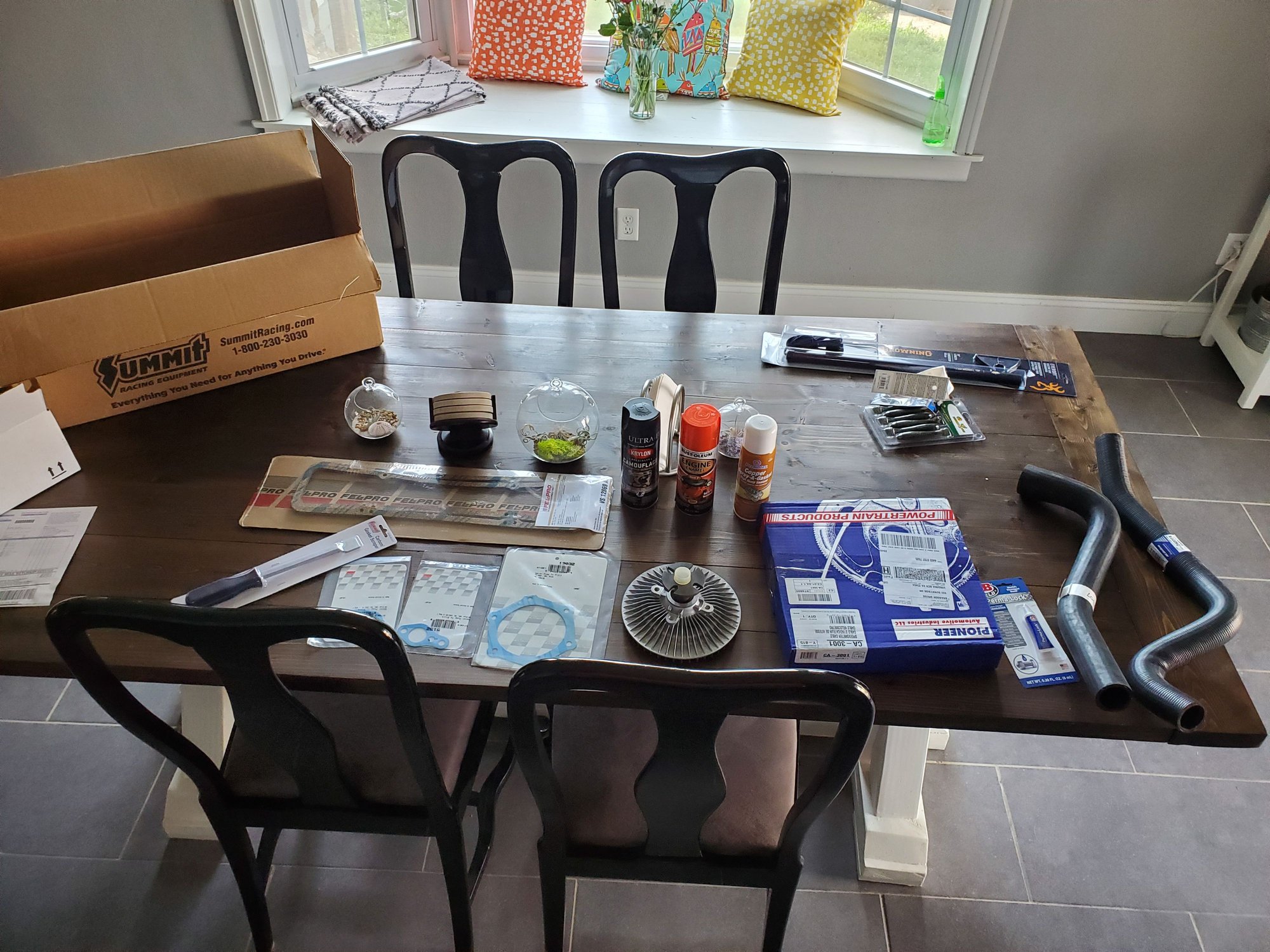

Works gettin done today! Have RTV ultra black and new clamps in truck too
Gettin at it today!
