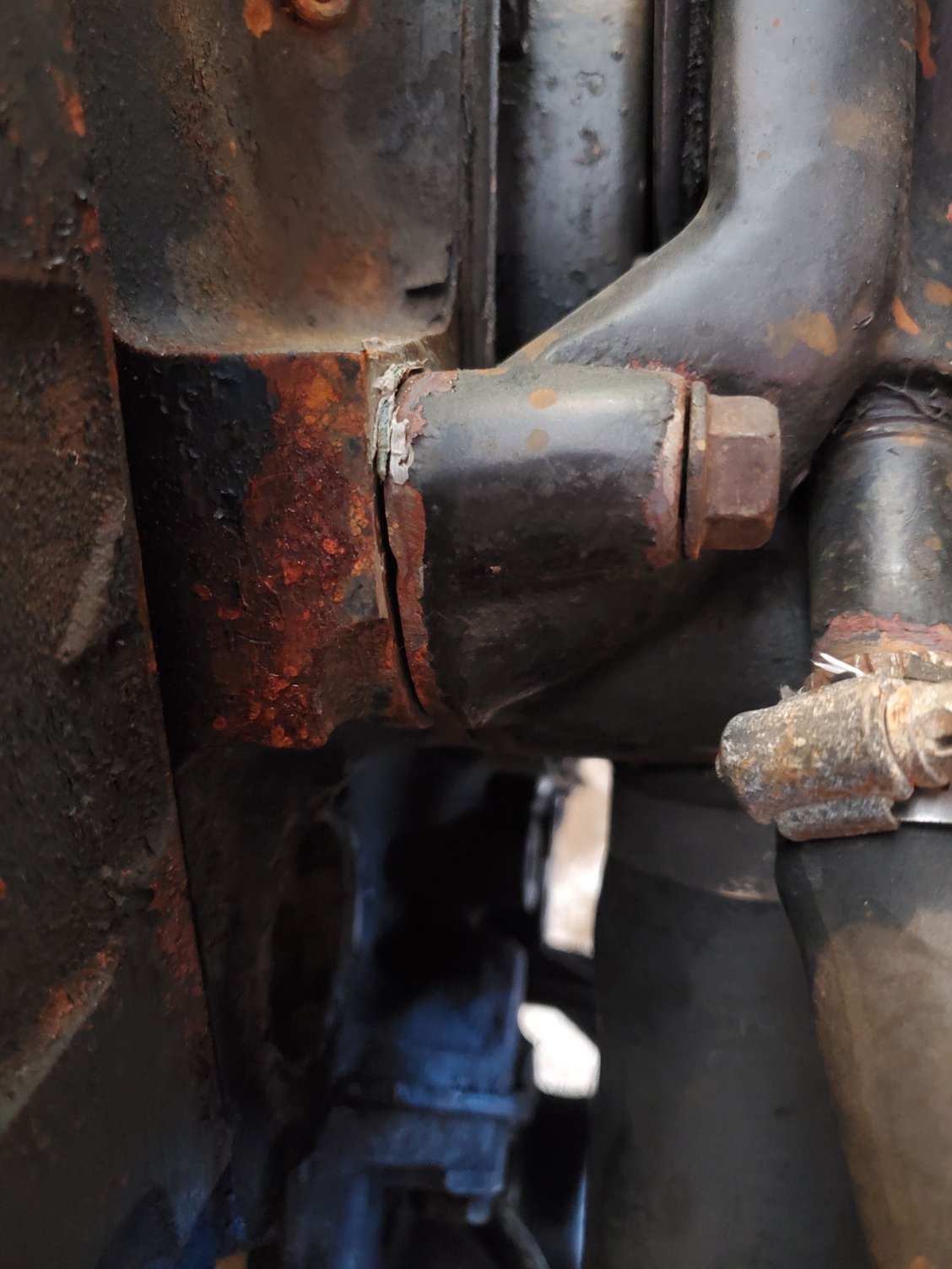

Poured distilled water in, and it leaked like crazy out of the water pump assembly. This is where my question comes in - I have heard of water pumps failing, no big deal - but I dont recall ever hearing of the GASKET failing on the water pump... if you see my photo - the gasket was blown out... is that normal? Anything to be concerned about?

You can see where the gasket blew out here... is that normal?

Looks like the bolt is loose

I’ll second that and from there it vibrated loose.

Or tight but bottomed out before it is clamping the pump. You probably don't need a pump. You need to find and strangle the guy that replaced it. Give you a hint. Name's Bubba...

IMO: Replace the gasket and make sure the bolt is actually doing its job along with some locktite on the threads.
Do not let this into a full "frame off". A water pump can do only 3 things - leak at the bearing when the seal fails... fall apart completely because the bearing fails...or pump water. I have bolted on old random used water pump cores and run them for YEARS without an incident.

Testing the pump visually you can look at the weep hole on the underside by where the shaft comes out. If it looks like it's been seeping , it's going bad. Turning the shaft or checking for wobble also. As stated in the above post , check the bolts for length possibly the wrong bolt was put in and it didn't compress the gasket . Another cause to blow out a gasket might be a stuck thermostat, that would build up pressure in the cooling system. I also would change out the pump just as a preventative maintenance item. Not saying that the replacement would be any better though as I have had replacements fail also in a short time. They were replaced under warranty but I still had to do the work.

If the pump wasn't leaking and turns free & smooth & tight (by hand directly on hub), it's good. I'd be far more inclined to replace an old Thermostat and fan CLUTCH before an apparently good pump.
But if you must ... do KNOW it's Not a Long pump, Not a short pump ,.. it's a Corvette pump for your year,
In this matter, I'd certainly test the bolt-fit WITHOUT a gasket to ensure they're not bottoming against a shoulder etc. New bolts are cheeep.
Of course, fresh gaskets, hoses & clamps ... but not pump unless it's obviously failing. Permatex #2 non-hardening on gaskets & threads.

The water pump bolts are NOT all the same length. If a longer-than-required bolt gets used in a specific mounting hole, it can 'bottom out' and IT CANNOT SEAL.
Make sure the bolt lengths are correct before pump installation; and put some [quality] sealant on the last few threads to prevent internal casting/machining leakage from wicking up and out at the bolt head.

More than likely it is a replacement pump with bolts in wrong holes or from a big bin of mixed up bolts. Obviously not new bolts. Also check the sheet metal plate on the back of the pump. If it is 40-some years old, they can trust through.
