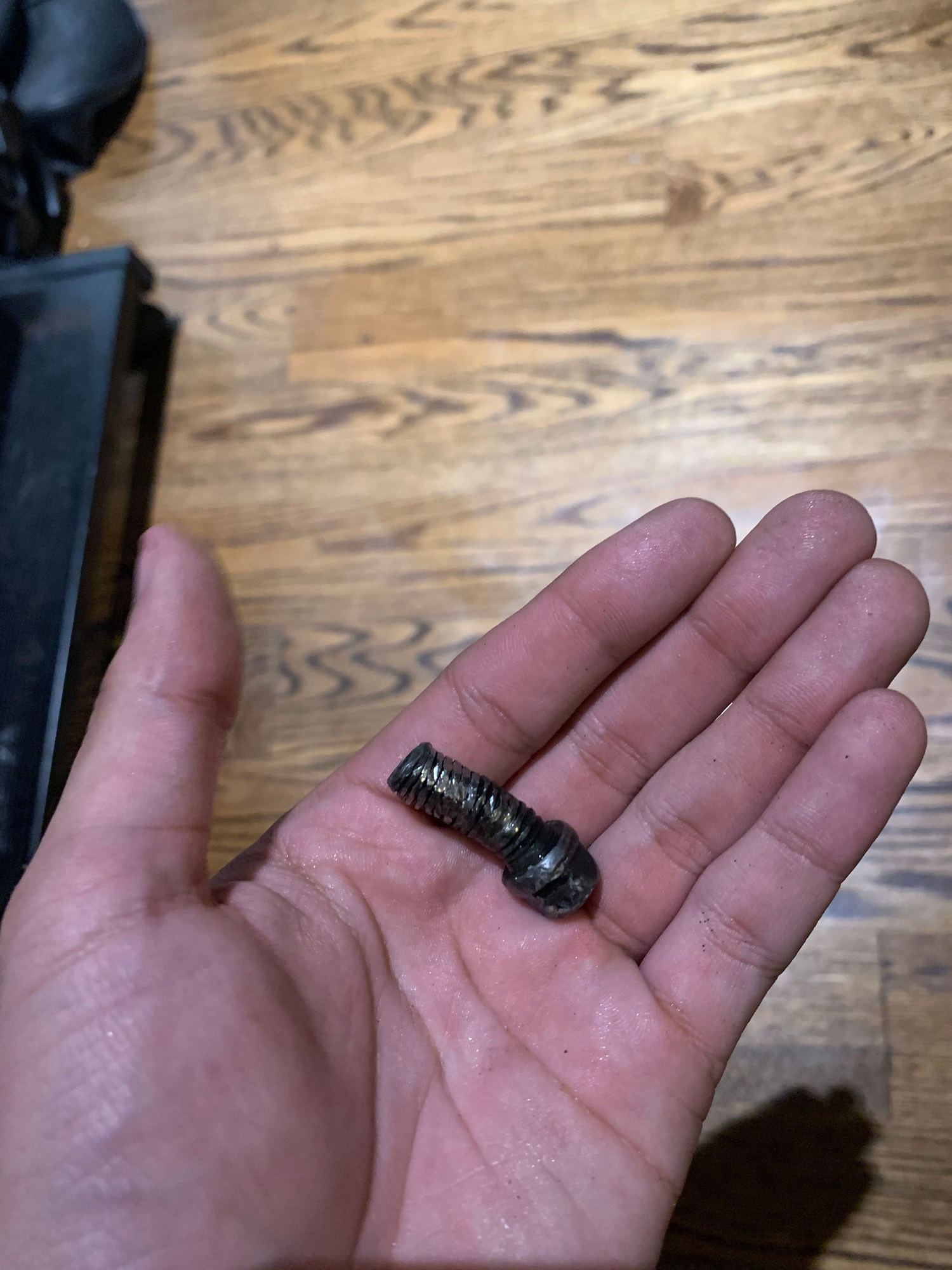

You said it was recently worked on. How long ago? Could this be a result of their negligence? If so, I’d make them eat it.

Was it running when it arrived at shop? If so, how well ?
Who was last to have hands on header bolts ?
certainly Looks like a header bolt ... reduced head size w/ narrow flange ... perhaps was used as an intake bolt.
I think it may be possible for it to have "gone" thru carb, laid on intake plenum, then gotten past an intake ... if it were mine, I'd test that route as well as past exhaust valve
I was the one who installed the headers... but I didn’t have any extra bolts. It spent some time waiting while at the shop, but it was out of the way. It was running well! I was doing the waterpump myself and bought plugs and wires and more or less said “if ya wanna mount em while I’m gone go for it”

Ever see a mechanic use an air cleaner lid or the air cleaner itself for a parts tray?
It happens.
That bolt could have been in the intake since that motor was installed last April and just found its way to doing the damage.
You posted it is a create motor.
Buy another one, swap it out and move forward.
Even trying to figure out how or who adds additional stress to the situation.
It's still winter and just imagine how much enjoyment you'll get this spring with a new motor and maybe even one with a little more hp!
Good luck.

Ouch! Sorry dude, that hurts to look at. I won't hazard a guess but I'll be following this whodunit.
Unless you've got a Barrett Jackson car, I'd ignore all this nonsense about numbers matching value. I'd much rather have a new GM crate motor than an iffy rebuilt hand grenade.

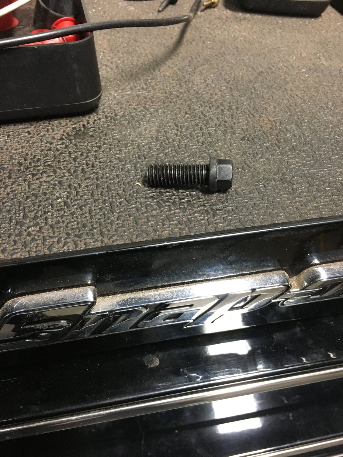

While everyone seems to think that was an exhaust bolt, which it could very well be, this pic shows a bolt that came with an Edelbrock intake manifold in the box that I recently installed in a customer’s vehicle (customer chose ARP bolts for the install). It also looks very similar. Just saying. And as far as just installing a new crate engine, that’s fine if you have 4 grand just lying around. But not everybody does.
We did install a new intake manifold on the motor when we installed it, but surely it would’ve shown itself way before now right?
^^^ this ^^^ That's it ... most intakes have some sort of web/grid pattern cast into plenum which could nest a small bolt for a while.

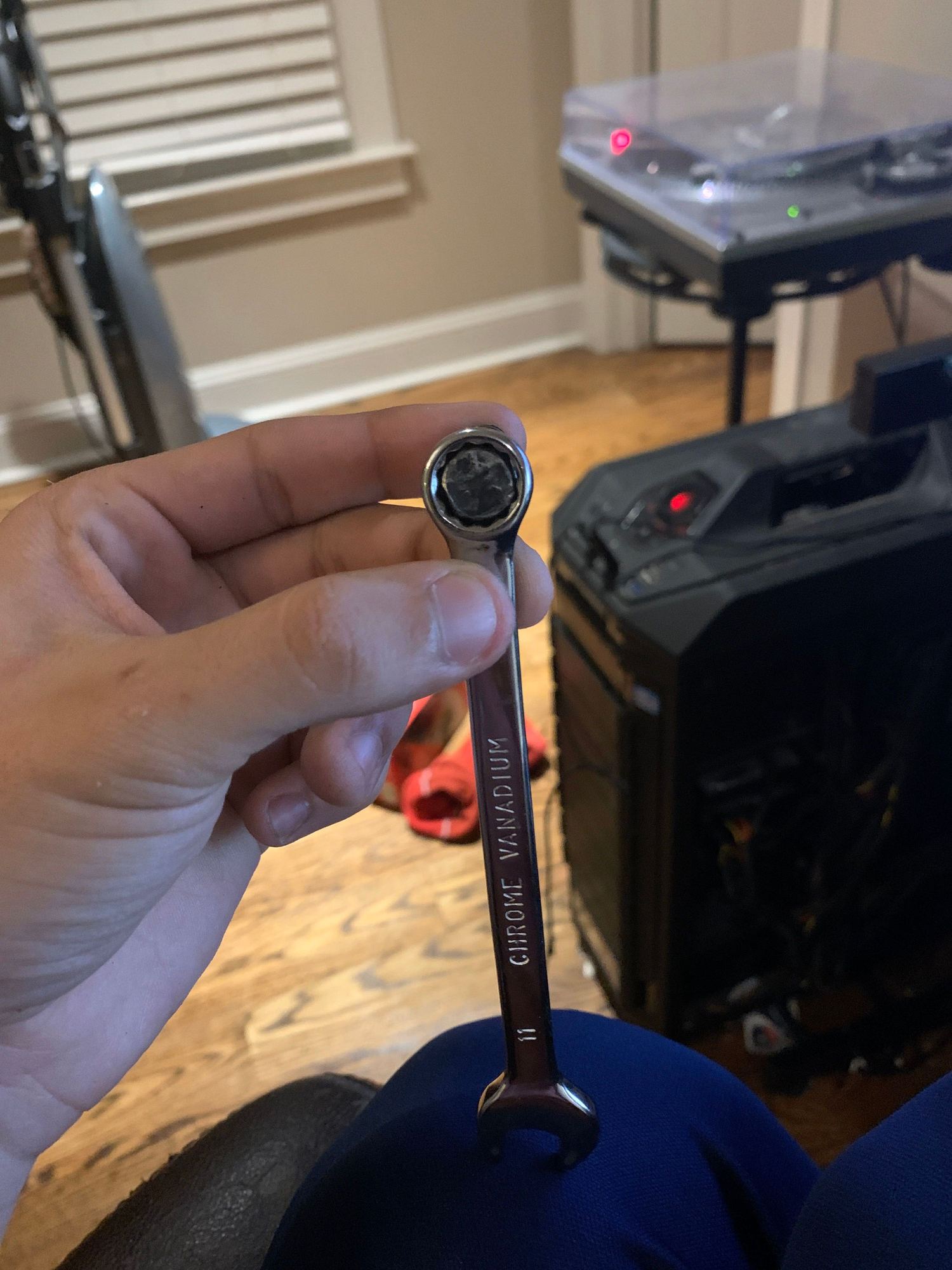

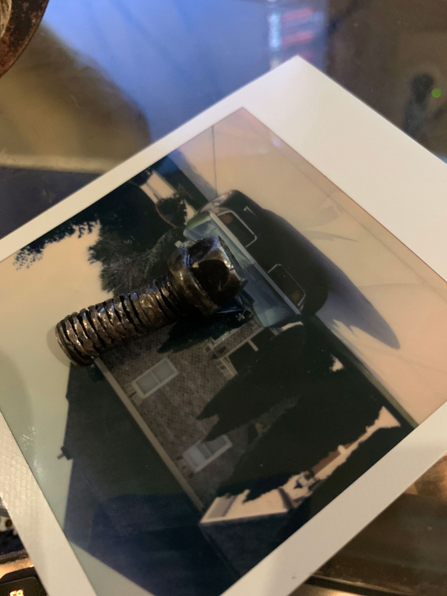

So... got the bolt out and measured it... It's a 7/16 bolt, NOT a 5/16 like my header bolts are.
Here's the offending bolt.
So what the **** is going on here? Could someone have done this to my car on purpose?

Definitely not 5/16.

Since the engine has to come out anyway I would disassemble it down to the short block and cart it off the your local machine shop and see if a sleeve is a good option. My local machine shop has sleeved some badly damaged cylinders with really good results. I assume the cylinder head is toast as well? If they are aluminum sometimes they can be repaired. Cast iron heads not so much. With that big of interference of the bolt it may of bent the crank. Again a good machine shop can check that stuff.
If the block is un-useable there still a lot of good parts left in the engine so maybe a new block and reuse your crank and the good rods and pistons? Just trying to save a few bucks but still have good a engine when you are done.
Bummer about what happen.
I can't see a bolt of that size getting sucked back up thru the header tube. Also having a bolt like roll around in the intake for some time before falling into a port seems unlikely. Does some one not like you?

Assuming it was some one who wanted to do this to the OP.
The person would need to break into the car, pop the hood, remove the air cleaner, drop in the bolt, replace the air cleaner, close the hood and close the door without being noticed.
Who has the opportunity and forethought to do that?
It would be easier to dump sugar or another chemical into the tank and walk away!
