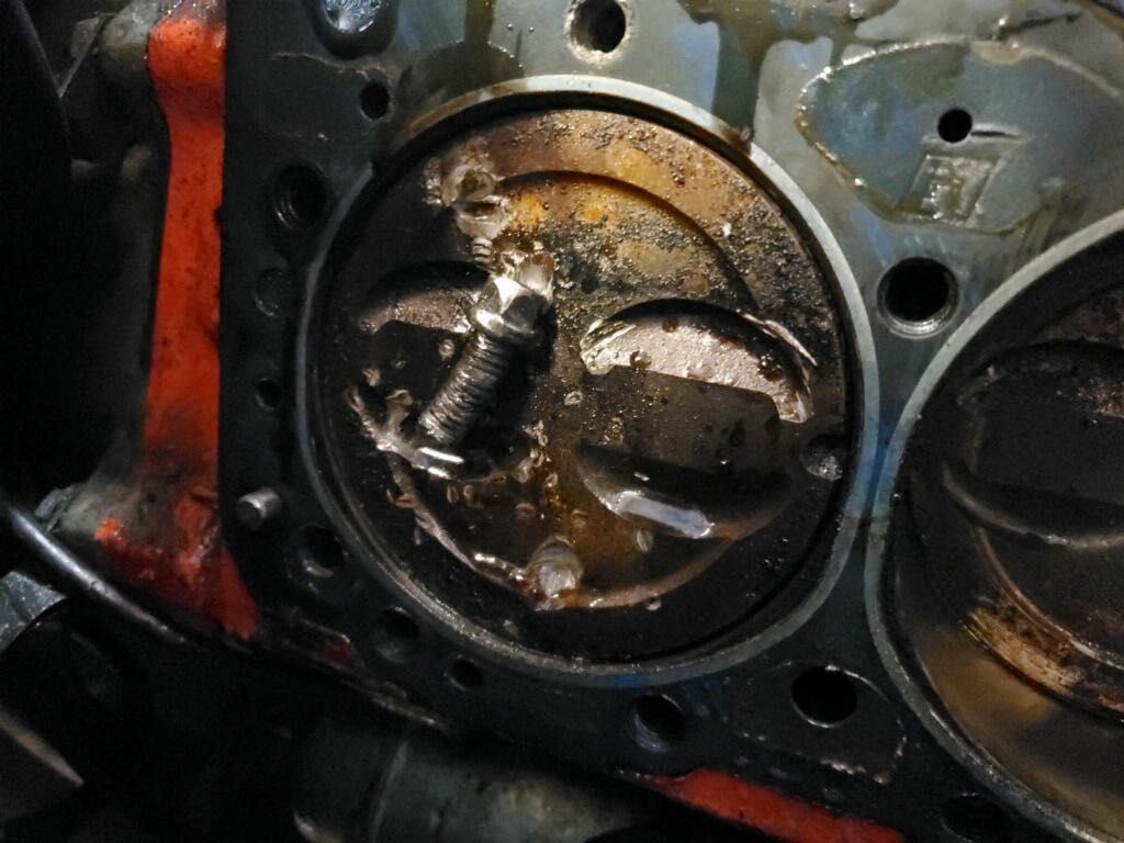

Heres the damage.

The only way it got in there is from the exhaust someone dropped it down the header and it got sucked back in when you down shifted heavy there’s no way it got past the valves I don’t think it would open that much ... just speculating 🤔

2019 C3 of Year Finalist (track prepared)
This header bolt was somehow dropped inside the header pipe 2 months ago and has been riding around since then? Now, it gets sucked back up, through the collector, up 28 inches or so of primary tube, past the exhaust valve and into the chamber? How much vacuum does it take to lift a bolt 28 inches?
Me thinks there is more to this story. It's more likely that it was riding around in the intake manifold, resting in a groove or notch until it came dislodged and found its way to an intake valve. Intake valve hit it and bent, allowing it to pass into the chamber. That's when things got ugly. It is a header bolt, or a small head intake bolt?
Got a pic of the intake valve on that chamber?

Looks like a header bolt. Block is trashed.
Hard to fit that big bolt past an intake valve.........Maybe went in thru the spark plug hole?
Piston came up and bent the bolt. Witness mark on the piston top.

My bet is for down the carb and into the intake manifold. It would not have to make it past the valve to cause damage. If just a edge of the bolt caught the valve it would destroy the valve and all the crap would drop into the cylinder to cause more damage. Whatever the reason, it is sloppy mechanics.
If I was offering to by the car with a destroyed engine still in it I would have to deduct at least $7-8 from the value of before damage.Yes, I know what a lowball crate engine can cost. But why would anyone buy one of those. Plus you got the labor of pulling the engine and dropping a new one in. Even if I would do it myself, I would sure as h.... figure my time was worth something.
