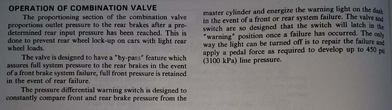

Here's the text from my 80 shop manual. At any rate, it sounds like the combination valve needs to be reset before you'll be able to bleed the rear brakes. It's a bit of a catch-22 if the valve has latched and you can't build pressure in the rears.

Tex, I have a very similar issue. I replaced just about every part of the brake system on my 76 recently, and went to bleed the brakes with my Motive pressure bleeder from the master cyl side. I had bench bled my master (done this before on other cars) and could only get a trickle out of both of my rear calipers. Both fronts had brake fluid shooting out from the pressure, but I couldn't get the rears bled. Tried starting the car, letting it warm up so the vacuum would be nice and normal, and I had a spongy pedal.
From what i am reading my proportioning valve (or whatever you want to call it) has the internal valve towards the rear. When that valve goes to the rear it is similar to a hard brake situation, and the valve limits the flow to the rears as to not lock up the rear tires. I was not aware of the tool that keeps this from happening, but have since ordered one. If I can get my valve back centered I will use the tool and bleed them all around again. The vendor that sells the tool, POL, replied to my email and suggested this..... before doing anything turn the ignition on and put a test light on the switch on the proportioning valve. It should show 12 volts, or light up your test light, implying that the valve is towards the rear (or simply not centered). I have been working double shifts so I this is where I am at, and have not tested this yet. Anyway, if it shows lit up, then they say to crack both front calipers and stomp the brake pedal, which should center the valve, and the light should be off. If so, they told me to replace the sensor with the tool and pressure bleed the brakes. I hope this coming weekend to do just this procedure and get my car back on the road.
If anyone more knowledgeable about this whole system has any input or corrections, please do so - I am looking for anything that will help me also. Short of ordering another proportioning valve, I hope to center the new one on the car and be back in action this coming weekend!
