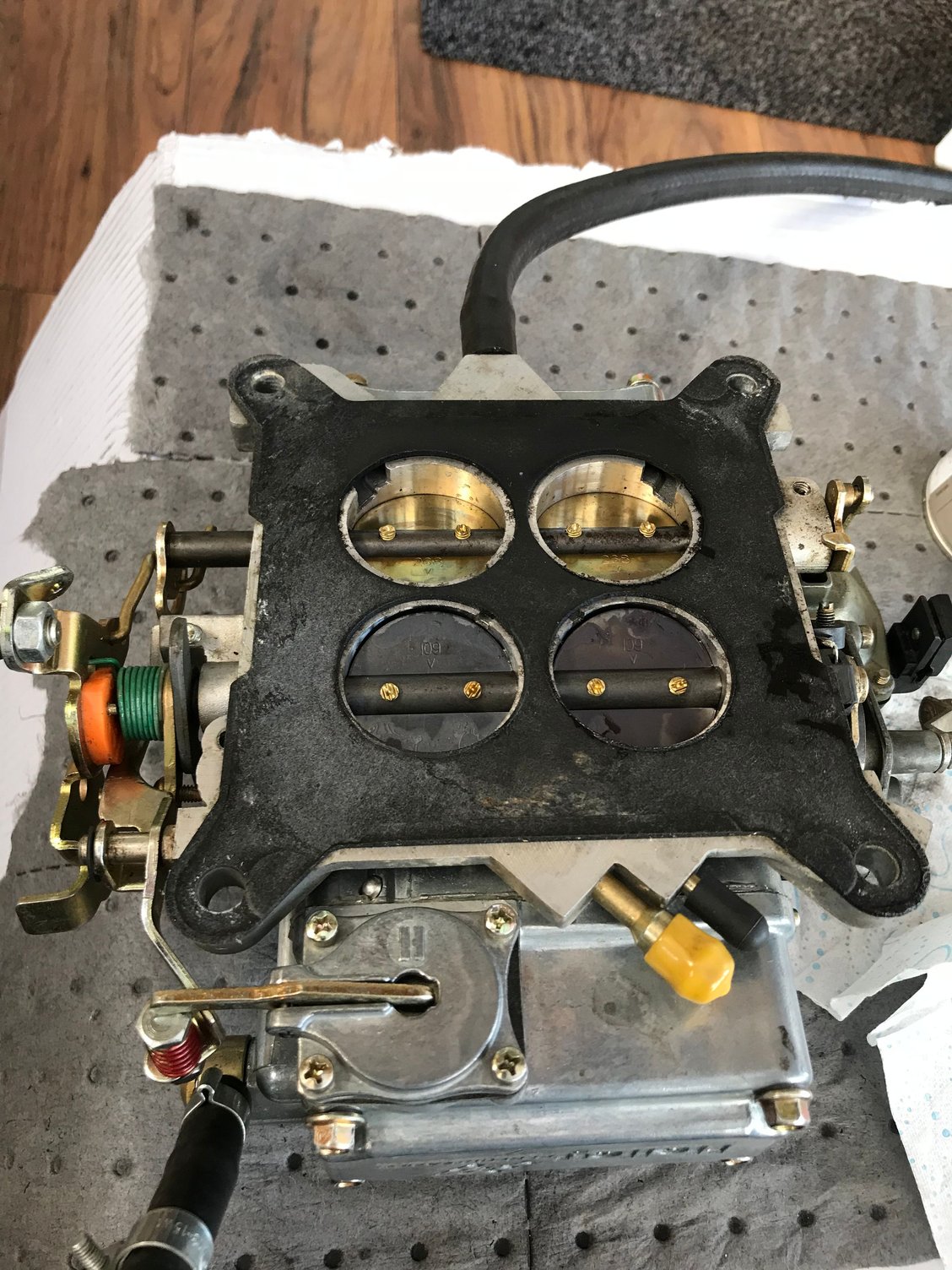

Hello everyone this is my first post . I have just had a c3 5.7 ltr engine and auto box fitted to my 1958 Volvo tp21 sugga . It has a holly double pumper carburettor fitted that looks new . It starts fine will run for about 5 mile or 15 to 20 minutes. Then it looses power and stops unless I pull the choke out then it will run rough for a minute or two then I can drive another half mile it will do it again . It has the original mechanical fuel pump fitted and a fuel regulator tap that is set on the highest setting ie 5 . Anybody have any idea what the problem could be . Ps it smells of petrol when it’s running rough . Many thanks in advance for any help . Thanks ivor

You need 7 PSI at idle, if you have a stock fuel pump remove the regulator.
Can't tell clearly from the picture but that does not look like a double pumper, looks like a vacuum secondary.
Do the float bowls have sight plugs, if so check float level.
Have you adjusted idle mixture screws?
Have you checked timimg?

Obviously the carb is starving for fuel. But why? Doesn't sound like a float adjustment issue because those bad effects would show up sooner than 5 miles.
Like Melwff said, suspect the regulator. Its not doing its job.
I see mechanical linkage from primary to secondary throttle shaft, but do not see a secondary accelerator pump. Huge transition slots.
Are you using the front vacuum port for the distributor? Back port goes to some type of power brakes?
And lastly, do not re-use that base gasket. Its showing cracks and maybe heat damage.
Hi thanks for the information the front port is the distributor vacuum pipe . I have no brake booster fitted . I will try the fuel flow test after removing the regulator. Many thanks ivor

I'm confused. Front vacuum ports are yellow & black capped off. One of those is full manifold Vac. The other is "timed" Vac. Which you don't want.
The Vac port off the back of the carb goes . . . . . . .?
And, are you using a fuel line filter? If so, where? Has it been changed recently?
I am 99% sure that is not a "Double Pumper". Not seeing an additional pump.

You can clearly see the bottom of the secondary vacuum diaphragm in the upper right of the picture, not a double pumper.

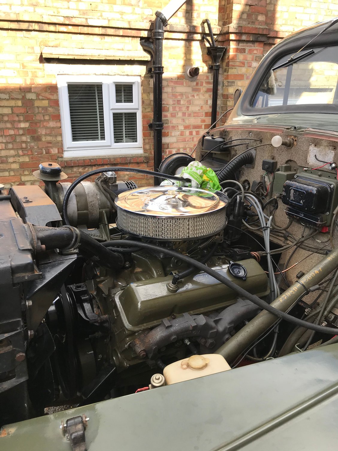

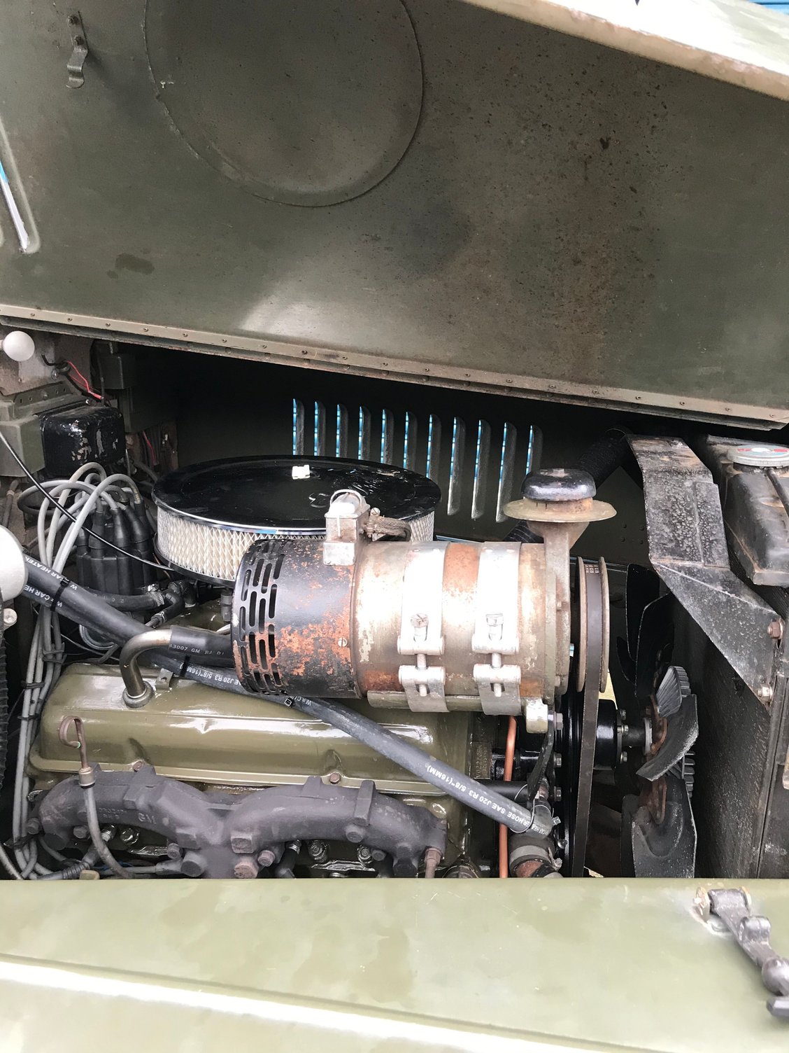

Well, I see a couple things that need attention.
You are pulling vacuum off both valve covers without any vent to allow air back into the crankcase.
You decided you like the giant generator and ditched the ALT. Interesting.
Is that a 6V or 12V system?

Hi what would be the best thing to do regards venting the valve covers ? . The car is positive earth as the vehicle is a radio command car . there are a lot of radio suppression devices . So we thought best to keep it positive earth .itd 12 volt

It looks like the gas filter is sitting on or close to the radiator hose. That could be causing the gas to vaporize as it will vaporize at about 140 degrees F. Engine runs at about 200 degrees F.
