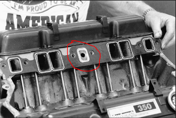

In the photo below you will see a hole in the red circle.......this hole goes directly to the exhaust port believe it or not and is where the heat comes from.....this is an "open" heat riser. There is an accompanying hole on the intake where it bolts down. The 1204 gasket blocks this hole with a thin piece of stainless steel.
Jebby

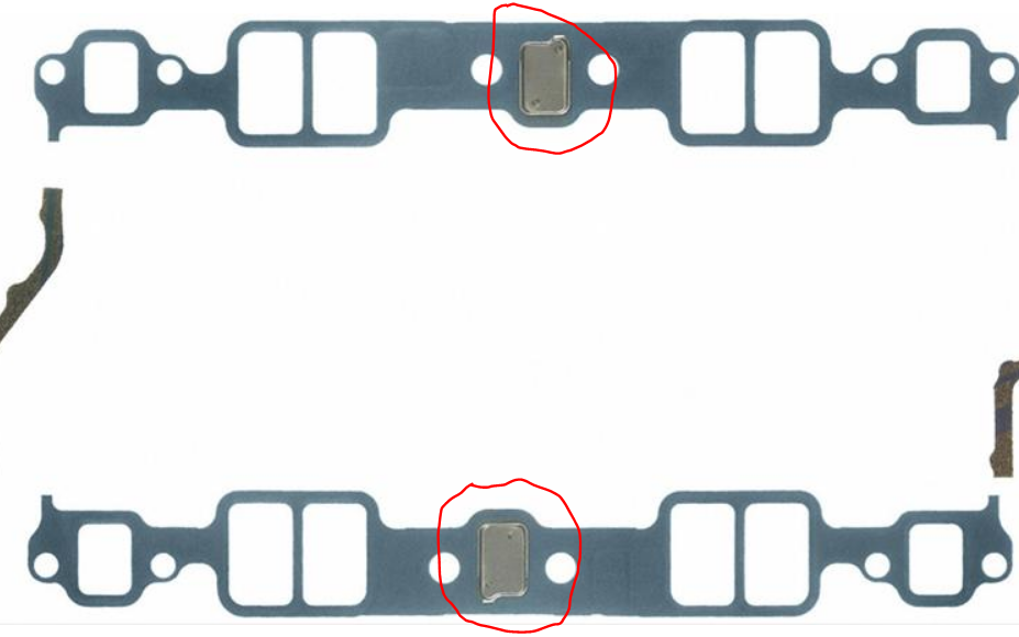

On the passenger exhaust manifold there is a heat riser valve that blocks and forces exhaust through that hole at cold start up.....unless you removed it during your install.
The first pic is the valve...the second is the spacer offered to delete this.....you can wire, weld or remove the plate so it is open.....but the clean fix is the spacer.
If this valve sticks closed....it will force all of the exhaust through the middle of the intake to the other side....creating scalding heat.....this miserable thing was the cause of many woes in the 70's.......it could actually destroy the engine over a period of time.
Jebby

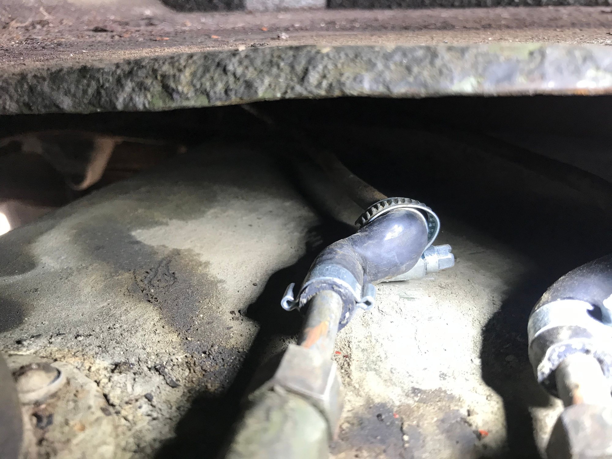

Hi thanks to everyone who tried to help me with my problem. I have no found out why my car kept running. After the engine swop on driving home the car did 40 mile then shutdown restarted then 20 mile in the end 500 yards . First thought lack of fuel but fuel always in the visible fuel filter . When engine stopped would still inject fuel into inlet . So then ignition replaced all ignition components. Swapped ballast resisted coil
for 12 v sports coil . Removed all filters from radio car wiring. Still no joy .back to inlet manifold fitted new inlet gasket with stainless steel inserts . No better . Then thought drop the fuel tank . HERE IS THE PROBLEM. Kinked rubber fuel pipe . So engine would run for a short time the pump would suck the kinked pipe shut .then at rest would leak through a bit more fuel . What a task this has been . So thanks again ivor
