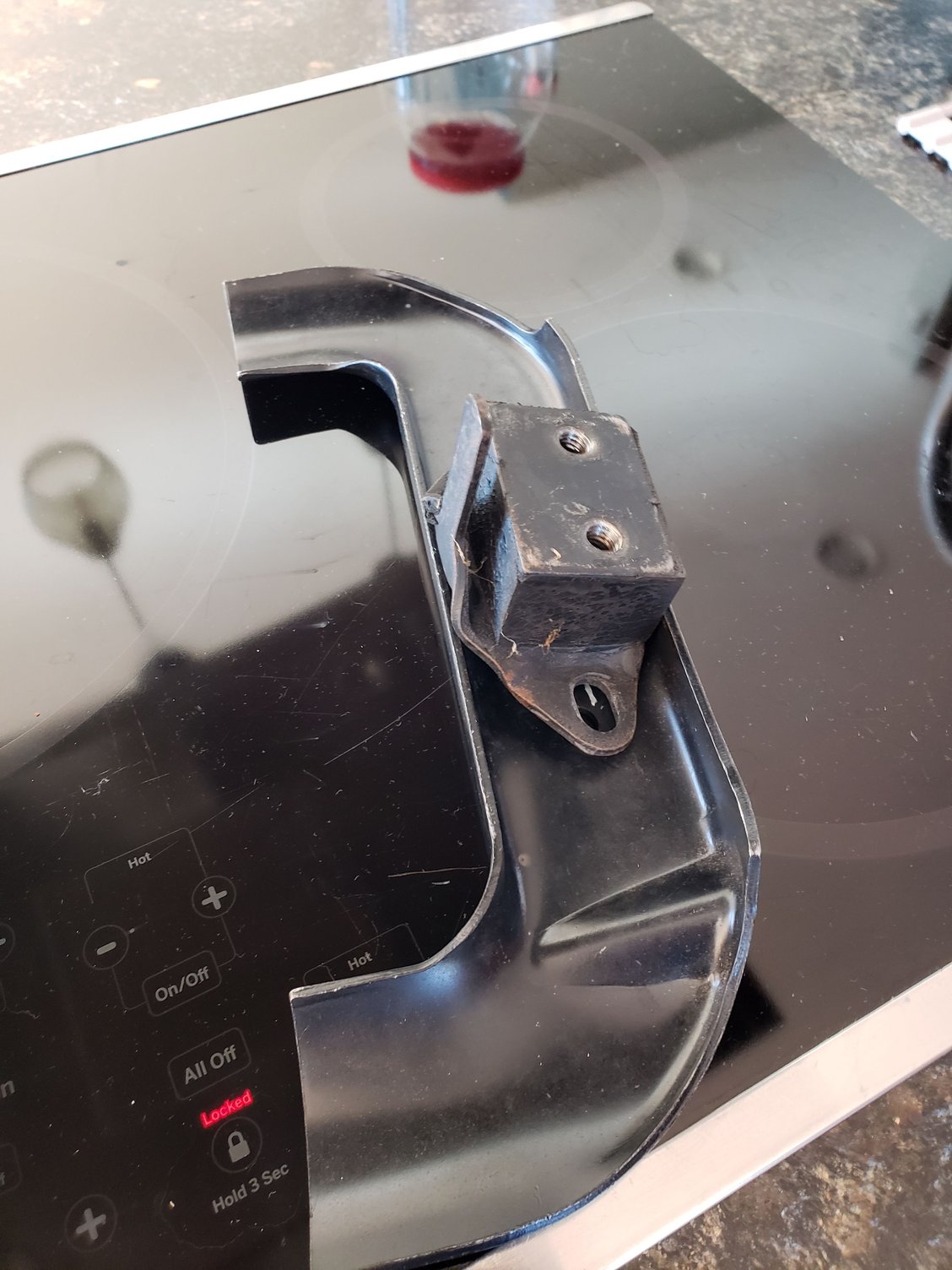

Anyone else run into this?
The front tab of the trans mount hits the center exhaust bracket. I confirmed the part numbers are coreect.

Doesn’t the mount go on the other side of the bracket. ? The mount looks different than most offered online

My tranny mount doesn't have that vertical piece on the side. You oughta go get another one and compare.
Neither the turbo 400 tranny nor the others look like that. Where'd you get it?
You can just go to your local parts store and pick one up.

Your thread is similar to this old thread , is that mount an Anchor from the local parts store?

You have the exhaust bracket upside down

The exhaust bracket isn't upside down, just the picture.
As said, that trans mount is strange looking. Sawzall off that thing that sticks up.

I looked a Rock auto and every one they had included that tag. Didnt make sense to me. I just kacksawed it off and everything fit just fine.

I see now , the big block mounts have the tab and the small blocks don’t.
