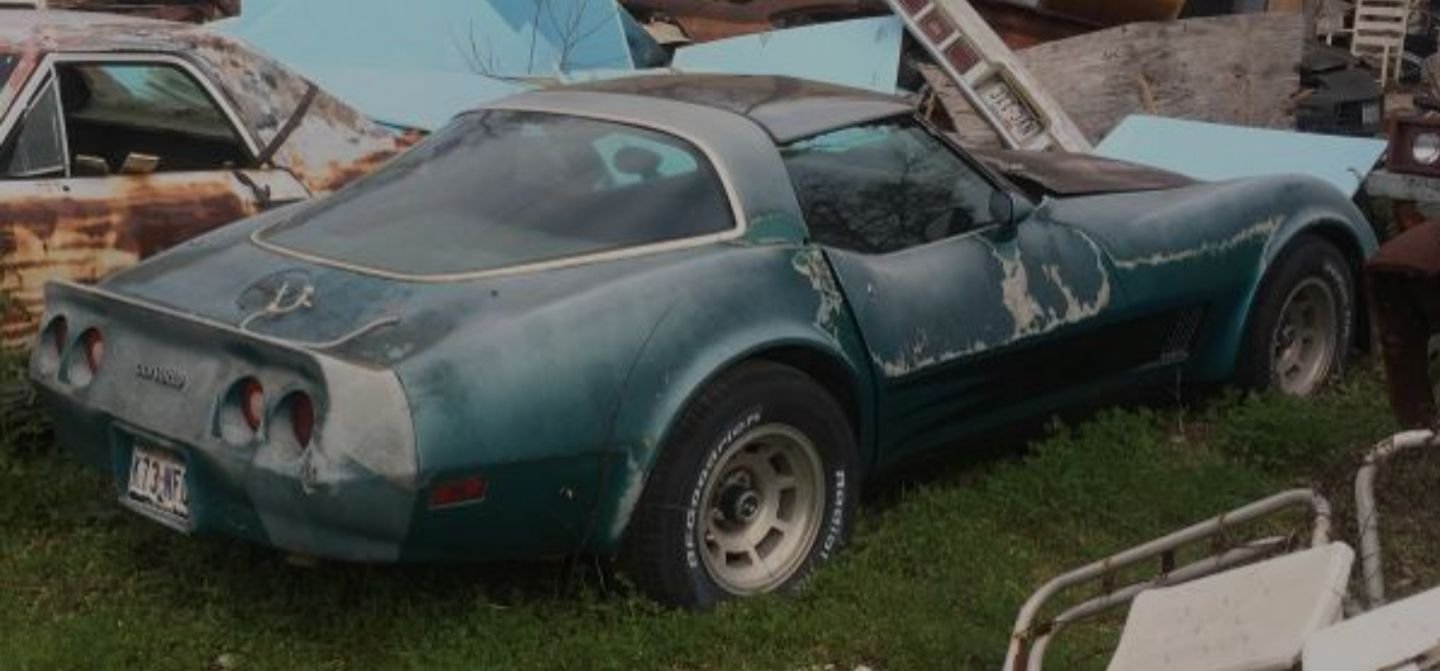

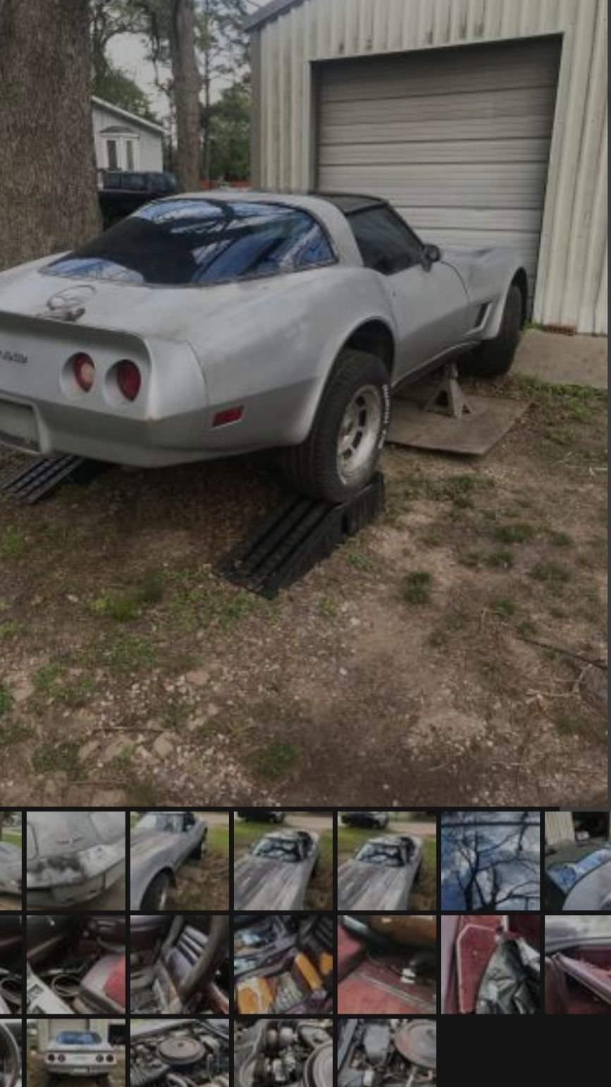

Depends,
The experienced "restoration" crowd will tell you to pass without blinking.
Car guys that like to screw with stuff will say "let's take a look".
Both vehicles are gonna be time and money suckers.
First and foremost, check the bird cage.
Pull the kick panels and look up into the A-pillars for rust. Small scale or patina- eh. Heavy rust scale or holes, probably should pass.
Also pull the upper windshield trim and check for rust.
Chassis rust is the next sticking point.
Same criteria, light rust, no biggie, heavy or holes, stand back and reconsider.
If the birdcage and chassis are in good condition, everything else is just time and money.
I bought my '74 a few years ago, and drove it until May of 19, when I incinerated the engine. I'll just say big ol homer Simpson "DOH", right here and leave it at that.
Since then, I have replaced the radiator, repaired the core support, rebuilt the front suspension, replaced the tie rod ends and drag link, adjusted the steering gearbox, re-bearinged the trans, and replaced third gear, replaced all u-joints, resealed the diff (I got lucky here as one of the PO's had the diff gone thru and it is still in great shape ).
I also rebuilt the trailing arms and re-bearinged the axles.
New springs front and rear, plus shocks.
The brakes were in great shape, so I didn't have to replace calipers, but I did replace the M/C, front crossover line and the softlines.
I bought all the door and top seals, plus door window stuff. Installing them this winter.
If memory serves correct, I have around 3k+ in parts for all that.
Plus a bunch of labor.
Add $600 for tires, and $400 for a four wheel alignment.
The interior is in decent condition, but I checked into the cost.
To replace the interior and recover/pad the seats was less than 4k.
It has 10' paint, but that's ok, because it still looks good.
I'd like to paint it, paint and materials are about 1500 from the local Finish master.
Fortunately I am able to do almost all the work myself. I had to pay for the alignment and tire mount/balance, because I didn't want to buy the equipment.
I did make my own bearing set up tool for the rear axles.
Now throw a complete engine into the mix, and there was another 5k. Probably could have found a 350 for cheap, but I wanted reliability.
Now, I have 18k in a car that right now, on a good day, might go for 10, if I'm lucky.
But, mechanically, it is new.
My mistake, was buying the car just as the bottom fell out of the C3 market.
Buy high, sell low, make it up in volume.
If you are looking for something to do, and you are capable, find a car that is solid, and go from there.
Just remember, it's a slippery slope when you start digging into your project.
The "while I'm here" bug can latch on, and then the money suckers turns on.
Make sure the car you buy, is the one you really want. They are difficult to sell (read "get your money back out") unless it is a bumper car or in excellent condition.
From reading what you posted as descriptions, I would say, be ready to start dumping coin.
I, myself, would not go over 1500, for either, since neither runs/moves. Less if you can negotiate.
Just make damn sure the birdcage and chassis are - ok.
Apologies for the extended post.
Good luck,
Jeff

Definitely do the rust checks suggested in the previous post! Say "no" to any that fail!
Presuming you have the tools and skills to do most or all of the work yourself and you're looking for a long-standing project and you have a garage/storage area to keep it while you work and are not concerned about keeping things original, then I suggest these as top criterion:
1) Do you personally prefer a manual or an automatic?
2) Do you intend to rework/replace the engine for a lot of power, say 500+ hp? If so I suggest the '80 as it has the heavy but extremely durable cast iron rear end while the '81 has a far less robust aluminum unit.
If any one of those things in the paragraph above do not apply then I suggest you look for something in far better (at least rolling and running) condition.

The 80 and the 81 both have the same Dana 44 aluminum rear differential with the "batwing" rear cover/mount. It saves a lot of weight, but is less robust. It is possible to create a hybrid with an iron differential and the batwing cover/mount.
They both have removable transmission crossmembers, though, which is nice. And at parts cars prices, you are 100% spot-on about about them being a clean-slate to do anything without having to keep it 100% original.
No rush on these particular non-running cars with bad paint. It's about to be a buyer's market for all non-essential purchases, including Corvettes.
