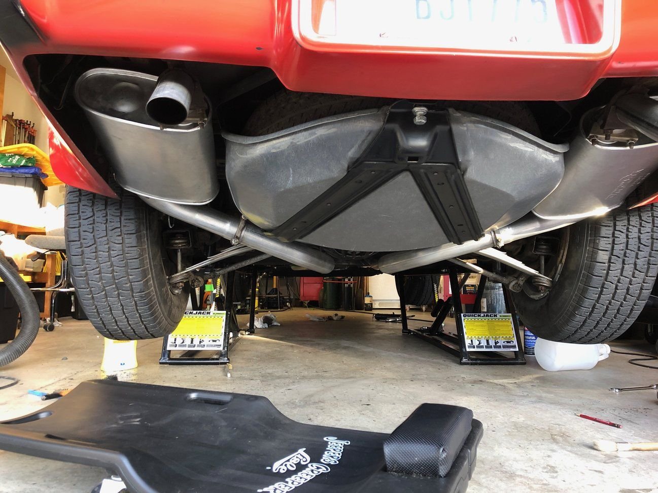

- recently I stripped off the paint on spare tire support brackets..(semi gloss black) and bare fiberglass someone painted silver.. looks great!!
I use laquer thinner , acetone, LA degreaser, wax and grease remover, toothbrushes and rags..in order of aggressiveness...
notes- the paint on trailing arm and spring and support bracket (basically anything besides the frame that was assembled from suppliers) is pretty durable and will hold up to fairly strong solvents.. I used them to remove spray bomb touch up silver and to go back to fiberglass..(wax and grease remover best to start with)
the frame rails and frame will absolutely come off even with a water degreaser..very poor durability.
I went commercial rustoleum (says not for home use) at lowes semi or satin cant remember.. dilute with acetone and used that to touch up any black with air brush.. bought silver but didn't need it as spring coating was very solvent resistant.
Used spray can semi gloss satin flat clearcoat do not remember to protect struts after blasting to original metal.. have not gotten to the half shaft until I replace something there.. lol..
pics if it helps..wish I had pre spray bomb..

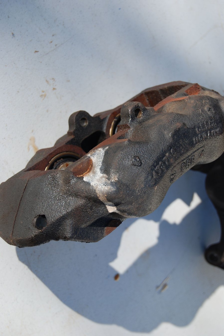

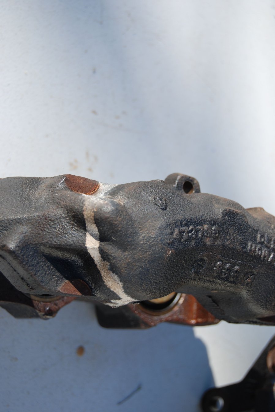

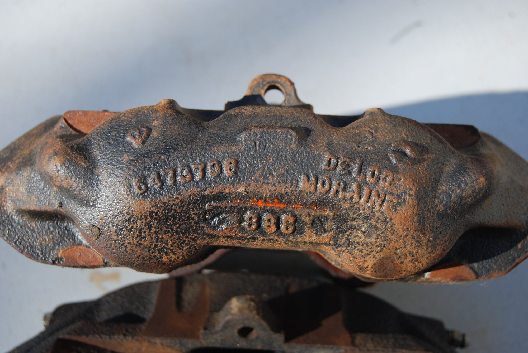

Here are the pictures of the calipers that came off of the 14 mile 78 Pace Car, before I sent them to Lonestar. As you can see, they are just as described in the NCRS Judging Manual, painted black, with the machined surfaces machined after painting, causing them to rust. A couple calipers have white inspection marks, two appear to have light blue marks, and the last one seems like it might have had an orange mark. As I said in my previous post, these are from a 78 Pace Car that was never sold by a dealership in Delaware. This car is well documented and pretty well known within the Corvette community, including by a number of members of the Forum.
Black Painted Caliper with White Inspection Mark
Black Painted caliper with White Inspection Mark
Black Painted Caliper with Light Blue Inspection Mark
Black Painted Caliper with Light Blue (or white???) Inspection Mark
Black Painted Caliper with Orange Inspection Mark (?)
Caliper painted black before machining process, leaving the machined areas bare and prone to rust

edit...i found a before shot of po spray bombsilver
Solvent starting to remove spray paint off bracket..silver over fiberglass came off too

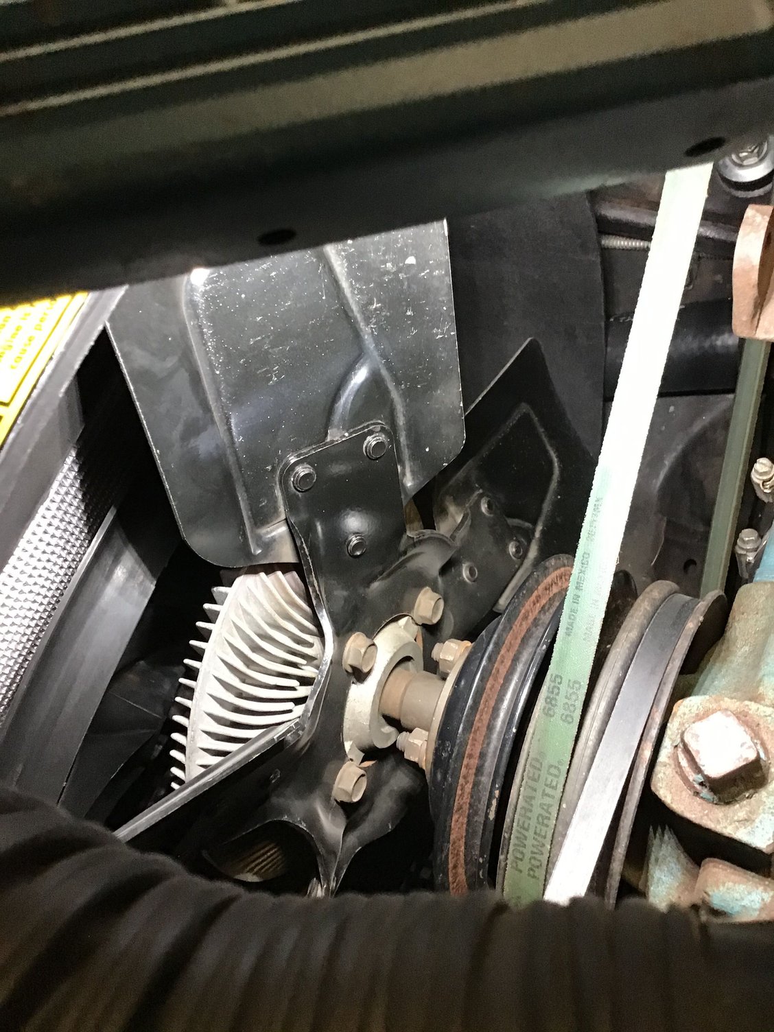

but it sure seems that the power booster on my 79...and some other research on bone stock show a yellow chromate?
also the fan seems midgloss but ill polish a blade and see..
the shocks i replaced were dated original and were black..i almost kept them but tossed em
edit..added fan..i guess you could say high gloss but more of a 60 gloss imo
Polished up a spot near center..

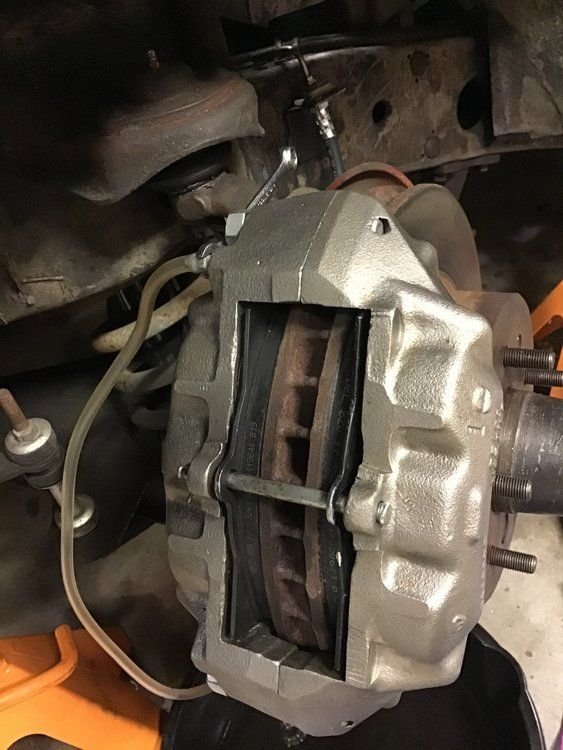

Sorry for the follow-up delay. Decided to stimulate the local economy via a trusted local shop that specializes in Corvettes. I don't push them for time. Gave them Delco professional suspension and steering parts to hear, "You made this easy." Will have a number of hours next week for underneath cleaning while it's on the rack and will provide photos.
As an aside it seems that Delco "professional" grade tie rod ends for our cars have been discontinued. I got three of them with no problem but the fourth has been a pain! After three weeks of waiting with numerous cancellations from typical suppliers I finally found one that was obviously older stock as the box is completely different.
