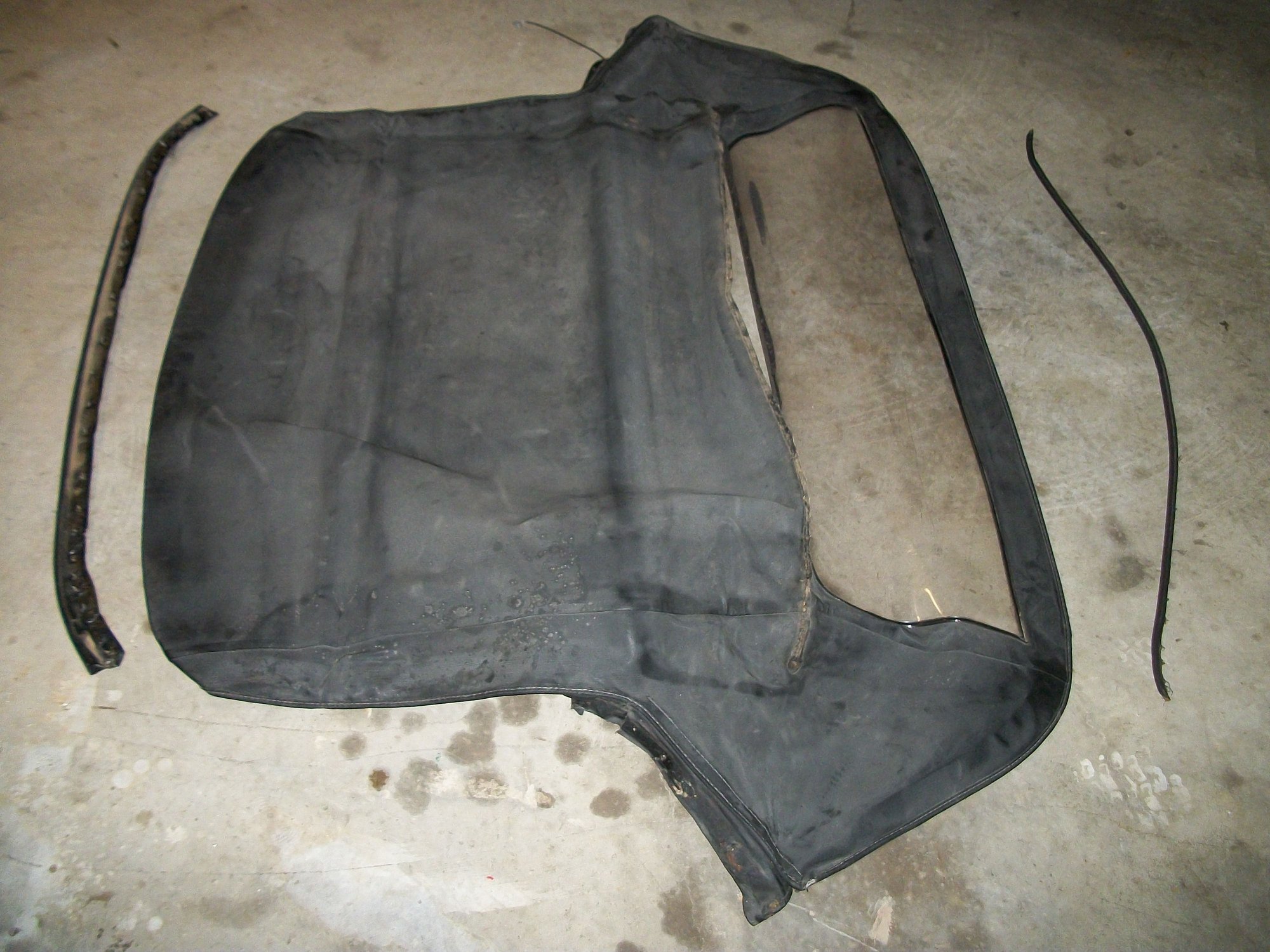

Hope everyone is staying in and safe, if you can. My '72's top is the original and in great shape, except for the back window. Over the years, it yellowed, then completely fogged, and then shattered into many pieces. I trimmed all the remaining pieces off the top and was wondering if anyone has ever attempted to put a replacement piece of plastic in one of these? I found a source for the plastic, but didn't know if anyone has tried this. Comments and suggestions welcome. Thanks.
