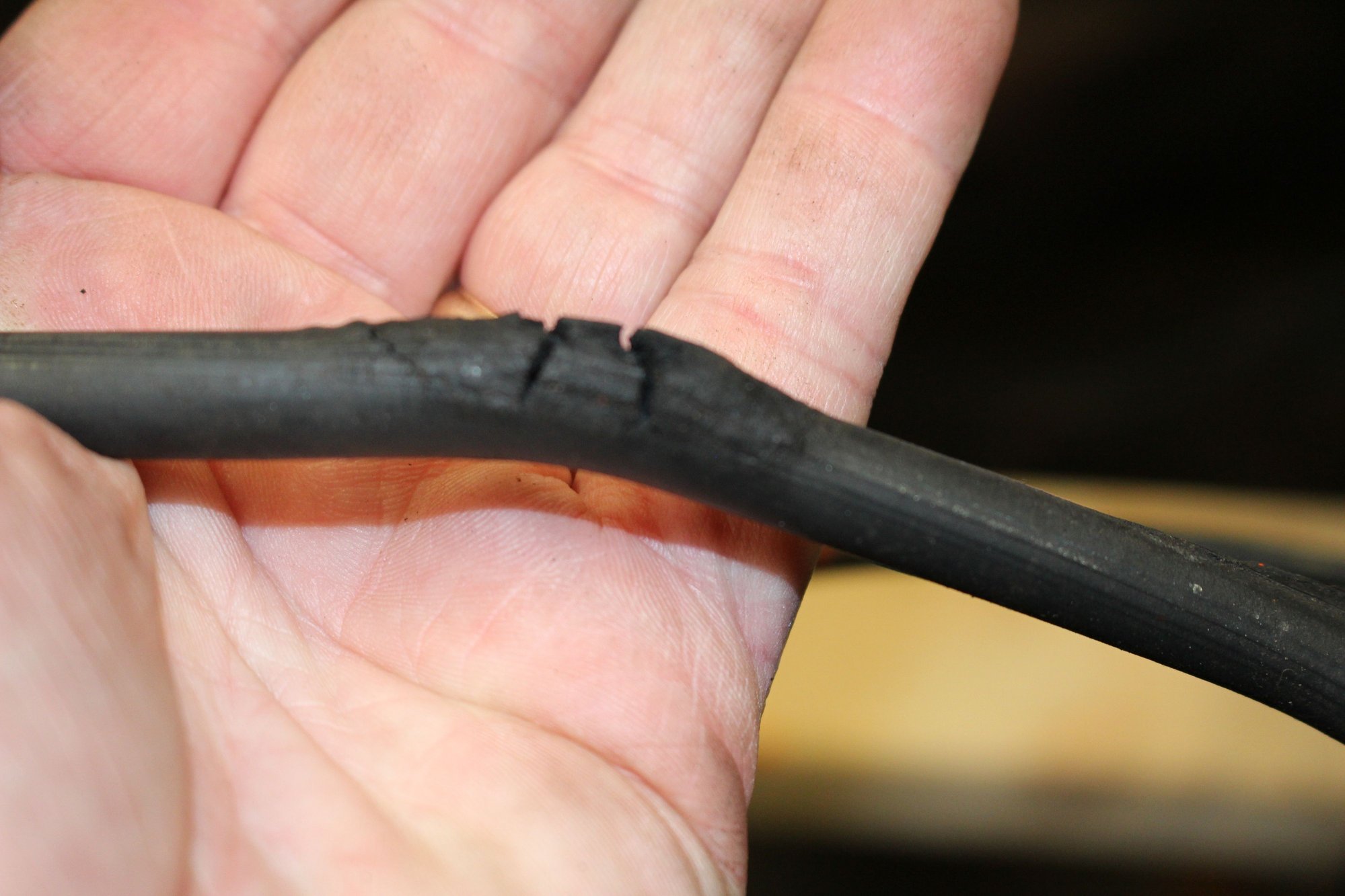

As I continue the dismantling of my car I found this main vacuum line "leak" behind the cylinder head. And the funny thing was the headlights still went up & down pretty quick! Well at least one did, one was slow. I was just amazed they worked at all!
So that got me thinking:
It just might be a lot more "robust" than the electric headlight conversions give it credit for, if it can still work with that leak..
So my question is:
Is it a lot of trouble to restore this system and get it working as-well-as-new again?
Are the problems due to complexity, troubleshooting or part quality issues?

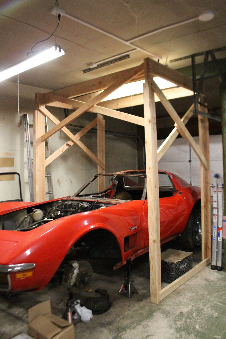

Leigh, what ou lifting body with?......
That would have been simpler if I had the room. But I built one out of wood so I could squeeze it into my 2 car garage with a 9 foot ceiling. I may even use it to store the body up in the air above the frame. I am still contemplating how much of this bumper, headlight and vacuum stuff I can leave on during the lift.
