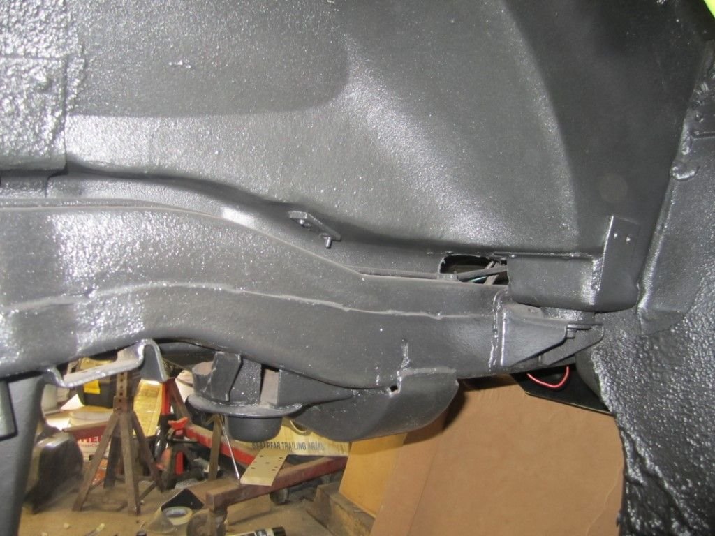

On mine, you can see the plate inside the rear wheel-well
If yours is the same poke an awl up through the holes to mark where they go.

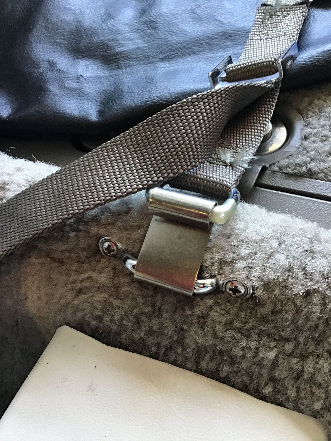

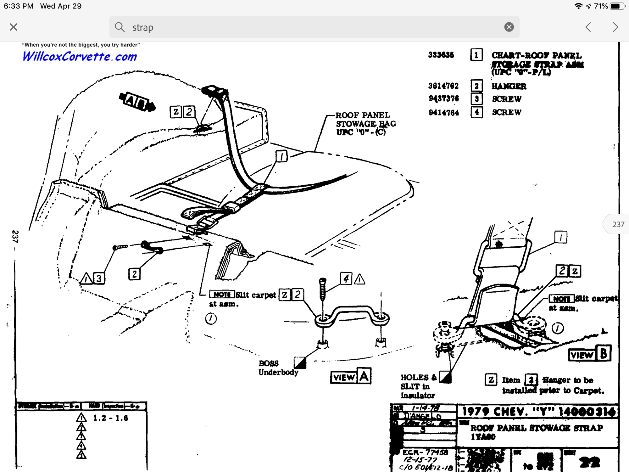

This help? 79
Looks like it hooks in there

Unless it got changed in later years, all three of the tie-down anchors were mounted on top of the carpeting.

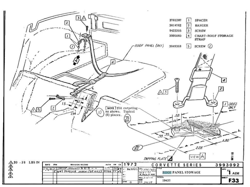

The few references I've seen seem to match the image up there for the later cars, (probably 78+ ?) where the rear two were under the carpet with a slit rather than like ours sitting on top.
M

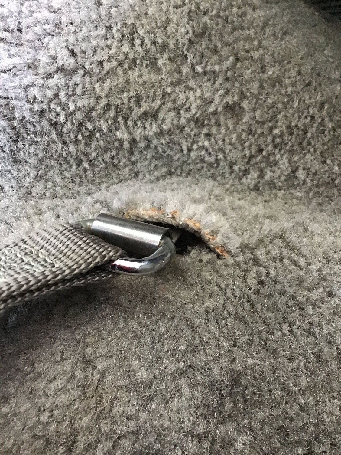

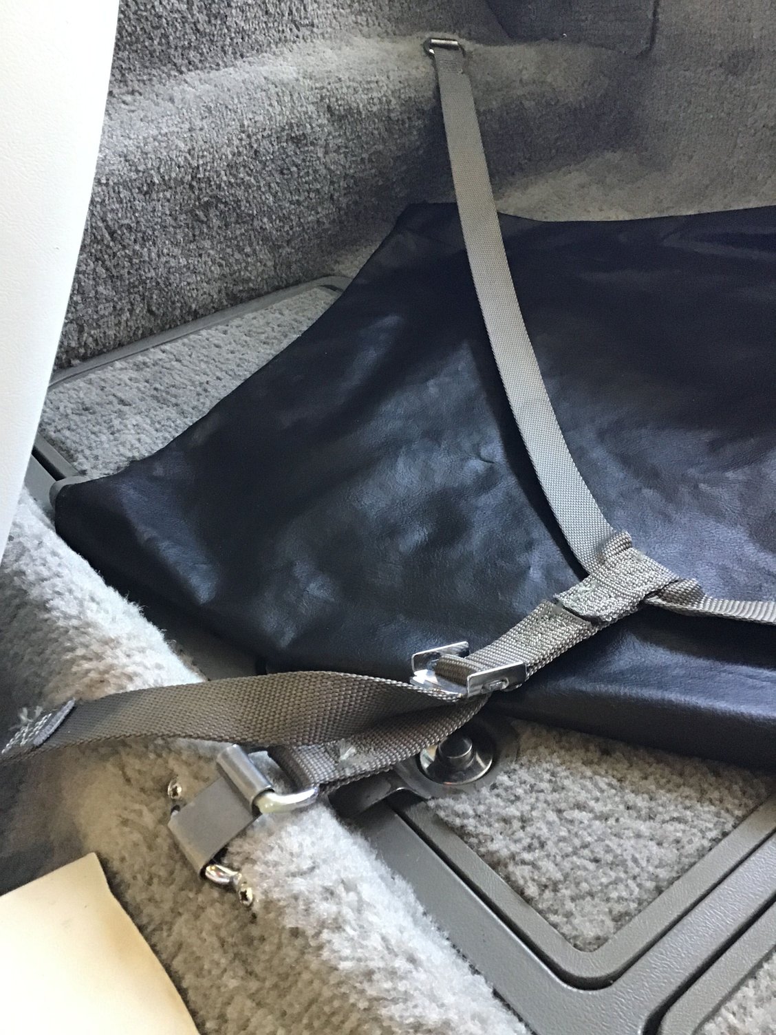

If those later cars have the same 2-screw hardware as the front piece, hard to understand why GM would choose to slit the carpet. I sure wouldn't put it together like that.
it appears that it hooks under the carpet not screwed
It hooks into bar

Originally Posted by Mooser
I totally agree and don't know why the carpet wouldn't move all around without them screwed through it. Only going by what I've seen. Buddy of mine has an original 80 he bought new, never touched inside, I'll have to check someday.
Anyone with an AIM out there lol
M

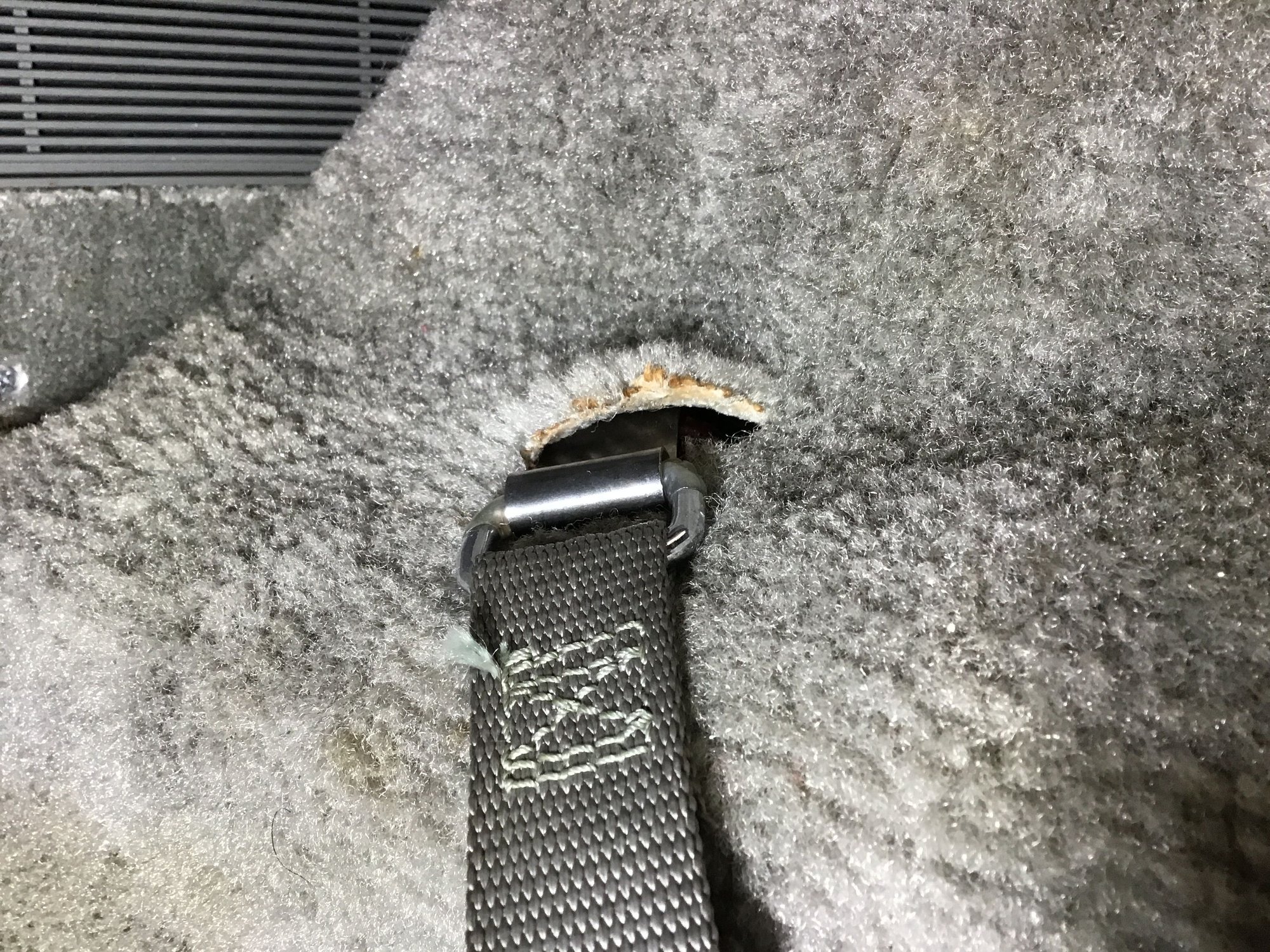

body hook...let me know if slit or is the hook to be exposed...pretty sure mine all original
Old Apr 29, 2020 | 06:54 PM
Mooser's Avatar
Mooser
Joined: Apr 2011
Posts: 11,183
Likes: 3,335
There you go, slit
On the older ones it was on top
Don't know when it changed, I would guess 78 when the rear compartment changed a bit but I don't know, that's only a guess
