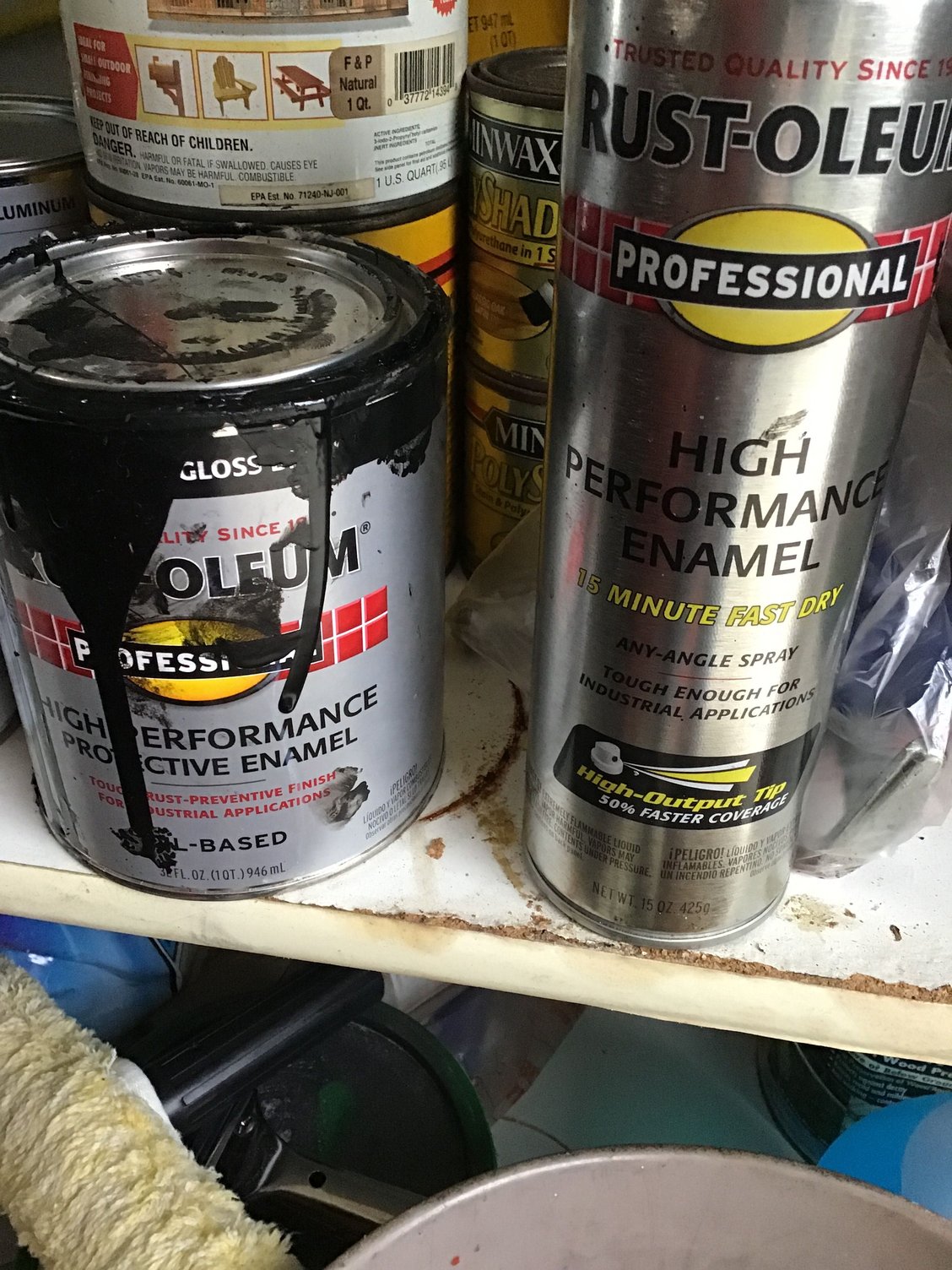

It is a brand here made by rpm industries..yes there should be spray bombs available...
note, this is an alkyd based paint..would probably stick..
what polyester are you talking about?
i would suggest any acrylic solvent paint that states for multi surfaces..cleaning critical...
most home improvement or walmart auto store should carry
SEM brandseems pretty good for plastics and flexible primers
you can also dilute almost any material and spray..just use recommended solvent, i use rustoleum commercial and dilute 100 percent with acetone and use airbrush for frame..other areas..easier to control

I use this available from hardware..i dilute 100 acetone to spray non spray can semi gloss, says commercial use only not for homeowner lol..probably lots of voc
