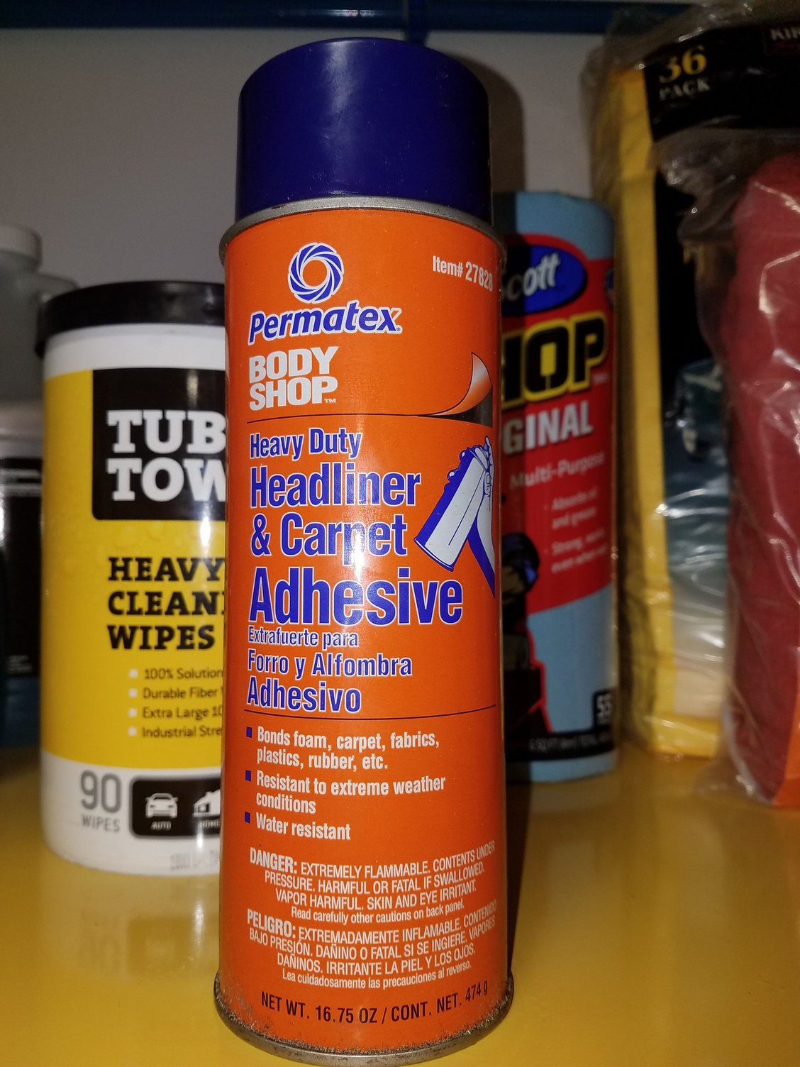

Originally Posted by Big2Bird
Not too heavey. It can bleed thru.
I found it to work the best.
