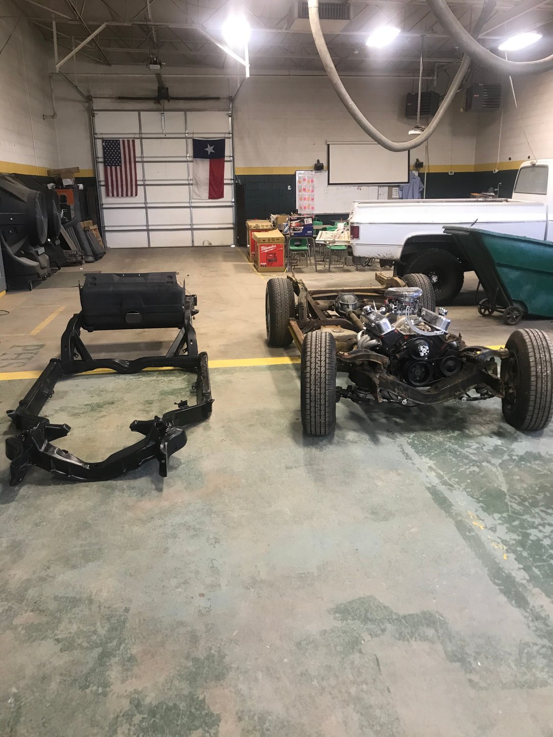

So I am a teacher/football coach/strength and conditioning coordinator here in Texas. With the schools being shut down at least through June I have quite a bit of free time. We have a huge garage, and I pick up the new frame on Wednesday. I have everything ready to lift the body now. I have all parts for suspension ready to go so this week's goal is to get new frame painted, and the rolling chassis ready to go. This will be a long term project, but I feel that a conservative estimate is that I can have it running by the end of the summer. Most of the money that I will be spending will be on the odds and ends to replace worn cosmetic problems. We have a storage building out back that is housing interior and final assembly parts.

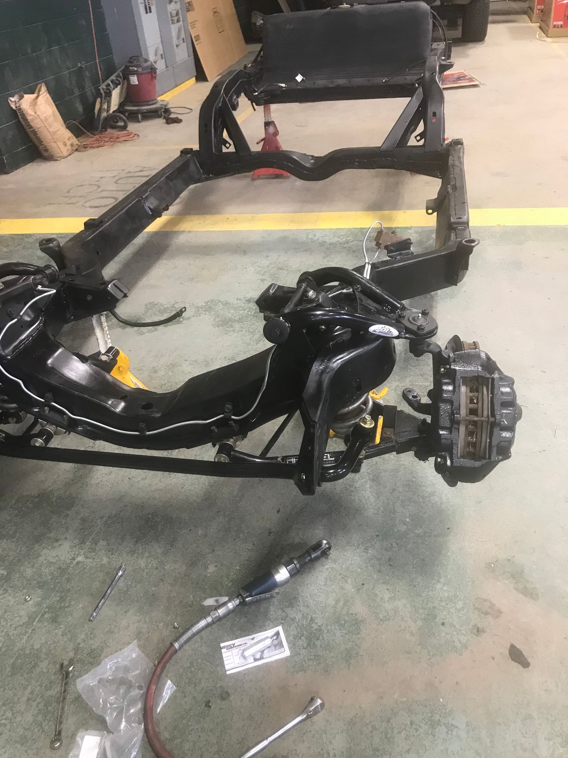

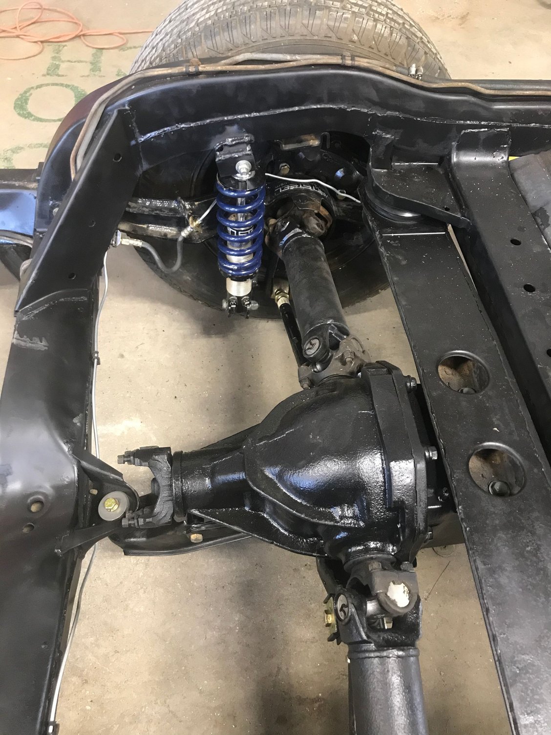

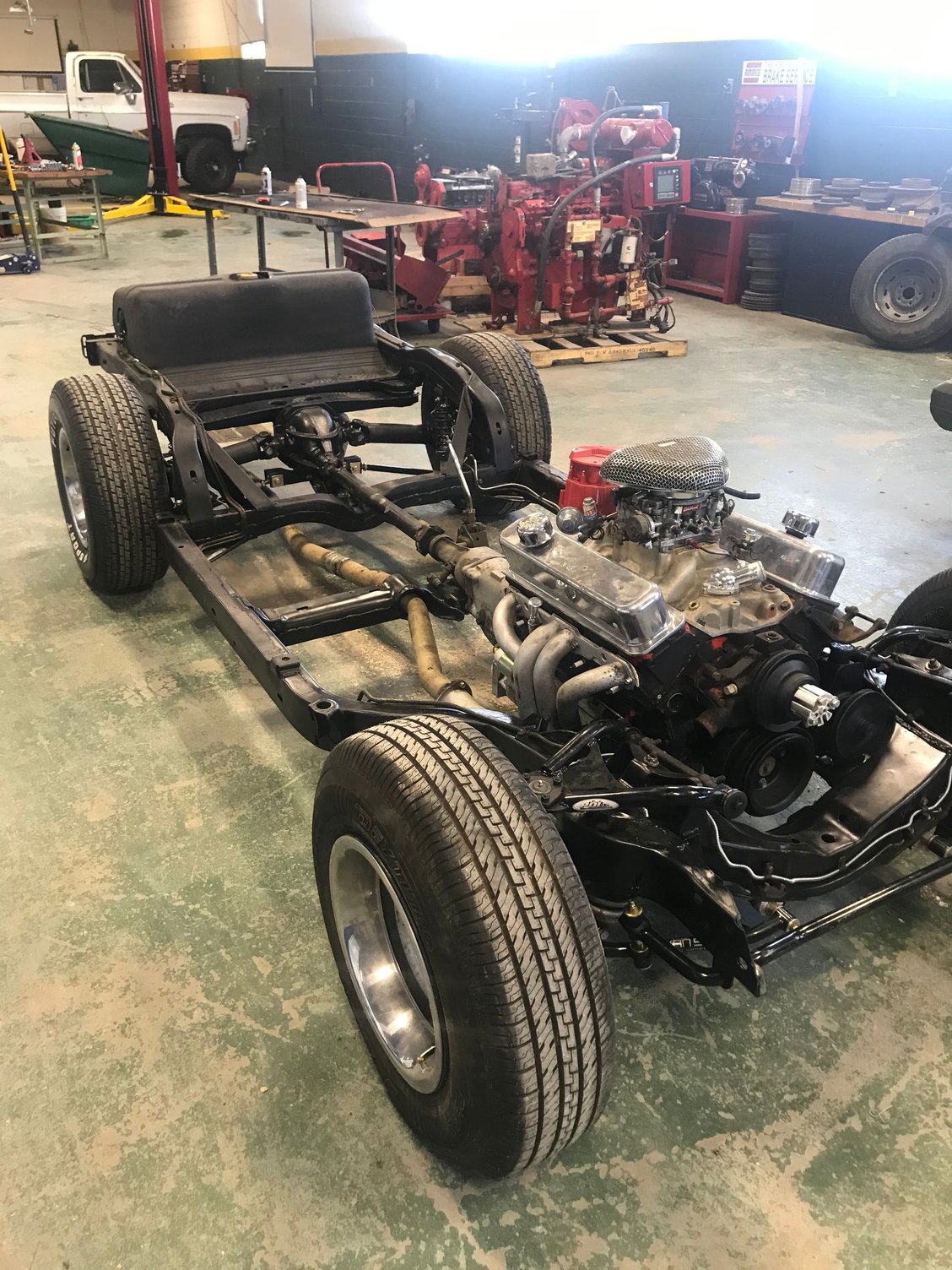

Default Update on frame swap.

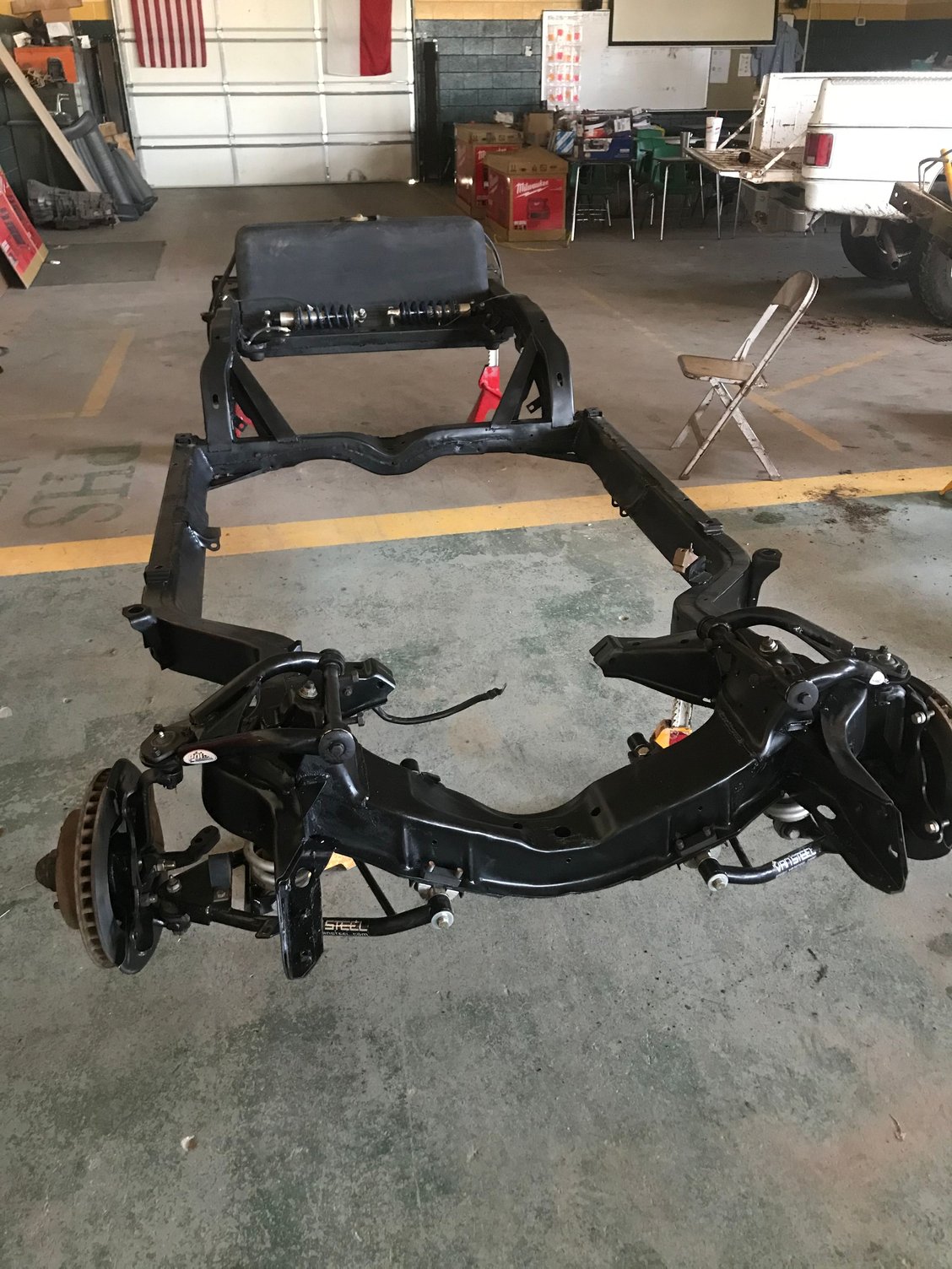

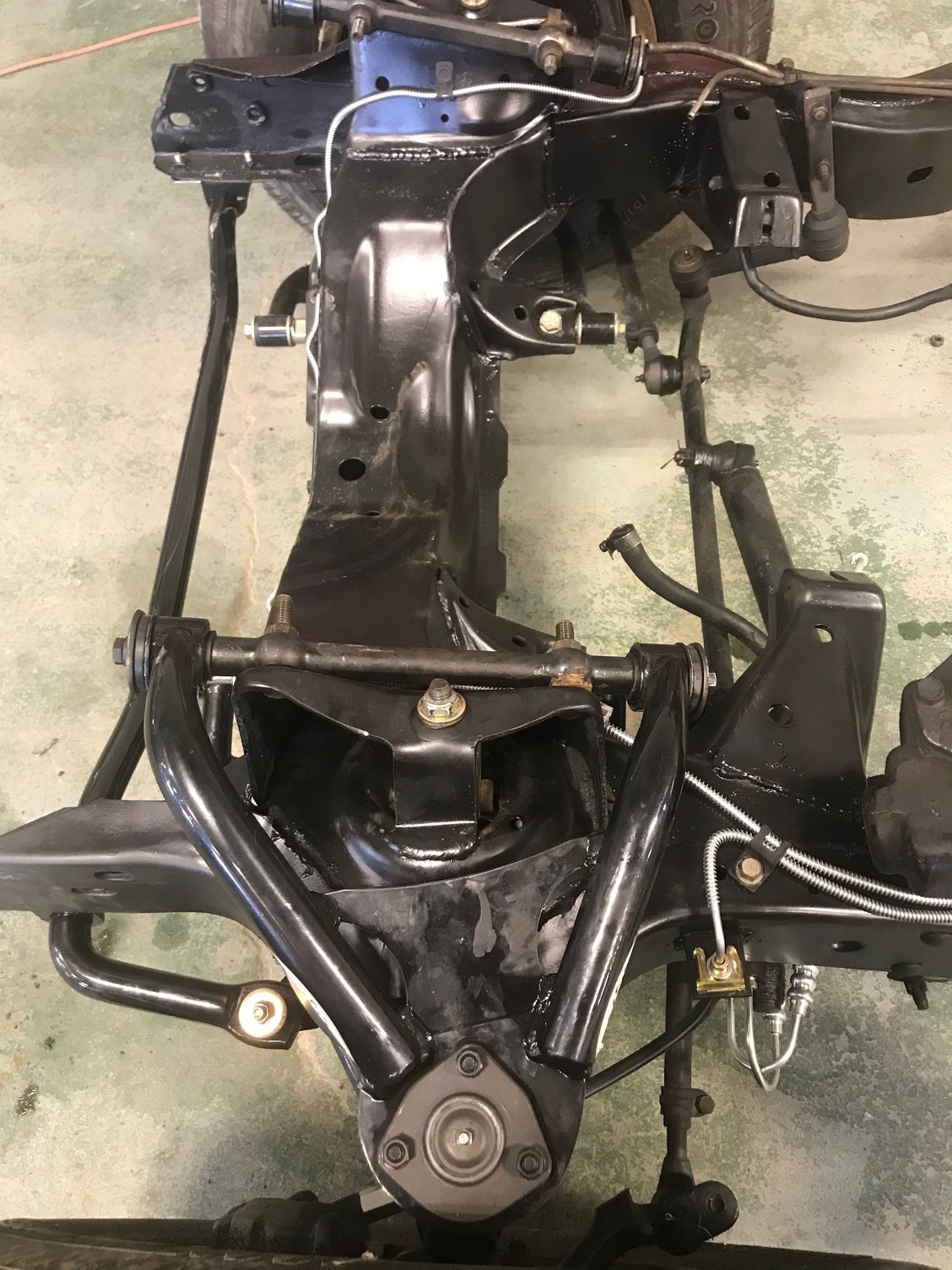

So I got way behind on this project. A friend roped me into doing an engine swap in his f150... but I am finishing up the rolling chassis tomorrow.

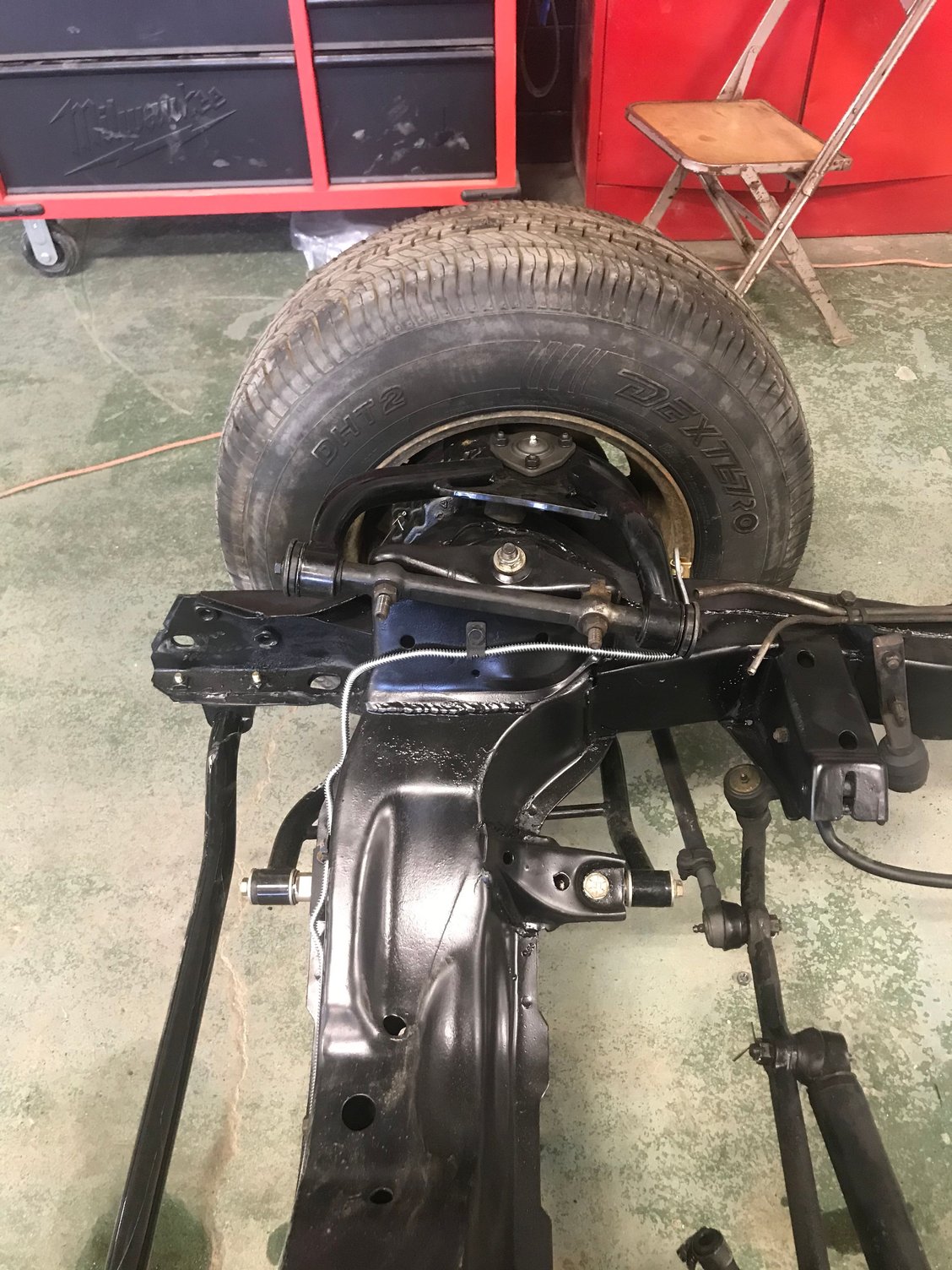

Got the new frame prepped and about to start moving the good parts over.
Vansteel lowers and QA1 semi coil overs. New ball joints upper and lower. POL upper control arms with 6 degree offset. 1 1/8” Vansteel sway bar, corvette America stainless brake lines. New hub bearings. Rebuilt factory calipers. New bushings everywhere.

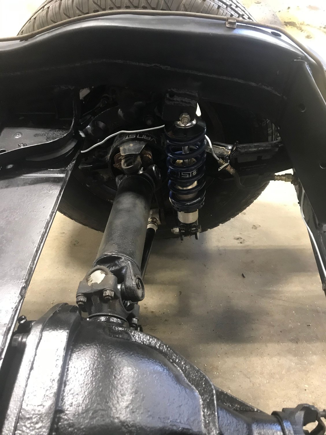

Vansteel offset trailing arms, QA1 coil overs, new hub bearings, spicer u joints, all new rear diff guts. I’m starting with .383 gears behind the Muncie 4 speed and 383 stroker. All new bushings, bumps stops etc.

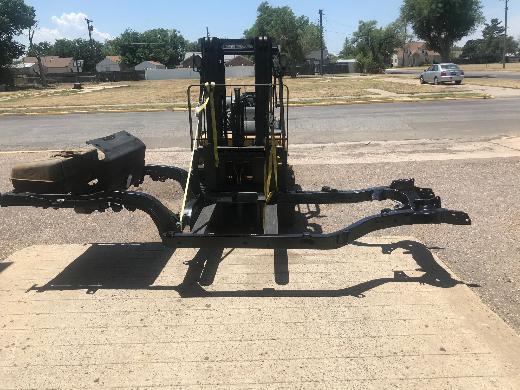

yeah. he got screwed in this deal. "C'mon. it's not that heavy! LIFT!!!" Now. body off. do you know how the birdcage is? body mounts 2-4. you ain't putting a wrench on them and unbolting them. not all 6. cutting the heads off the bolts that spin is a PITA, but less so than any alternative. are mounts 2 and 3 good on the new frame? you put a bolt through them to check? the cage for mounts 4 is a sheet metal convenience item for assembly line. they will spin on you. after they spin, cut heads off bolts and punch the cage out from below. don't replace it. have a buddy hold a wrench on the nut when installing body on the frame.

Sorry, I forgot to mention the body mounts. I also replaced the #4 on frame body mounting brackets. There was a little bit of corrosion. I replaced both of the #3 body mounts. The #2s were in great shape. The drivers side #3 came free. The passengers side #3 I had to cut. There was a small bend in the corner where the drivers side #3 mount was. It was not bad but I figured I should repair while I had the frame out. I split that section of frame and repaired the internal brace and put it back on. Used a diamond pattern on outer shell of frame to eliminate a 90 degree weak point (left the inner 1/2 intact. I measured everything diagonally from point to point on the frame and it is true. there was less than 1/4" difference between the Control arm tower and opposite rear trailing arm mount on both sides.

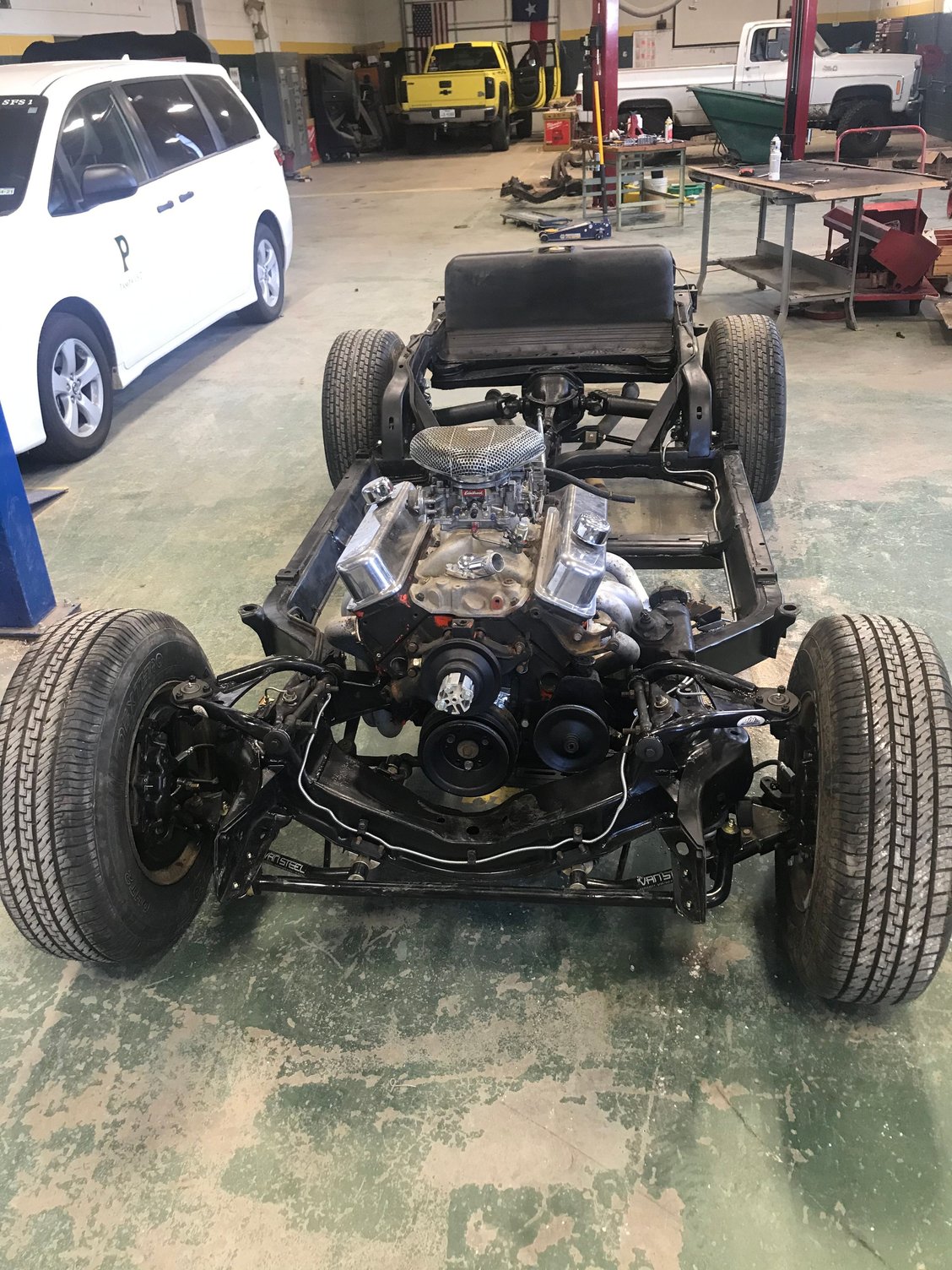

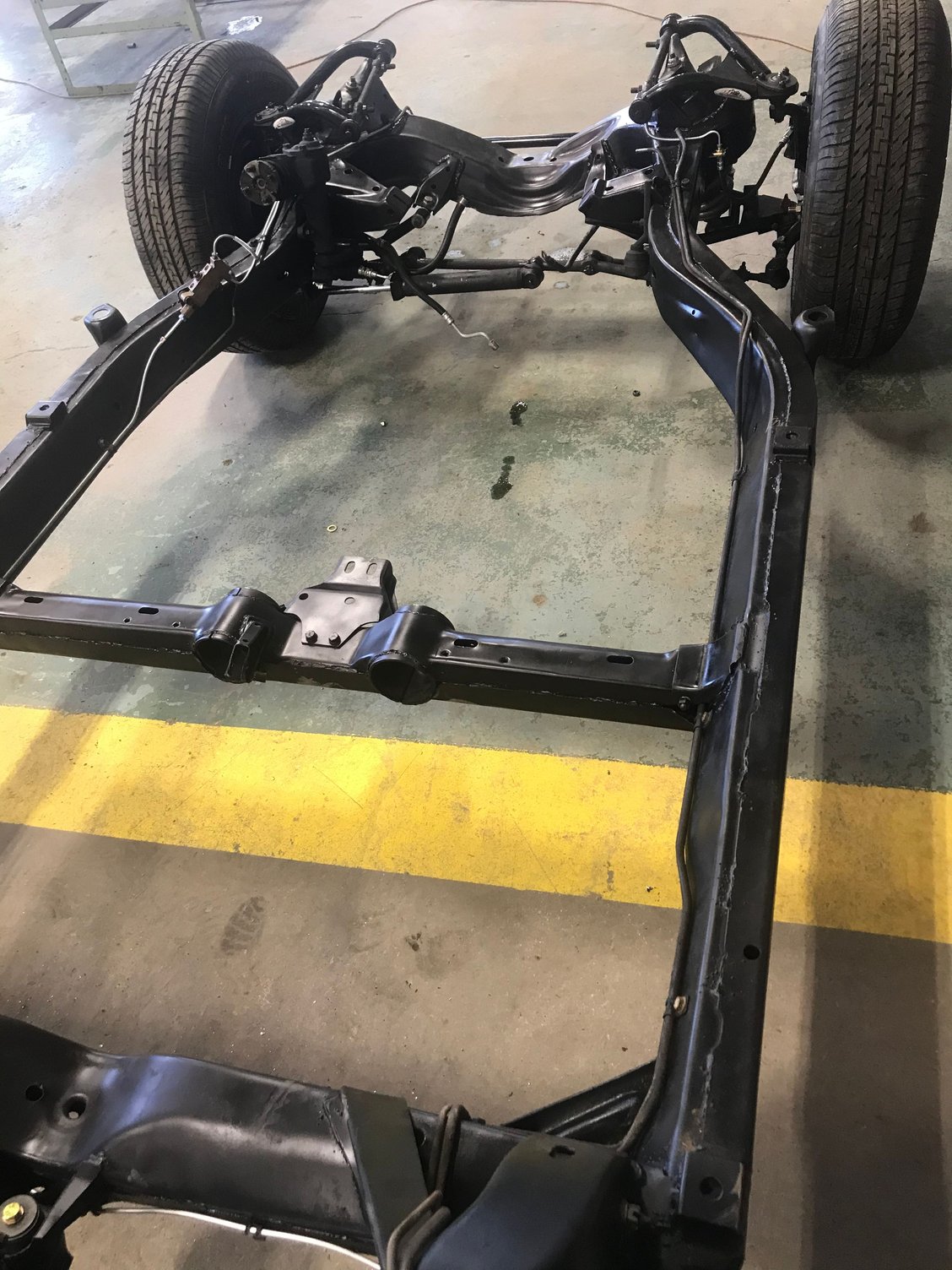

Default Finished Rolling Chassis
After it’s driving I’ll make some more upgrades to the motor, but it’s fresh and strong. Time to start the body work. Wish me luck.
