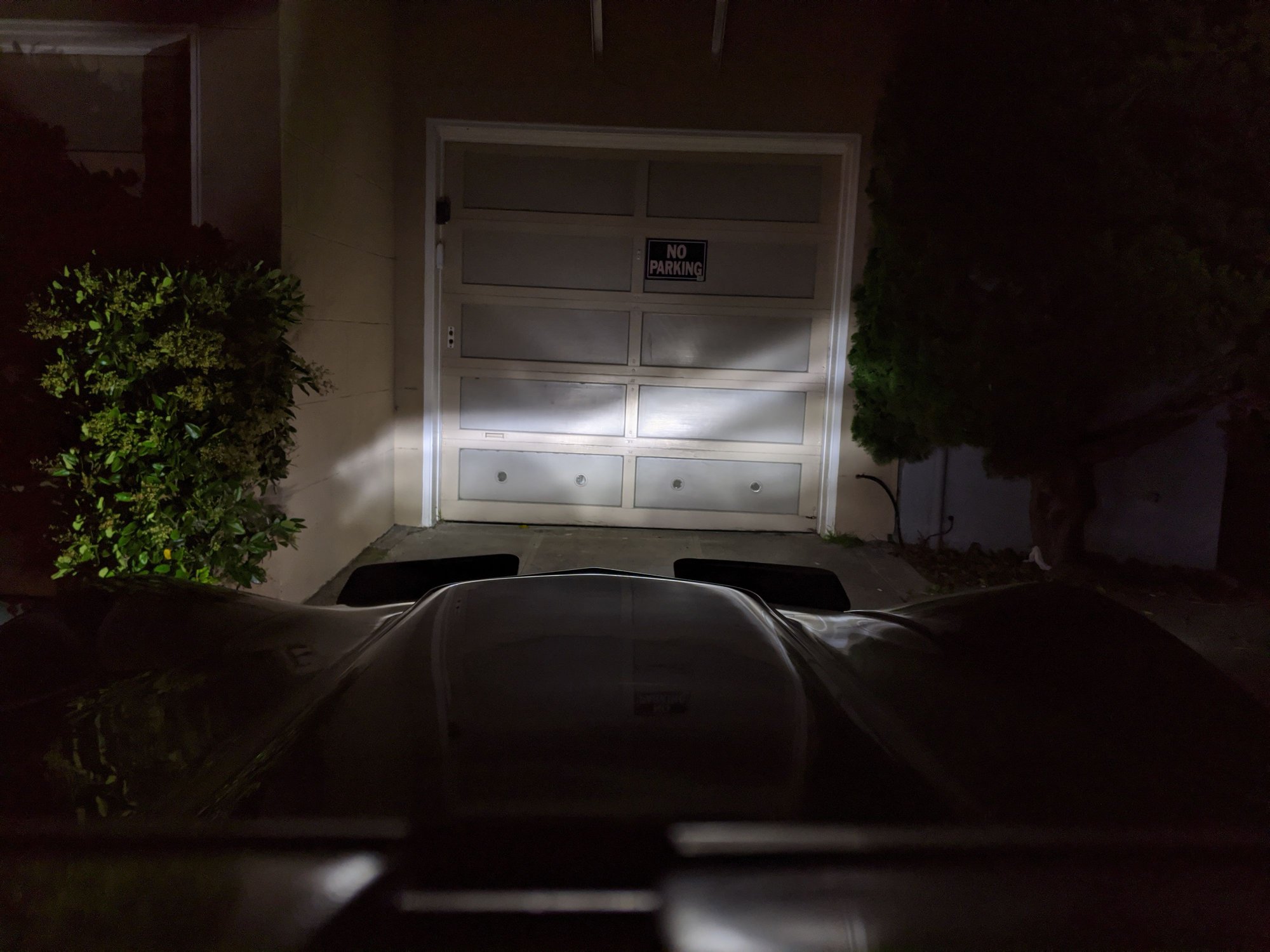

Originally Posted by jokeitch
update: got it out of the garage finally
this is the pattern after adjusting the lights a bit so the beams are overlapping properly in the vertical and horizontal
i don't have access to a nice flat wall with 25ft in front of it, which is the proper spec to aim headlights, so i don't have it exactly right yet
but it looks pretty good. No blinding but nice and bright
Thanks for the followup.
Can you compare between the stock OE glass type housing VS the clear as far cut off and usability, as I see you purchased both? Did one preform better? do you have a preference? I'm ready to go ahead and order housing.
Also, I'm still debating on going with the cheaper halogen set , and refill with the better Amazon blade led's you purchased or go with the Octane 4000 lumen led set (4 sided). Do you still feel it was worth the added cost for the blades when comparing your results with the other posted patterns?

i broke one of the oem glass ones and the headlights are already closed up for now :/
if you see the beam patterns i posted that should show a good comparison, since this pattern i'm seeing is really similar to the 3 feet away pattern i saw
if by the 4000lm set you mean this one
https://www.octanelighting.com/5-34-...-g5-led-2.html
i woulds steer clear, those multi faced led bulbs really screw up your beam pattern since the light is very dissimilar from the filament of a halogen bulb
the amazon ones i got mimic a filament really closely

Thanks, I'll go with the same amazon blades you bought. Did you have to mod the c3 buckets for them?
Now I just need to decide between the stock looking glass housing or the clear. I like that the sock looks original ( until they are turned on)

no modification necessary, they dropped right in no problem.
you'd probably fine with the oem glass look, i just prefer the clear look
