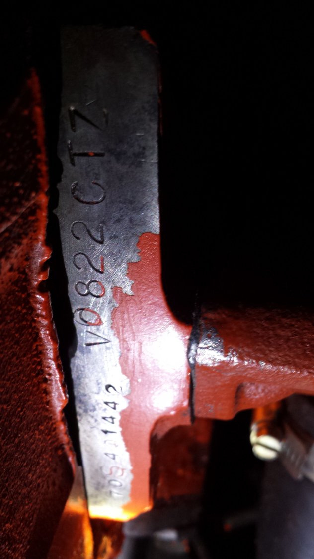

This is from a 70 lt 1 that my brother is looking at I say no good input please

I would say there is no way in hell that's real. Originally each stamp was done with a gang stamp (one at the engine plant and one at the assembly plant) and should be in a straight line and evenly spaced as it was done by inserting the correct letters and numbers into the gang stamp and done all at once. The stamping probably won't be exactly parallel with the edge of the pad but the stamp lettering itself should be straight. That is really crude and looks like someone made a total mess. It would be worth more without any stamp as it looks like a really dumb attempt to fool someone.
I have the idea you already know this Forman and are just asking for opinions to convince someone else

not a very good pic of the stamp, if its strong LT-1 money than i would be suspicious of the stamp.

If you enlarge the image you can see how poorly the stamp characters are aligned.

He passed on it ,, next

That one looked like it came out of the 1975 NCRS manual!

I guess it is a good thing for us that people are so lazy at restamping, but I cannot figure out why someone would not invest a few dollars in the correct set of steel stamps when restamping an engine.
They are trying to fake a serious dollar car, and are not willing to invest a hundred dollars or so is the correct font steel stamps.

Looks like Stevie Wonder could tell is a bad restamp.
