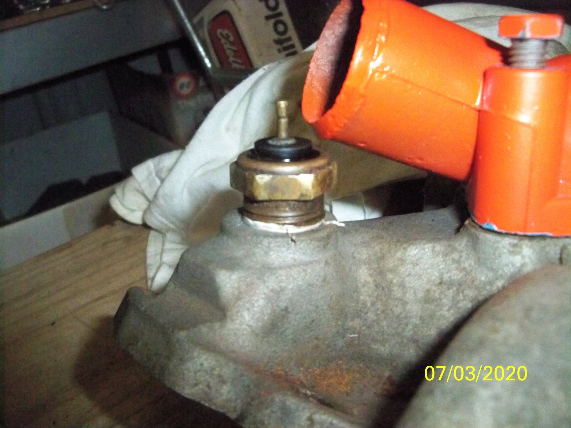

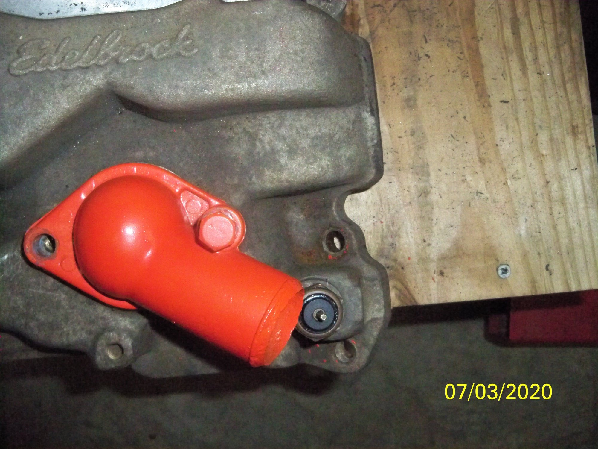

Default Forgot the "mock up" pictures
Even if I could fully seat the temp sensor I wouldn't be able to attach the connector.
Ideally, I think, I need to use a water neck that points straight forward or at least gets off the sensor.
But then I would need to find a upper hose that will work without causing any other issues.
I'm trying to find an "elbow" that will fit.
These days it is difficult to drive around looking for parts.
Open to suggestions.
Thanks

In this case, I think Id either put the sensor in the head, or get a thermostat housing with a 1/2 npt bung in it.
