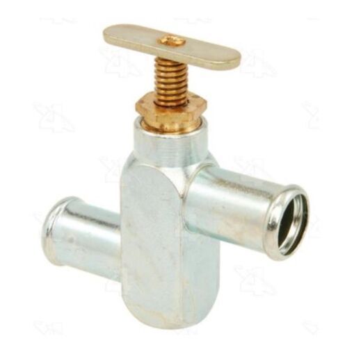

I also noticed that putting the valve close to the firewall works better than at the front of the engine area. That long section of hose around the engine would still get hot and conduct heat into the heater core. Also I am going to put a valve on the return line as that hose also gets very warm even with no water flow. Here is the type I used....two different sizes are required for my car as the hoses are different diameter.
Heater hose shut off valve
