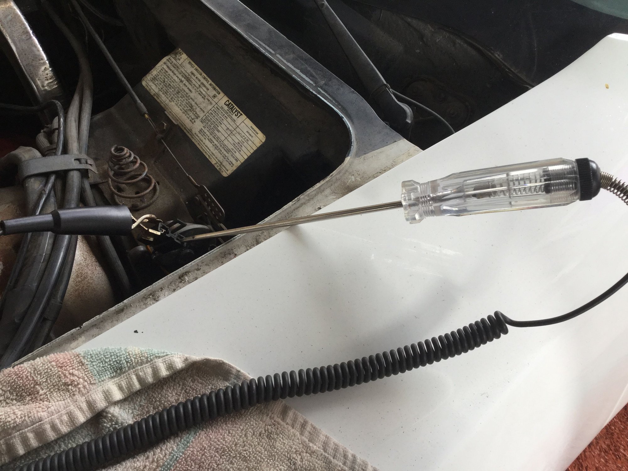

went out sore back and all...no multi meter but jabbed BLACK wire near pump motor with probe of Test Light and with key on and when put contact wire on Tester to ground, light lit but pump still did not run. Doesn't that show pump is getting power and should run when grounded? Could new pump be bad...not looking forward to going through that mess again.

If you have a third hand, have someone press the turn signal lever in (washer mode) and test light between Yellow & Dk.Blue wire. Your test light should light up.
Clip one end to Dk.blue, probe end to yellow.

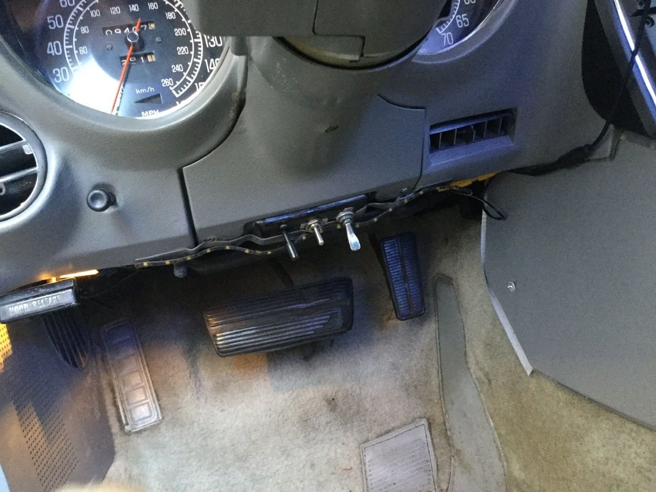

Test light shows power to pump but column switch not grounding pump. Didn’t want to do it but added a switch under dash and that took care of that problem. ....but still have to take tank loose to tighten up pump because it is leaking...damn, more fun
Switch on Right is for pump

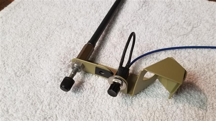

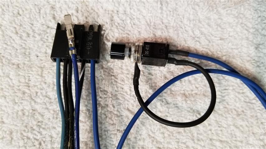

A friend of mine also has a 77, same problem. Found the Dk.Blue wire at the switch broken at the eyelet.
He didn't want the trouble with pulling the column apart so I came up with a little different location to mount the switch.
Knowing the speedometer housing has a ground wire to it the reset cable too should be a ground. So I used the reset cable bracket.
Looped one side of the new switch to the bracket and crimped the correct connector to a short length of Dk.Blue wire.
Removed the Dk.Blue wire from the switch side at the connector and inserted the new switch wire.
