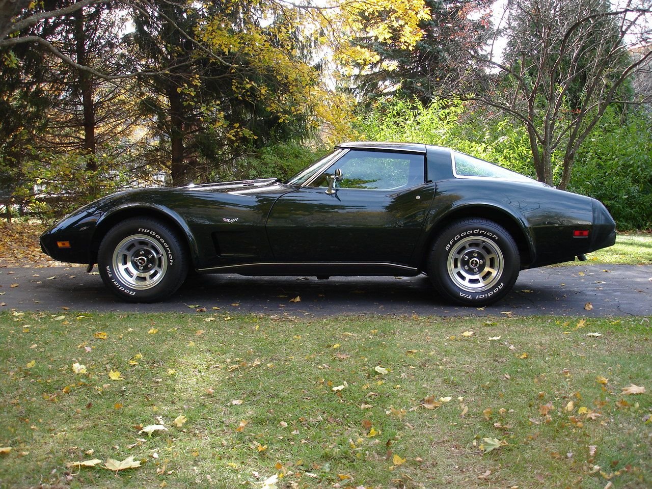

I believe good tires are so important I just won't scrimp on them. I've run BFG tires for years on all of my Corvettes, my truck, my wife's cars, etc. Always found them to be the best bang for the buck. Goodyear always made a good tire but you paid a lot for their branding/name so it was hard to justify their extra high pricing. Michelin always made a top quality tire but not too much for the RWL muscle car crowd. Firestone simply had too many problems over the years from the separation problems with their 721 radial to the major issues with the Ford Explorers. I would never buy their tires.
All that being said, I too have had issue with the brown lettering. I had a set replaced on my last Corvette by BFG without cost, which was nice but they still have not addressed the problem. And they DO have a problem. It's really a shame because they had pretty much captured the entire market for every muscle car era vehicle out there. Maybe they got the attitude that "we're just too big to fail" but then the public (us) wised up to their bleeding through issues and stopped buying. Nothing worse than a beautifully restored Corvette (Mustang, Chevelle, GTO, etc.) fully detailed at a car show, sporting brown letters. I would never let that happen. Buyers were very vocal but BFG wasn't listening, so people started buying elsewhere. This gave some of the budget brands a boost and some more visibility in the market.

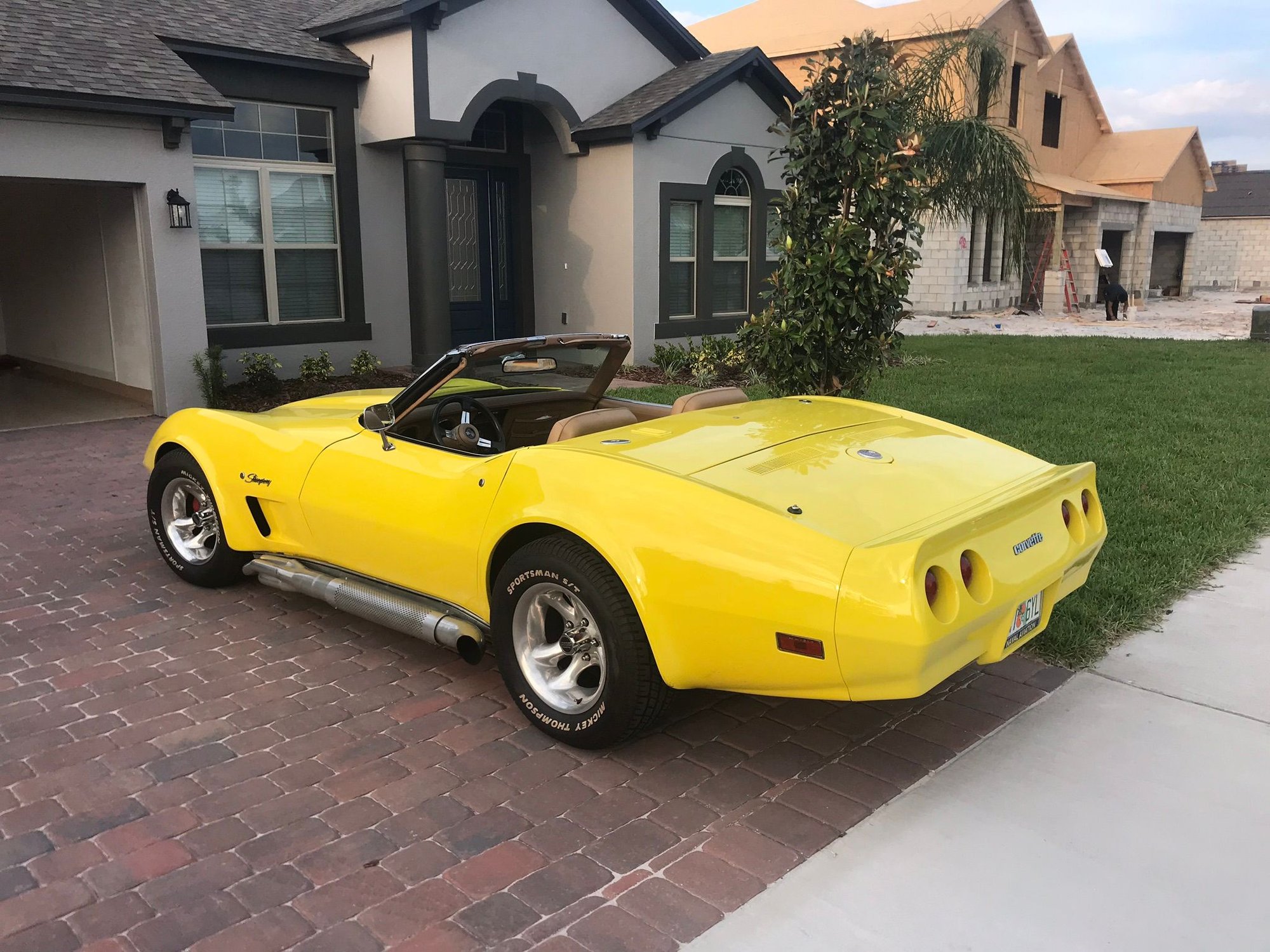

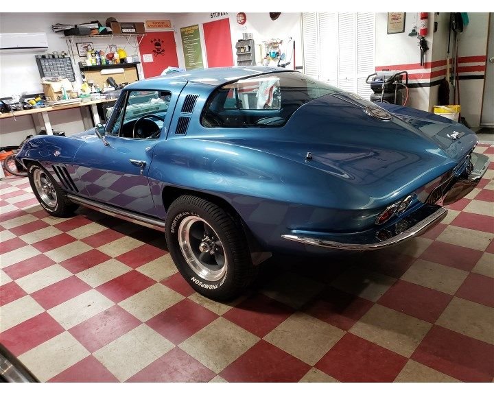

When I bought my current Corvette and was ready to install tires, I finally decided to break with BFG after 25 years. I still wanted the RWL look but I wouldn't go with anything Chinese or cheap quality like Kelly, etc. so I did much research and found the Mickey Thompson Sportsman ST to be the closest match to the BFG T/A in quality, production and price. Speed rating for the M/T is T (118 mph) as compared to the BFG T/A with an S speed rating (112 mph). The S rating is more than adequate for my driving so the T rating was a little more advantage. Reviews were excellent so I ordered a set. I've had them on my car now for over a year and a half with no sign of browning. They feel, wear and handle very comparable to the T/A's. So I am sticking with M/T until I find a reason to change.

I too have been running them for years on several different cars with no problems. In fact my current 72 has s set on them I bought 8 years ago that are perfectly white still and I only clean them maybe twice a year and they come perfectly white. I wasn't even aware there was an issue until I bought my 71 last month and of course I just purchased BFG's because I have never had an issue before. The very first thing I noticed with this set was the blue protective coating on the letters was damn near impossible to get off. finally after getting it off I noticed they didn't look white...so I scrubbed and scrubbed to no avail. Finally realized they were clean they are just brown. Got so disgusted I went and bought a white tire pen and painted them white. Pretty sad when you spend that kind of money have to paint your letters. Now I know and I will never purchase another set.

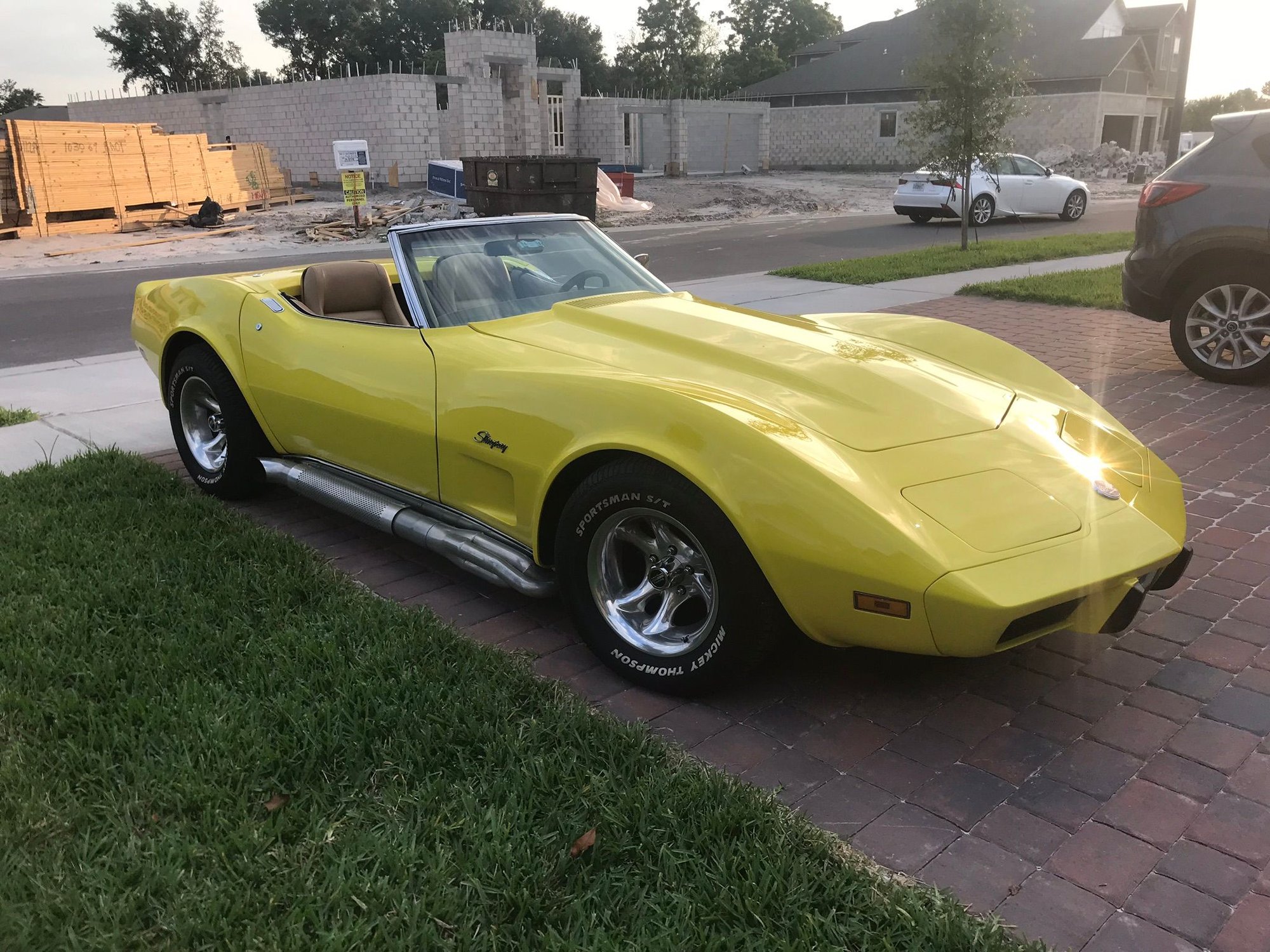

I have the Mickey Thompson on mine. Just as good as any of the 15" performance tires out there. I usually end up changing tires for age rather than wear these days. Considering paying for either the Avon CR6ZZ (very soft) or Kelsey tire Eagle GT reproductions next time around (assuming I don't go to 17" or 18" wheels). The MT letters do get a little dirty but a soft sanding block cleans them right up.
As a bonus, when my old mechanic installed these tires for me, he clocked them so the valve stem fallen between the Mickey and the Thompson on every wheel. Didn't even ask him to do it.

I put a set of the M/T Sportsman S/T on my 74. They are ok. I think I'd have been happier with the Cooper Cobra tire.
The side wall doesn't seem to be as stiff as the Cooper tires I had on my Z28.
I must say they do hook pretty good for a street tire.
I had an issue with the right rear tire. The sidewall blew out.
I'm confident there was no road hazzard damage, and the pressure was at 35 psi.
Just cruising home at 65mph. Not even being mean to the car.
Talked to summit racing and M/T. M/T was willing to pro rate 50 percent after they found out it was the outside sidewall that blew out.
Summit racing was useless. They wouldn't even call the guy at M/T.
Be a long time before I spend money at Summit again.
Rant off.
M/T Sportsman or Cooper's. But I think I would lean more towards the Cooper's.
Good luck
Jeff
