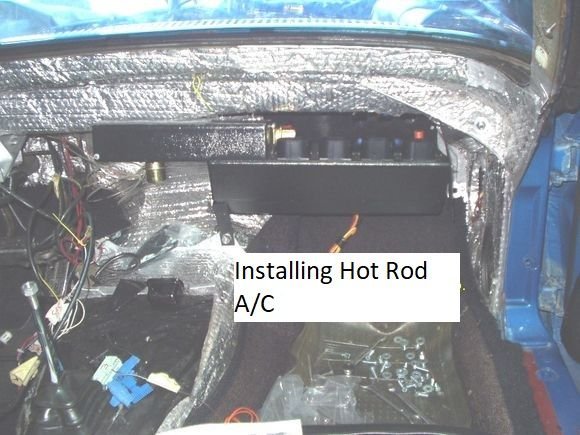

I got rid of all that dusty annoying jute-insulation in my 68. I replaced it with the generic stuff from lowe's and it's been fine....may not be the best but it's ok. If I was to do it again I might buy the brand-name silver stuff, but so far mine has been satisfactory (I suspect the brand name glue-on stuff is better though).
You can see what it looked like in this picture....I was installing Hot Rod a/c at that point.
https://www.corvetteforum.com/g/picture/6185113
What did you end up for doing a final cleaning of all the old jute? I've been using an oscillating multi tool with a scraper and that had been working great to remove the bulk but I want to sort of clean out the perminent old moldy smell
Also, how did you block off the firewall? I'm thinking to use an aluminum plate temporarily and glass it in down the road.

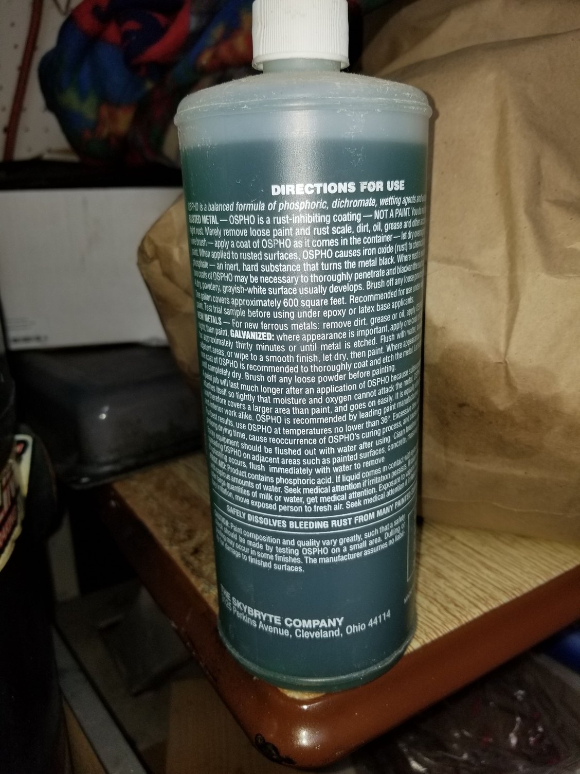

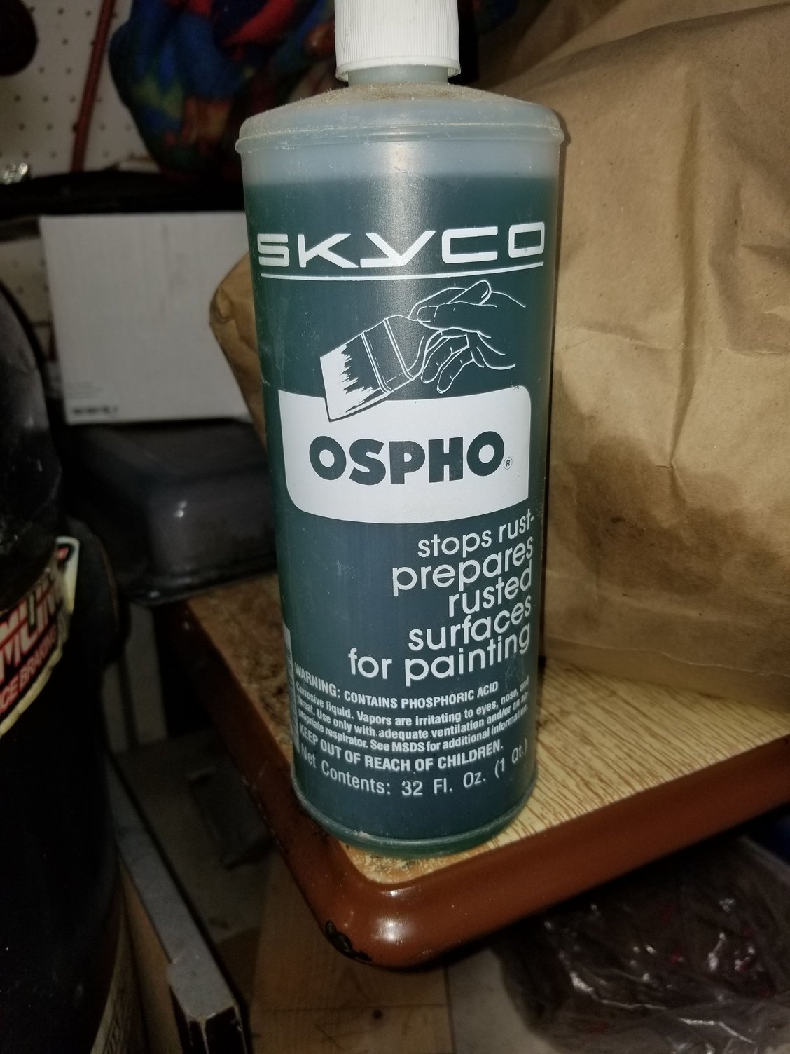

that frame looks great...I would find a metal prep rust sealer.. Not necessarily a paint. Theres an acid wash that seals the surface that converts metal and rust to a solid layer kind of like rifle bluing or a nitride type surface. Then a paint to seal it...good job!!!!
Thanks, I actually do have some rust converter stuff. Not sure if that would do it. I want to make sure it sticks good, do it once and right and hopefully it's good for another 53 years lol

the acid wash I was thinking of actually transforms the metal surface itself so its not a coating on top, its actually a conversion. ....I'll look and see if I can find that...give me a minute
Just updated my post with a pic of what I was talking about, something similar to that?

I used this on some stock 327 style valve covers last year and then painted them...They still look great with no new rust coming through

I was of the understanding that the phosphoric acid based treatments are used to turn rust into something inert? As you have cleaned all of the rust off there is nothing there to convert so I'm thinking a zinc based coating would be the go?

i believe once the surface has started to oxidize, its always there. Atleast all the metal I worked on as a kid ended up that way...LOL. What ever product you use that converrts that bare metal to something inert will be the best. You just dont want to lay something over it. THe phosphate bath that we used for treating rifle barrels has a couple of steps and the barrels were not rusty
