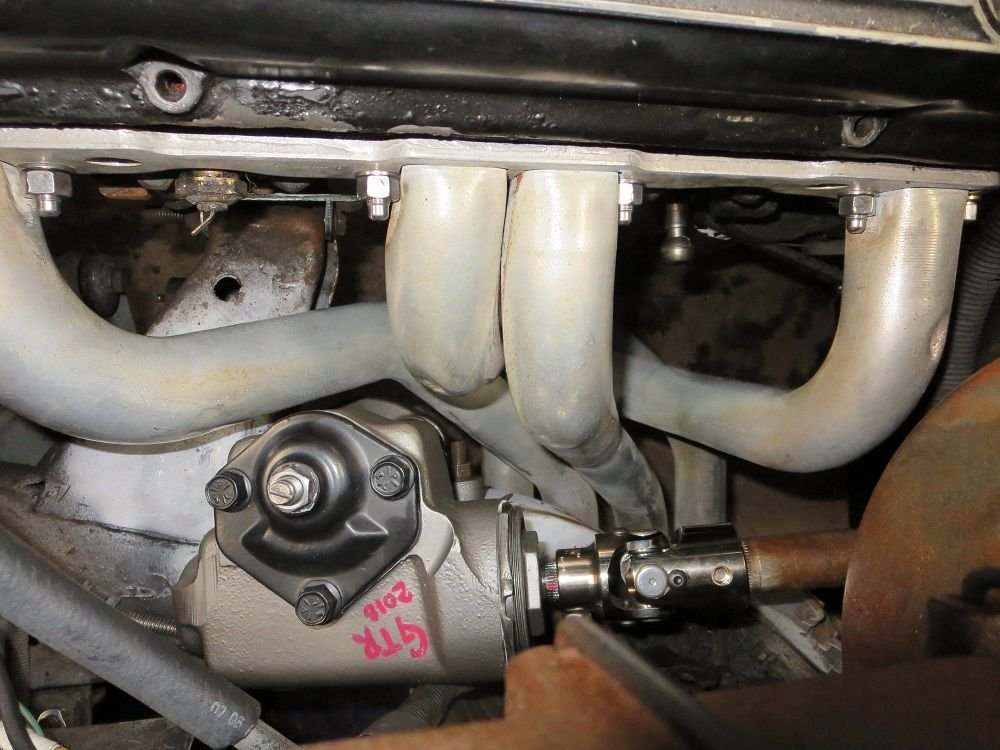

You can also use a Flaming River U-Joint for about $100-, which is what I have in my manual steering 80 behind my @GTR1999-rebuilt steering box, which uses the same internal parts. I bought a core with a nifty powder-coated cover, and GTR did his magic. Note the red paint on the splines to mark high-center, in the absence of a flat.
What's inside, though, hopefully the seller can tell you.

I'm pretty sure it's a Flaming River FR1713
https://www.flamingriver.com/index.php/products/c0005/s0004/FR1713
Read up on the rag joint before you make your choice. The rag joint can, for example, permit the steering box to move slightly relative to the steering column. OEM ones also have an internal ground pathway for the horn. The U-Joint is not a perfect replacement, just what I chose for my car.
