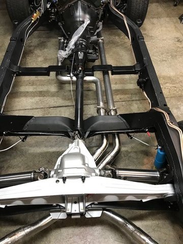

Yes, the transmission crossmember has a single dimple for the double-Y configuration exhaust. Fortunately, even the 4-speed cars came with a bolt-in crossmember, so it can be removed and modified, or replaced. I spent a lot of time trying to figure out how to solve this problem on my 80, then got side pipes instead.

I did run that same set of headers years ago on my first 81 and had no issues with them. The issue with trying to run a true dual exhaust with the 81-82 cars is that the drivers side floor pan hangs down much lower than the passenger side pan. This is caused by the floor pan being deeper due to the power seat option that was added for the 81-82 years. You can try to run the exhaust pipe under the drivers side pan but it will hang really low. The way I did it was to run the dual exhaust down the same way as the stock exhaust. There is enough room to run both pipes under the passengers side floor pan. I did change out the cross member to a G Force cross member. It was due to going to a 4L60E transmission so it gave me the option to run the drivers side pipe along that side but then turned it before it hit the drivers side floor pan and run it with the passenger side pipe. I am running ARH stainless full length headers. I think maybe a earlier bolt in cross member might work the same with the two exhaust pipe openings. Here is a picture how I ran mine.
