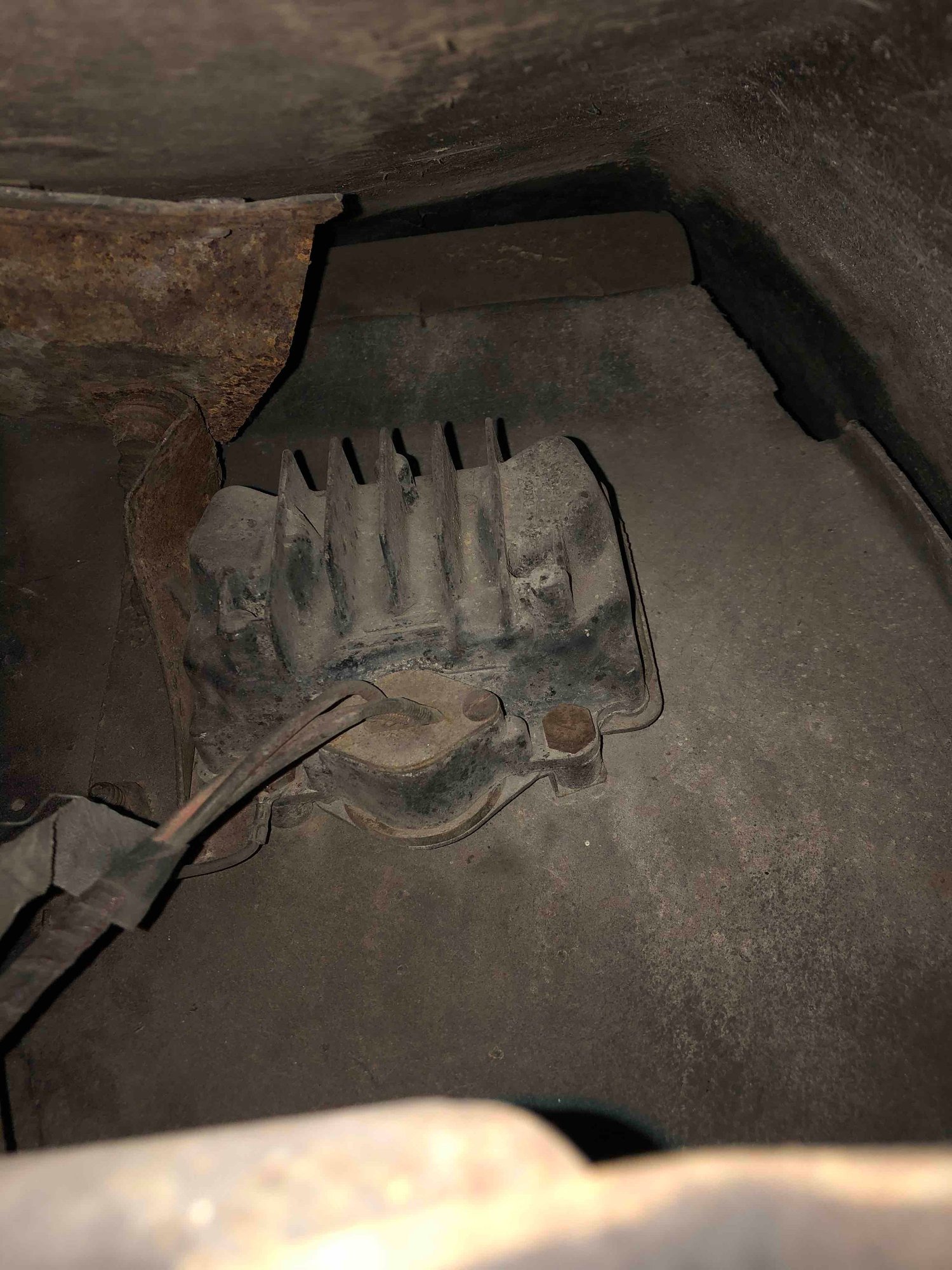

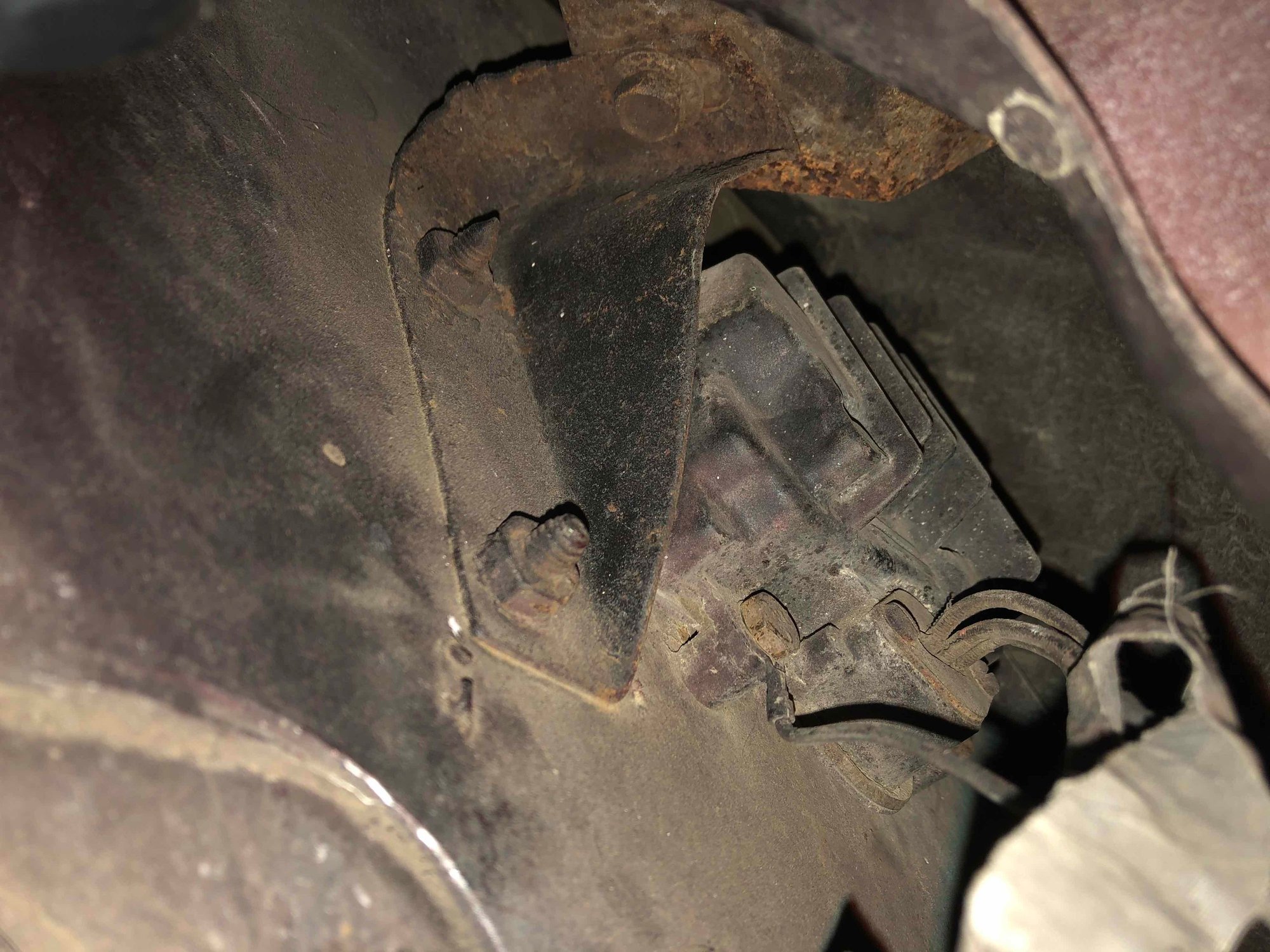

Going through my headlights and will to rebuild the mechanism w/ new bushings/etc. Front lamp harness was replaced by me circa 2011. Didn't know what this was, just left it disconnected. It's in the front driver's side fender, in FRONT of the wheel arch. connections are a "ground" and a plug that looks just like the turn signal for that side. There is no plug on the harness to plug into...
Thoughts? (Don't worry. What you think is rust, isn't. Corvettes don't rust....)

Amplifier for optional transistor ignition.

That is the TI amplifier. TI = Transistor Ignition
http://www.tispecialty.com/articles/article1.htm

If the car has that installed, it has (or had) the TI distributor, also. AND the wiring to the ignition system has the TI resistor wires needed for that system.
Don't know what ignition system you are using new, but the original TI parts and wiring need to be exchanged/altered/removed before some other type of ignition system is installed.
