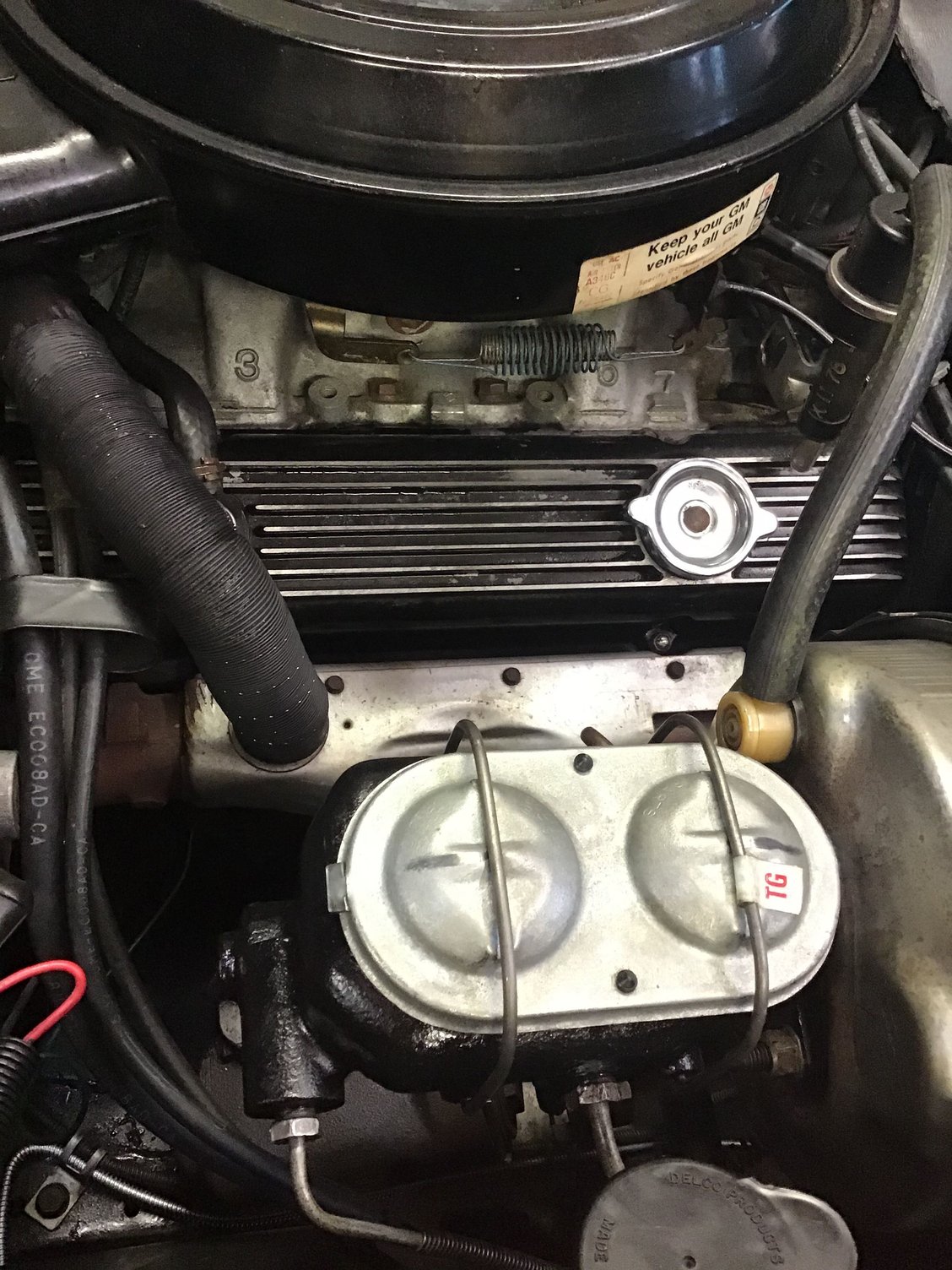

Is the exterior surface of an original master cylinder supposed to be "heavy rust"? No rust whatsoever in the interior and my brake fluid has stayed clear for 4+ years after I did a LOT of flushing.

According to the NCRS judging guide , in 79 the original master cylinder is painted semi flat black. The bails are natural finish steel.

Thanks for that info karol! I suspect that paint had no resistance to brake fluid which explains why mine and so many others I see in pictures here are covered in heavy surface rust.
However given the fact that heavy surface rust on cast iron is in fact a protective layer to prevent deep rusting I still wonder if that factory paint was intended to be nothing but a purely cosmetic and knowingly fugitive finish.

I've looked a many original M/Cs, low-mileage 78 types, and there still is a significant amount of finish. The heavy rust ones I've seen are service replacement...of course they've been driven as well.
In regards to technique, Karol passed along a tip to me when I was freshening up the engine compartment and that is to dab the paint on with the brush rather than stroke. It has a tendency to avoid brush marks...get the paint on than a "little dab will do ya!" Anyone remember that one?

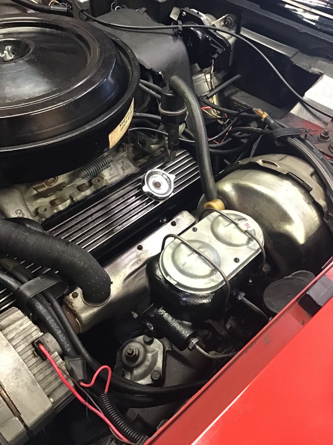

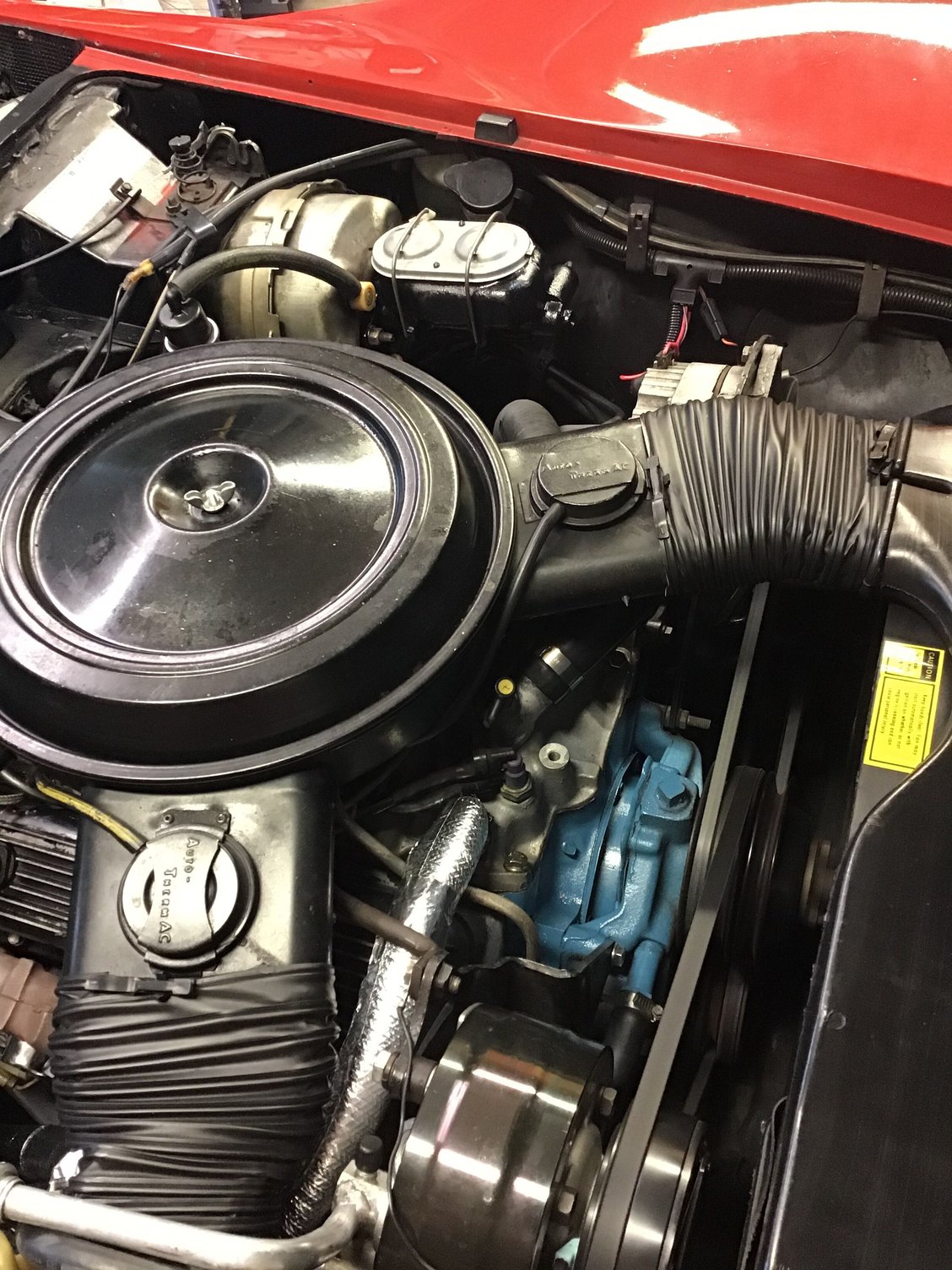

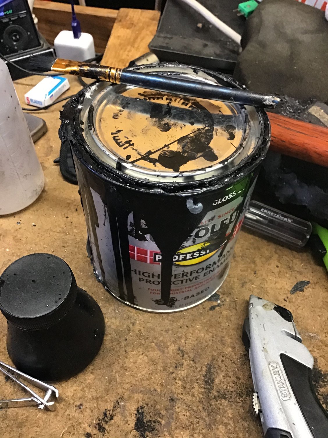

great this thread just killed an hour..painted master...
played with brush technique..couldn’t find epoxy...so...
also i touched up some blue and thought original owner spray bombed some silver on intake..i heard it was like that from factory! On an already aluminum intake? How cheap is that!
anyway should dry even lower gloss..
Experimental touch up valve cover dab
Oil based lowes industrial
