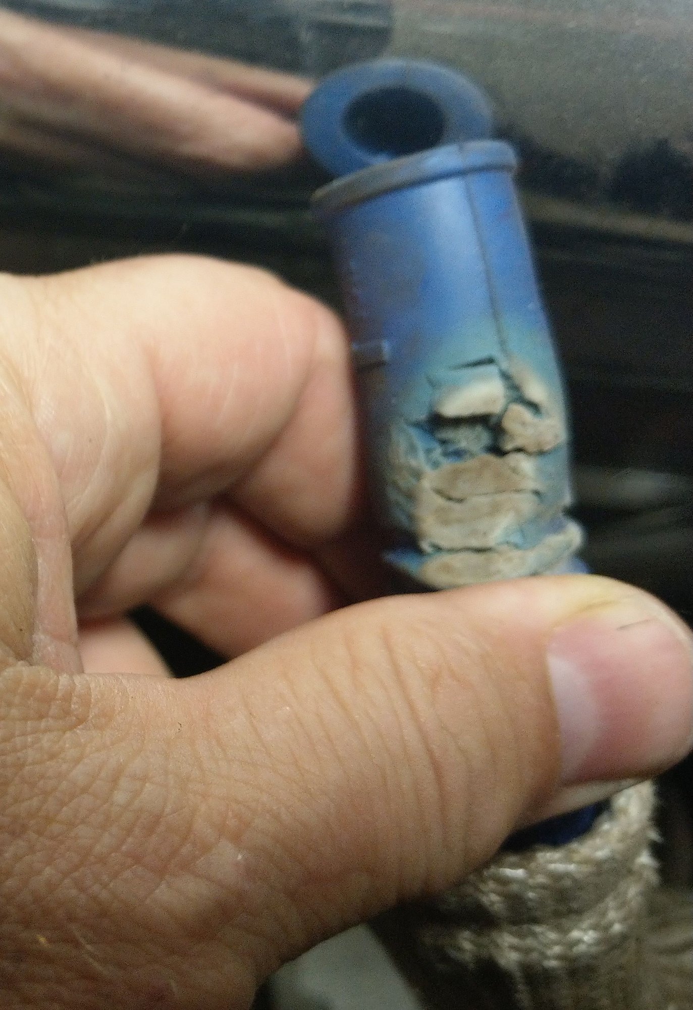

Last night I took off the spark plug wires on the drivers side and found one big problem.
Number three cylinder had the spark plug boot burned up. I have some of those protective spark plug boot/sleeves.
My guess is it slid off the end by the spark plug allowing the plug boot to get to close to the headers.
You get see the metal inside the wire through the burned up area so I am guessing it may have been arcing onto the header.
I hadn't started the car in a couple days but it also appeared that this spark plug was also damp from I assume fuel.

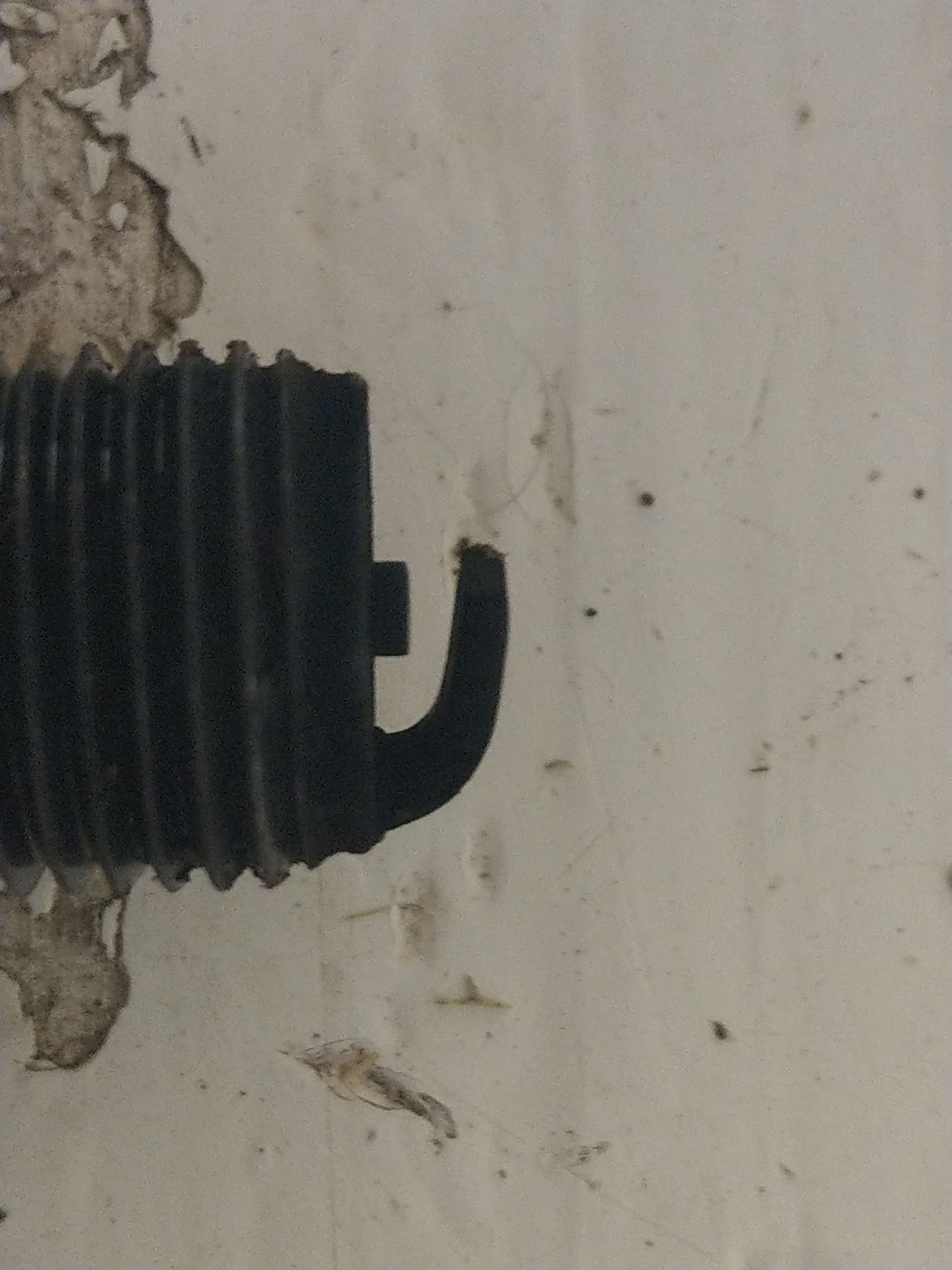

The second problem I may have with my AC delco r44xl spark plugs. For some reason, I have had the hardest time trying to figure out the gap for these plugs. Seems like it should be an easy thing to find on the internet. The best I could do, is Oreilly web site says they should be .033.
When I checked the 4 I had off, they were all significantly wider than this. Can anyone confirm that .033 is correct? They all looked about the same in gap but I am going to the store today to get a better plug gapper. All I had was the feeler gauge type where you have to combine them to check the gap. I can see one being a bit off but all 4 look to have been set that way. Is there any reason they would have been gapped larger than specs? I do have a petronix flame thrower coil and ignition system conversion but I know I didnt change the gap for that.
The plugs arms also look angled up. Here is an an example of one.
These plugs and wires are probably 5+ years old but probably have less than 100 miles on them. They do look a little black and sooty to me from running rich I believe. Most of these wipes right off.

Old Aug 5, 2020 | 09:34 AM
resdoggie's Avatar
resdoggie
Had a 1976 L-82, 4-sp
Joined: Mar 2011
Posts: 5,338
Likes: 1,213
Royal Canadian Navy
Time for new wires. I recommend Taylor 8 mm spiro pro wires. Set your plug gap at 0.035". Take the car for a good run on the highway and then check plug condition again.

On a side note. This seemed to have happened because the protective boots I have for my spark plug wires for the headers just loosely fit on the wires boots.
My guess is over time it just slid off between the header the the boot allowing the boot to get burned up.
I bought the protective boots back in the day. It looks like now they are cheaper and better deigned to stay snug on the spark plug boot.
Does anyone have a suggestion on ones they have used that will stay in place?
I found some on amazon for 15$ that seem, at least in the description, way better than what I currently have

I NEVER assume that a new plug is gapped correctly; I reset the gap to what I want on every plug I purchase. If you have points ignition, .035" is the proper gap. If you have HEI or another electronic ignition, .045" is appropriate. You might need something different if you have a very high compression engine or an exotic set up, but those are the 'usual' choices and they have worked for any Chevy engine that I've ever had.
Tiip for those trying to diagnose a firing miss: If you have a timing light, just connect it up to any specific plug wire and watch the pulses. You can easily determine which plugs/wires are giving you problems.
