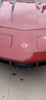

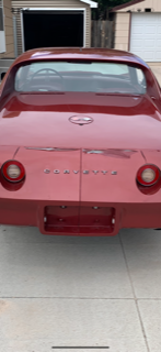

Hello everyone, I just recently got a 1974 C3. It's always been my dream to have a C3 and I can't wait to start working on it. The biggest issue with the exterior is the back bumper is cracked in two spots and the paint is flaking off. The front bumper isn't as bad but it also is cracking and has some paint damage. My plan is to replace both bumpers and my question is if there is a certain company you guys would recommend or certain material. From what I've researched so far I could get either fiberglass or polyurethane. For those of you who have done this yourselves how difficult is it? I have some experience with bodywork and have some friends who could help out as well but I don't have a lot of tools besides the basics. I am hoping to make this a winter project but I don't know if it would require a professional or not.
