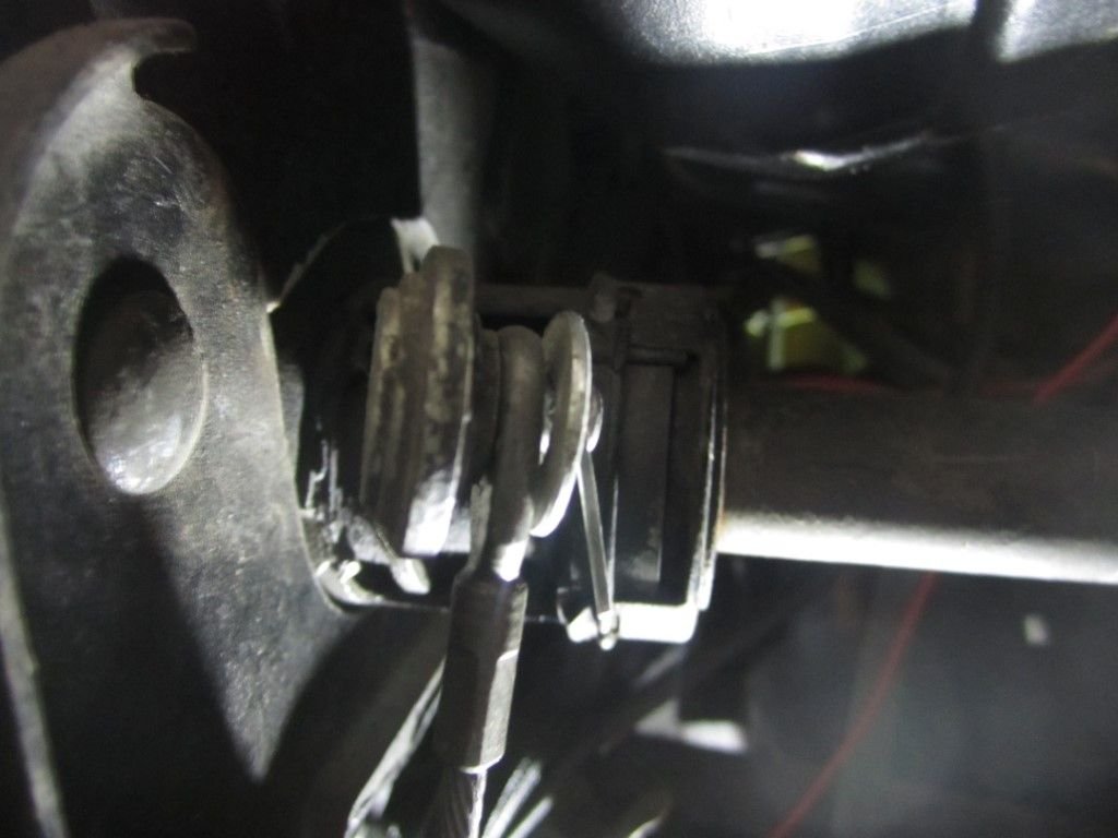

The firewall is designed for it to fit through.
Did you take the plate with the 2 bolts that go through the firewall off?

Oh, is it? It did not look big enough. OK. I'll take a swing at it after my meetings today.
I have the plate loose, but not completely removed. Probably why I couldn't see the firewall was large enough. Looking at the guides, it looked like this had to come off, but thanks for confirming it could stay.

There is a clip holding the cable onto the post & lever at the bottom of the steering column. And there is a bracket mounted to (and thru) the firewall which prevents that column from being pulled out. You remove the clip and the cable and push the cable to the side; remove the lower-right nut from that bracket (inside surface of firewall) and loosen the other bottom bolt (unthread but do not remove it): now from the outside, move lever/post so that the bracket can clear it when you pull it away from the firewall; now pull steering column backwards and pivot that bracket to provide clearance for column removal. Reverse process to reinstall.

There is no cable on it, currently. The arm is currently right over the bolt in the firewall bracket and won't budge either up or down (which way should it rotate?). I hit it with some PB and will try again in a bit.

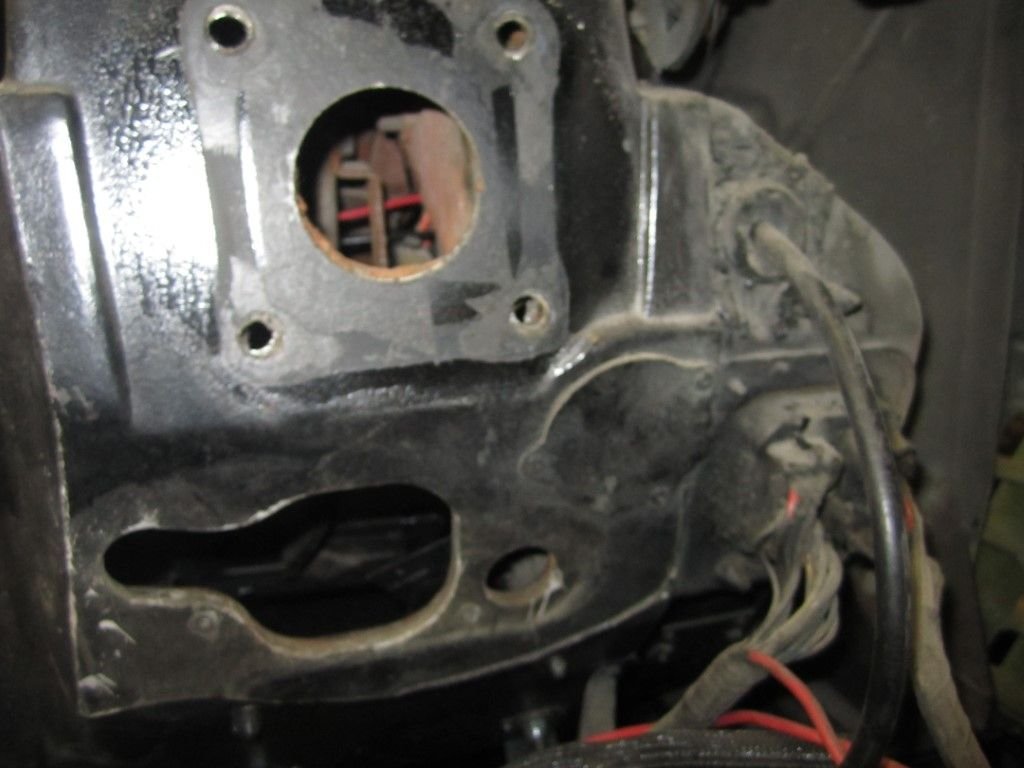

The bolt in the firewall should be a carriage bolt head so you only need to get at the nut on the insides.
here's the hole in the firewall (more or less) with the slot for the arm to go through

Here is the domed head of the carriage bolt behind the arm
If you do need to move the arm, it should go down from that position, not sure if the key would have to be in the run position to allow it maybe ???
