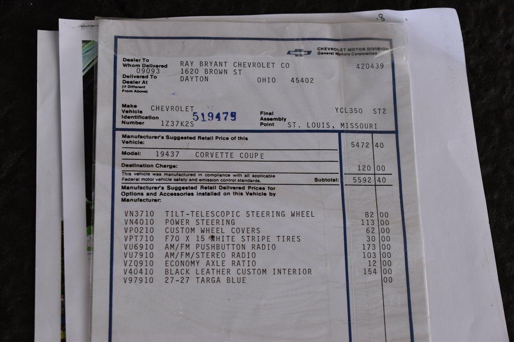

Hold on there before discounting this car... It's got the ultra-ultra-rare dual radio option!
Double double FAKE PAPERWORK recent repro.
