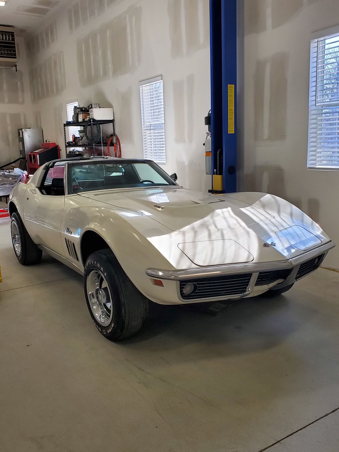

Wow, nice stash of toys and like mentioned above, I'm a little jealous of the garage itself! Welcome, congrats, and enjoy!

VERY nice option list, Red or blue interior would be the only change I would have ordered, can't wait to see it back in Cortez silver.
When having it painted if you have the paint samples approved /checked by NCRS paint judges it will help if you ever attempt to sell it, because if the metallic content is not correct it will kill the paint score.
OR you could have the paint store reduce the metallic content by 25-30% and just go with it. (this range is the percentage reduction which is settled upon whenever I have paint spray outs approved by the judges prior to painting a car for NCRS.)
