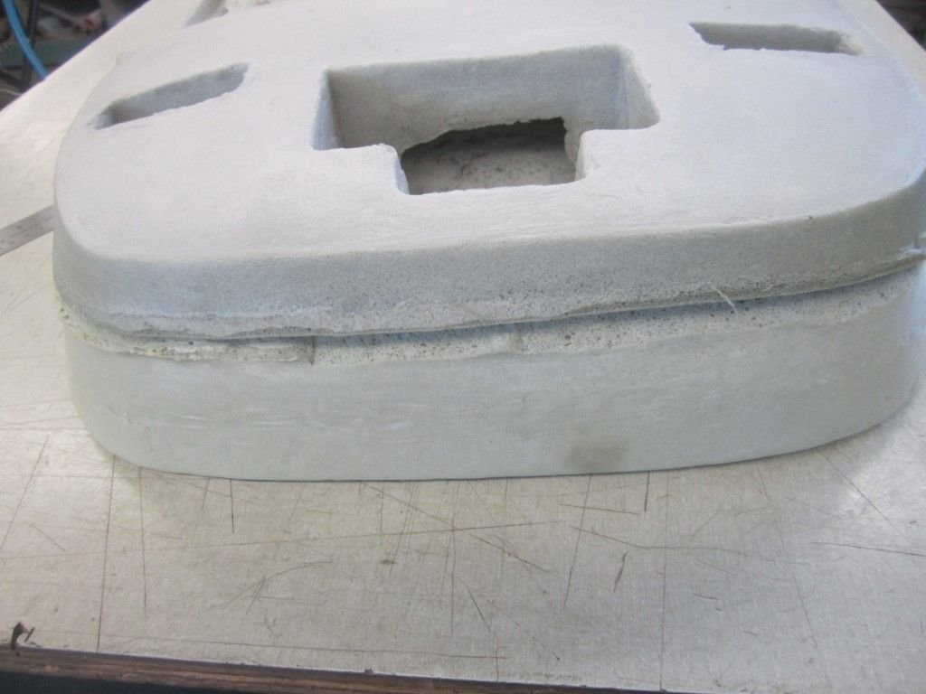

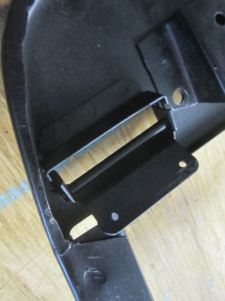

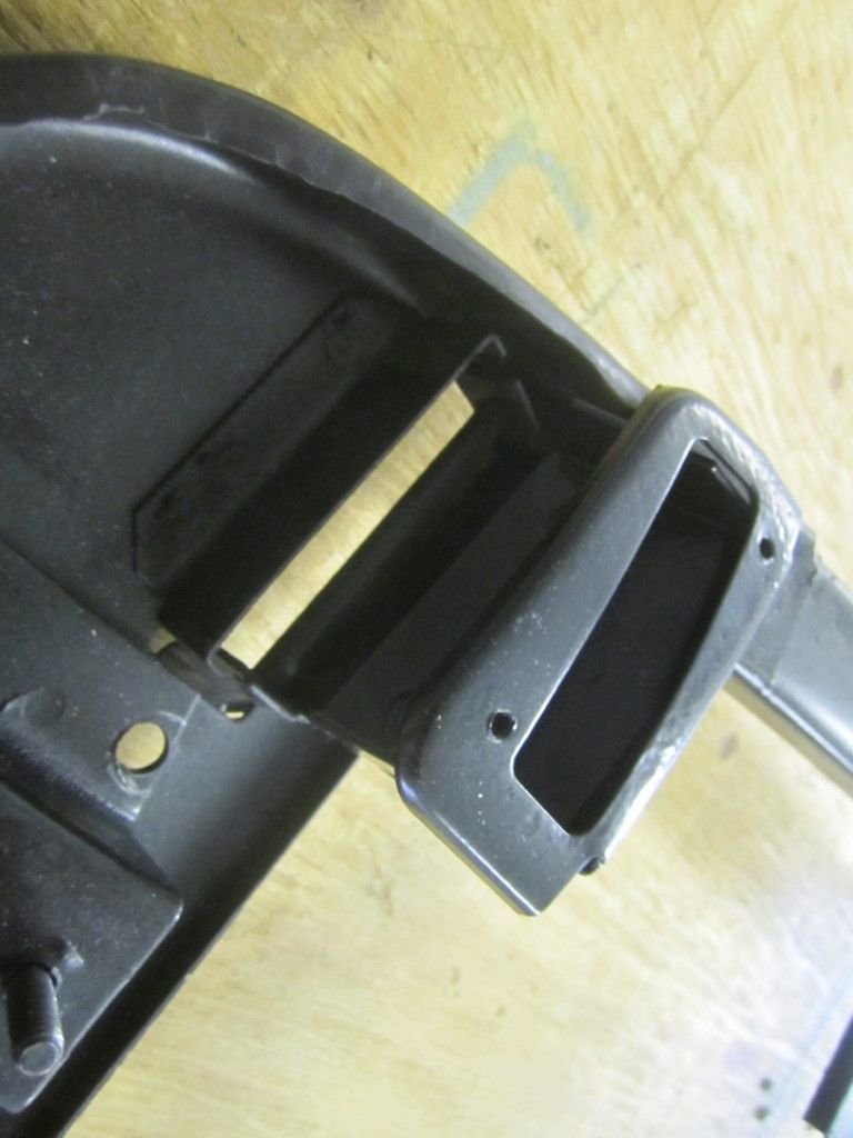

Here's what's inside the seat frame,
Both sides of the seat would have the inside opening ready for the rear-insert piece, the backs are interchangeable at this point
The insert piece bolts onto the seat (the inserts are left or right, not reversible)
So it looks like this for the passenger seat
When the rear foam is in place it's hard to feel if the holes are there, even when the insert is not. They would be in these cut-outs
The front insert (on my 72) has knock-out plugs for which-ever side it would go on, or both left in for verts
