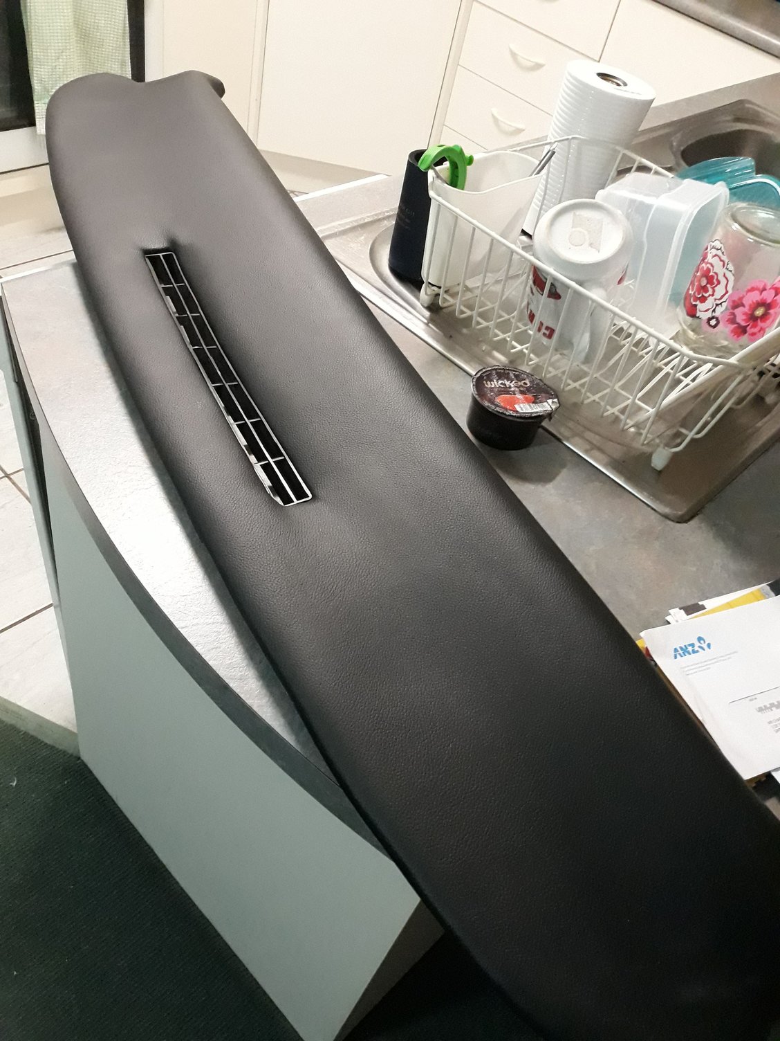

I recovered mine. Fraction of the cost and it still fits! Of course I don't have speakers in the dash so I covered over the speaker holes that were cracking.
Before.
After.
some thin (3/16th's) foam and then vinyl with matching grain. A bit of glue. Maybe 30 bucks all up. Fits like original.

I like that work. Anything special about the thin 3/16's foam you got?

I would use 1/8" closed cell foam. or landau foam.
