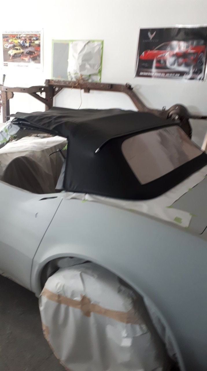

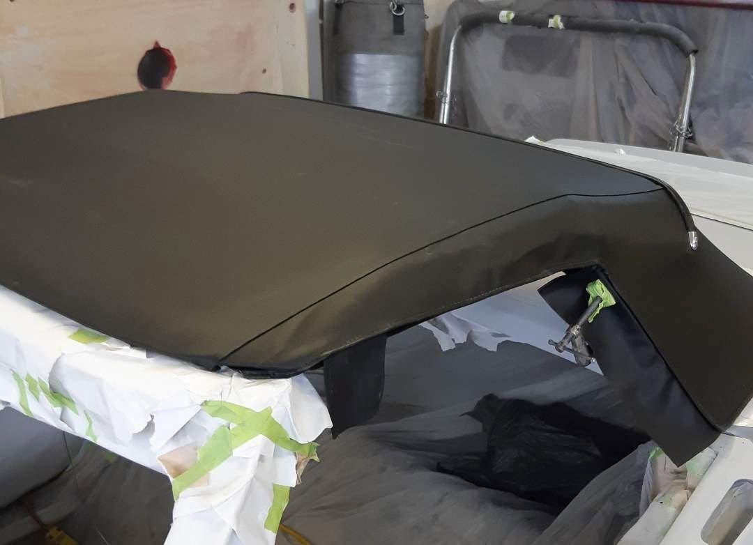

I purchased a new soft top for my 1970 back in Nov 2002, and it just got installed this year... so 18 years in a box. It all went well... no issues, no ripping and I think it came out very good. So you should go ahead and try it out.
