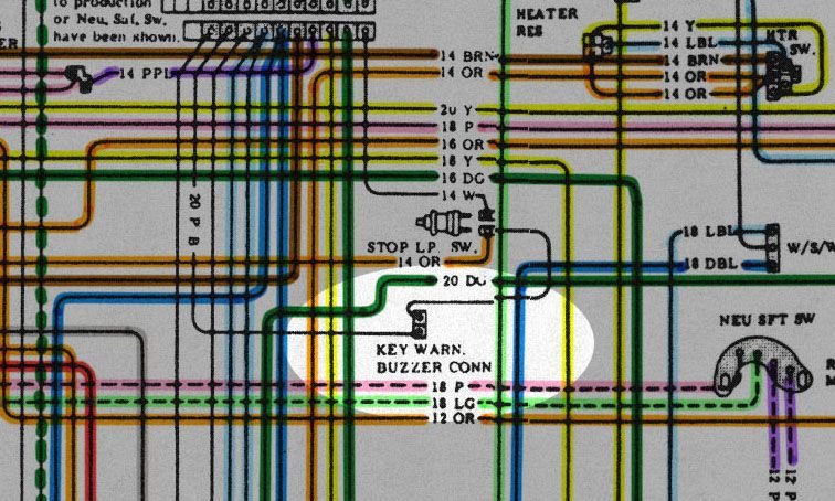

Still chasing this electrical gremlin after my radio install. I have everything working with the exception of the key buzzer. I moved some wires under the dash and it briefly sounded, so theres a loose connection somewhere. Before I go removing the driver side dash again,
I'm trying to trace out the wiring. My (1972) schematic shows a "key warn buzzer" connector between the stop light switch and the harmonica connector. Does anyone know where this physically located? What type of connector am I looking for?
Any info is appreciated. Damn electrical stumps me every time!

Thanks. I see the harmonica connector clipped to the steering column, but the wiring diagram shows another, smaller connector that I can't see under there.

IIRC it isn't a separate connector, I want to say it's the actual connector that goes to the buzzer
M
Thanks Mooser,
I was afraid of that. That means it’s up on top of the speedo/tach. Ugh!

Yup, waaaay up top and I really don't recall another connector
Maybe someone with a harness out on the floor can verify though.

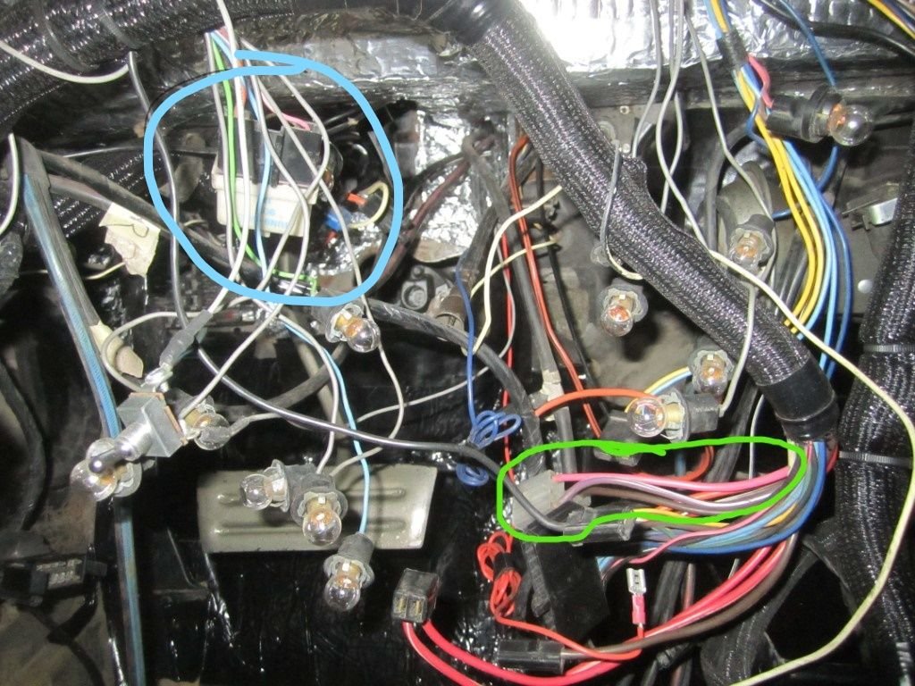

Okay, so all set to tackle the "silent key buzzer" issue this morning. I removed the 7 screws from he driver side dash pad, and with the slightest pull on the pad to remove it, the buzzer came back on. It is now working as it should. I promptly replaced the screws and buttoned everything in place.
I guess my question is, does this make me a "bubba"?
Should I have investigated further to find the cause of the issue.

Nope, just means that you might have to re-visit it again at a later date. No harm - no foul
