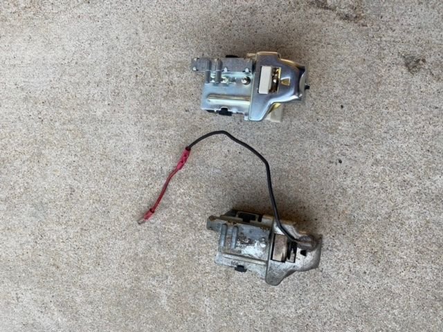

I pulled my headlight switch out of my ‘68 to swap it out because my dash light suddenyl stopped working and it has this extra wire soldered
to the back. Anyone have an idea why?

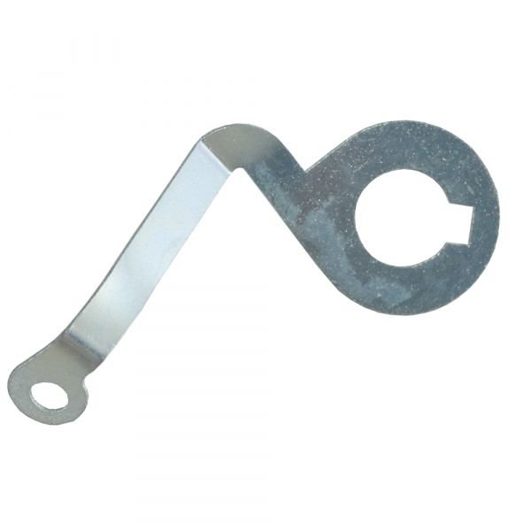

Bubba lost the ground strap- rather than spending a paltry $7 fixed it all by himself...
https://www.ecklerscorvette.com/corv...967-57763.html

My car had the factory ground so I wonder why the Bubba ground. I swapped the headlight switch and my interior lights still do not work even though they did before. Coukd this have something to do with the ground? Maybe the previous owner did the bubba ground because the factory one was mot working AND if so maybe my lights stopped working because the Bubba ground came off. Could this be correct?

The factory ground goes over to the gauge housing, I wonder if the gauge ground is missing and they added this ground rather than actually correcting it?

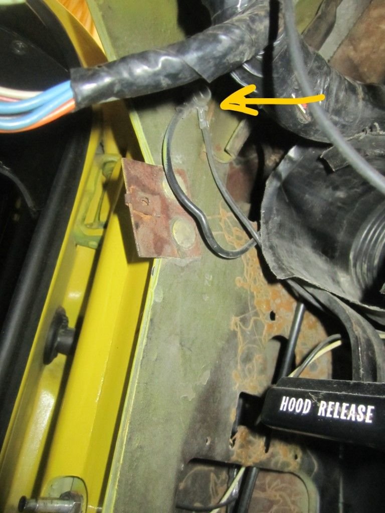

The ground strap for the headlamp switch is ground coming from the speedo housing. The ground going to the speedo housing is a black wire attached to the front door pilar metal. If you don't have that wire, there will be no interior lights.

Here is the ground he's talking about but if you've already run a wire from negative to the bracket and still have no interior lights then it's not that ground causing the issue
When you say no lights, none? no kick panel lights or rear compartment lights when opening the doors? or no tach and speedo lights or just the gauges in the center console, what about the shifter console, prndl / heater control or cigarette lighter lights?
