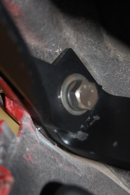

I've read several old threads and looked at pictures concerning the outer bracket extensions that the front bumper attaches to in the corners of the bumper. On the 71 there isn't a difference between the left and right bracket. My question is this, there is a vertical slotted hole on one part of the bracket and a horizontal slotted hole on the other end. Which hole bolts to the bumper the vertical or horizontal?
Thank you

Old Oct 30, 2020 | 10:40 PM
Radman2112's Avatar
Radman2112
Joined: Jun 2018
Posts: 608
Likes: 64
From: Lake Villa,IL
I dont know if these will help, but they are the best I have off of my '71.
Old Oct 31, 2020 | 11:20 AM
AutoFast's Avatar
AutoFast
Posts: 256
Thank you all. Any additional pics are helpful. It is looking like the slot is horizontal against the bracket from the frame based on Radman2112 Pic.
​​​​​​You've all been helpful, thank you!

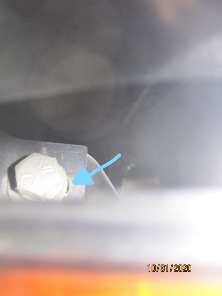

Old Oct 31, 2020 | 12:05 PM
Mooser's Avatar
Mooser
Joined: Apr 2011
Posts: 11,183
Likes: 3,335
By the looks of my AIM, the vertical slot is against the bumper. I'm going to the garage in a few minutes and I'll see if I can take some pictures

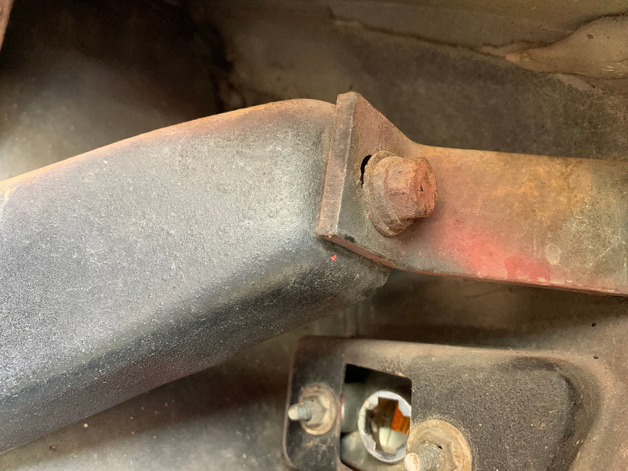

Old Oct 31, 2020 | 01:08 PM
Mooser's Avatar
Mooser
Joined: Apr 2011
Posts: 11,183
Likes: 3,335
Well this may or may not help
Like the image I posted above, my twisted brackets are inside the U shaped ones so you can't see anything, but I can just barely make out a little of the horizontal slot peeking out behind the washer on the part that goes to the frame extension so the vertical one must be on the bumper end

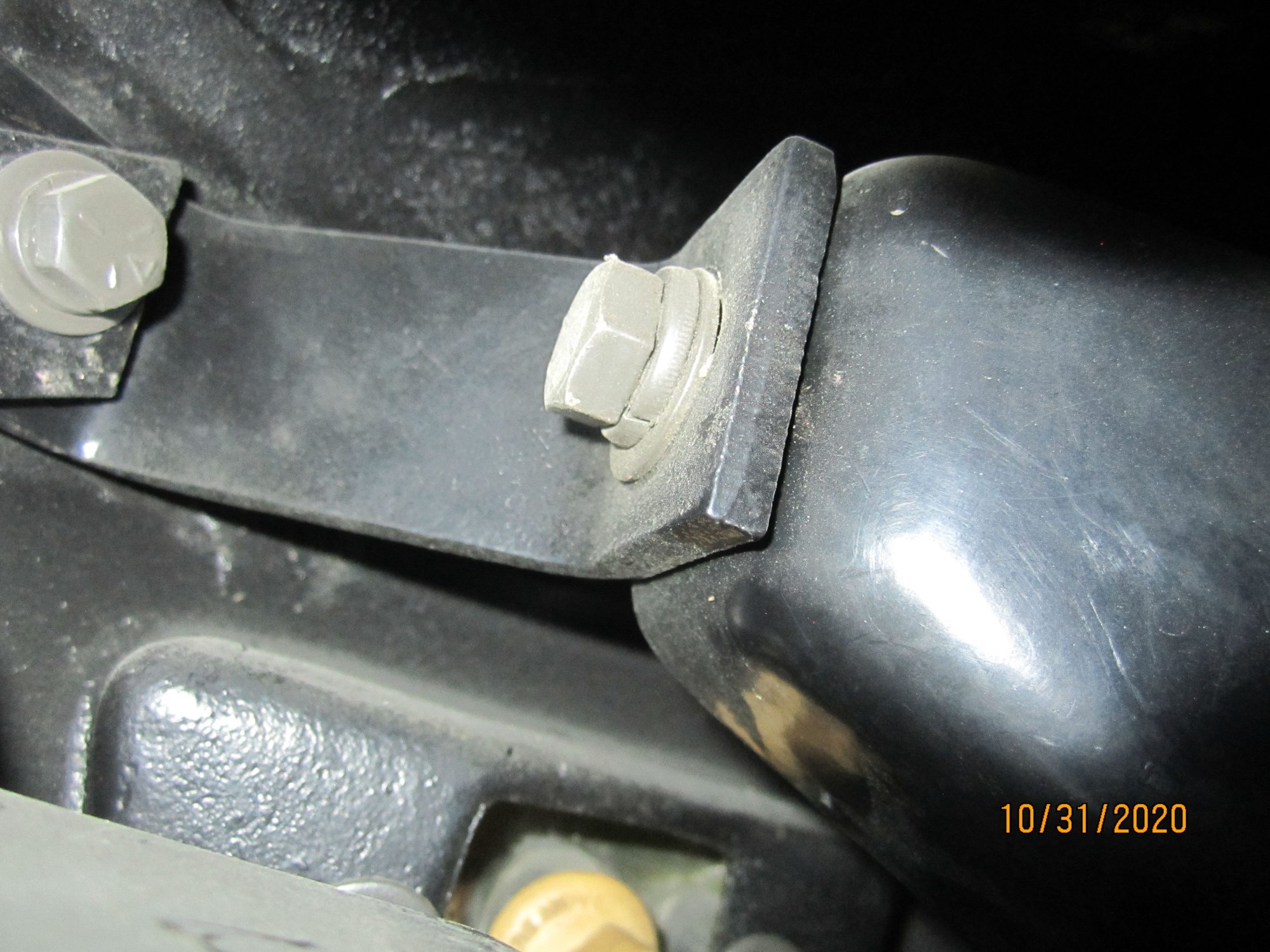

Old Oct 31, 2020 | 04:40 PM
Mooser's Avatar
Mooser
Joined: Apr 2011
Posts: 11,183
Likes: 3,335
Best I can do, horizontal on the frame, vertical on the bumper but hidden behind the twisted bracket and can't see from the front side

Old Oct 31, 2020 | 05:18 PM
AutoFast's Avatar
AutoFast
Posts: 256
That's works for me thanks! You also helped confirm the bracket goes behind the twisted bracket
Old Oct 31, 2020 | 07:11 PM
Mooser's Avatar
Mooser
Joined: Apr 2011
Posts: 11,183
Likes: 3,335
You can see the gap on Radman2112 (nice rush reference there) first image as well
