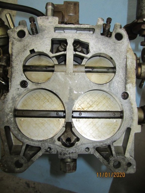

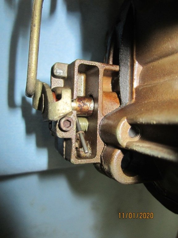

Lets put it up here for future searches, maybe help someone at some point,
Here's what I see as someone who is just a hack
A couple of the flat screw heads I believe I can see where the screwdriver marked the sides of the slots. Also would think the gaskets wouldn't hang out that far in a stock setup and the rubber hose on the choke pull-off seem long
(Sad part is I believe this is still in better shape than what mine was when I started)
OK Lars, what are all the real warning signs without opening it up, hell maybe we can open it up a step or two and show everyone what to look for / at
M

Old Nov 2, 2020 | 11:25 AM
lars's Avatar
lars
Joined: Aug 1999
Posts: 14,376
Likes: 6,375
That's a very nice, original, unmolested carb in great rebuildable condition. Somebody has been into the carb before, but you're not going to find a used 50 year old carb that hasn't been opened up at some point in its life, so you're probably going to find some minor assembly or setup irregularities. The over-hanging gaskets are correct - that's how these carbs were built.
Some things I look at are:
  • All the hardware is correct, and has the correct plating. Airhorn screws are slotted head screws with black phosphate coating - not phillips or torx screws with silver zinc.
  • The airhorn and the float bowl have not been sandblasted - they have their original brown-ish chromate conversion coating, and it's not in bad shape.
  • There is no "blockoff T" jammed down into the bowl vent at the rear edge of the choke tower - commercial carb builders jam a Rochester 2GC accel pump checkball retaining "T" into that hole to prevent idiots from pushing their air cleaner stud through the float.
  • Colors and plating on the steel parts are correct: The secondary airvalves and the choke plate are plain silver cad - not yellow dichromate. Same on the throttle linkages. There is some minor degradation in the plating from corrosion, but it's original and insignificant. Commercial builders will either sandblast and strip the silver cad (leaving a bare steel surface that is usually severely rusted) or they will zinc plate the parts with a yellow dichromate dip, making the parts bright gold. Carbs with gold colored airvalves and chokes have been hacked.
  • Fuel inlet threads are in outstanding condition. Many commercial builders will install a steel thread insert in the bowl whether it needs it or not. This carb is in great condition.
  • The throttle lever is the correct big block throttle lever with the lower part of the lever removed by the factory. Hacked big block carbs often use small block throttle plates (with the small block throttle lever). Further verification of this carb having the correct throttle plate is the size of the idle air bypass holes in the primary throttle bores - only the big block carbs had idle holes this big - the small block carbs have smaller holes. Good indication that this carb is correct and unmolested.
  • All the choke, fast idle, and choke pulloff parts are correct for the model and year. To determine this, you need to have a good photo reference "library" of carbs. Commercial builders, and many backyard mechanics, will alter the choke system, delete parts, or install choke systems from other years and models. This carb has all the correct parts installed.
  • The long hose on the choke pulloff is correct, as is the rare "T" vacuum fitting that the hose is connected to. The only thing incorrect is that the hose should be connected on the cross portion of the "T" and not on the straight leg inlet. This "T" fitting is usually cracked or damaged on these carbs (the solder joint in the "T" location is very fragile), so most builders will replace it with a straight fitting. The fact that it's intact indicates the carb has not been treated too harshly. It still has the correct, original choke pulloff with the nipple pointing outwards - these are no longer available, and the replacement pulloffs have the nipple pointing inward. If the pulloff is functional and not leaking, just clean it up and use it - don't discard it or replace it.
  • The choke shaft and throttle shafts still have indication of the green coating originally installed. Good indication of an original carb that has not gone through a commercial stripping operation.
  • The 2 rear (long) airhorn screws are not grossly recessed into the airhorn casting, indicating that they have not been over-torqued to distort and bent the casting. The carb is not warped, and the secondary airvalves are not jamming against the casting.
  • The primary well plugs are unaltered, and nobody has smeared any crap-*** epoxy all over the plugs. Good indication that hacks have not trashed the carb.
Overall, you got yourself a winner - very nice rebuildable carb!
Lars
