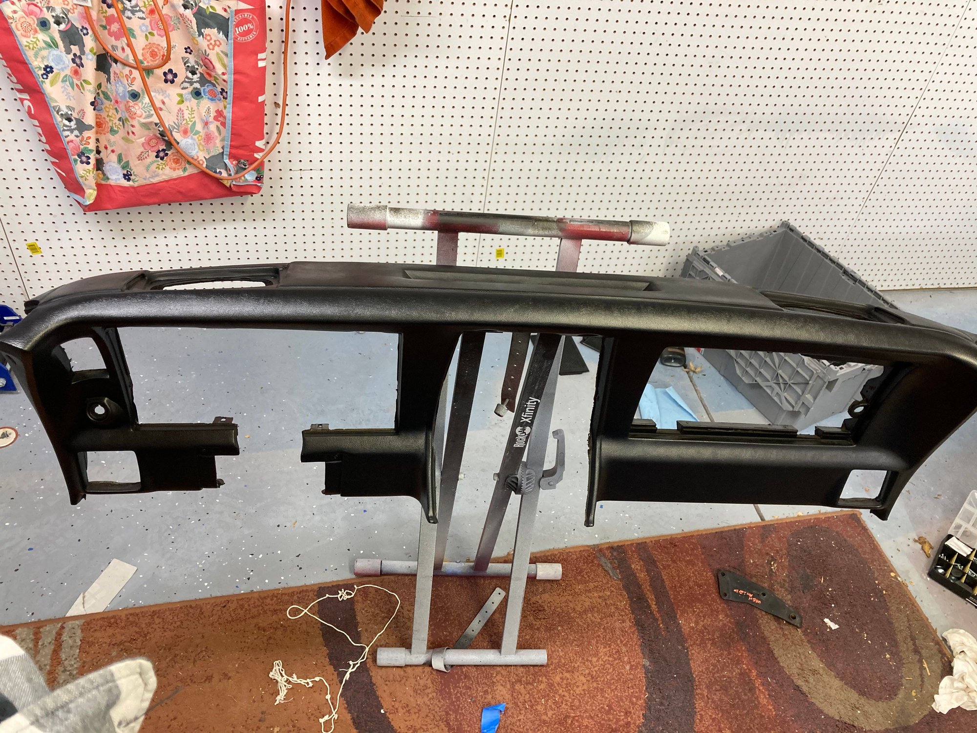

Hey guys, I have my corvette in parts installing a new heater core. I also have a “new” used dash that isn’t cracked! Upgrades! anyways the top seems to be brown opposed to black, anyone used interior paint on there dash before? Any luck? Any issues? It’s covered in cleaner so I’m slightly worried about the paint sticking but that’s all! Thanks!

ended up cleaning the pad with dish soap (degreaser) and using a grey scotch bright. Used dupi-color, I know it wasn’t the suggested paint but I want the dash back in tomorrow and dupi-color was the only locally available dye. I am happy with how it came out.
